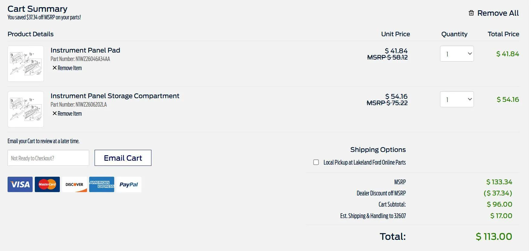

Planning on swapping the leather trim out for the xlt trim on the truck. I looked and theres seperate part numbers on both
That's it, and same as what i paid through Tasca. Complete assembly as shown in the pictures I posted when it arrived
What was your shipp on the one part? They want $71 to ship the 2 dash pieces we have been talking about.

I just tried another parts site even more expensive.

Apparently it is that separate XLT trim piece that jacks up the shipping for some stupid reason. Just the glove box is $13. Can’t imagine why a smaller part jacks the price so much. Going to call one of them M
Perhaps it's not your home address, or if it is, you don't care. It's visible in the price snip you shared. Shipping from Lakeland Ford is only $17 and prices don't look bad.
https://parts.lakelandford.com/
thank you.

Okay back to guinea pig status. I ordered both the glovebox and XLT trim piece from Lakeland Ford $117 for both parts including tax and shipping.
Probably going to see if my kid can help, he is a master body tech. I’ll keep you posted.
