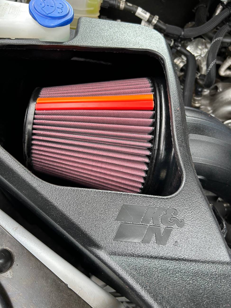

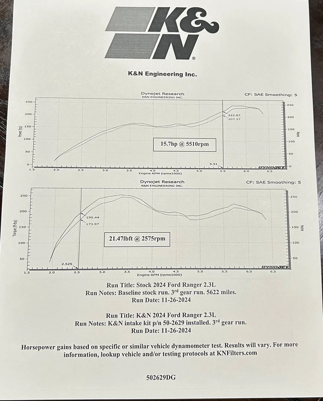

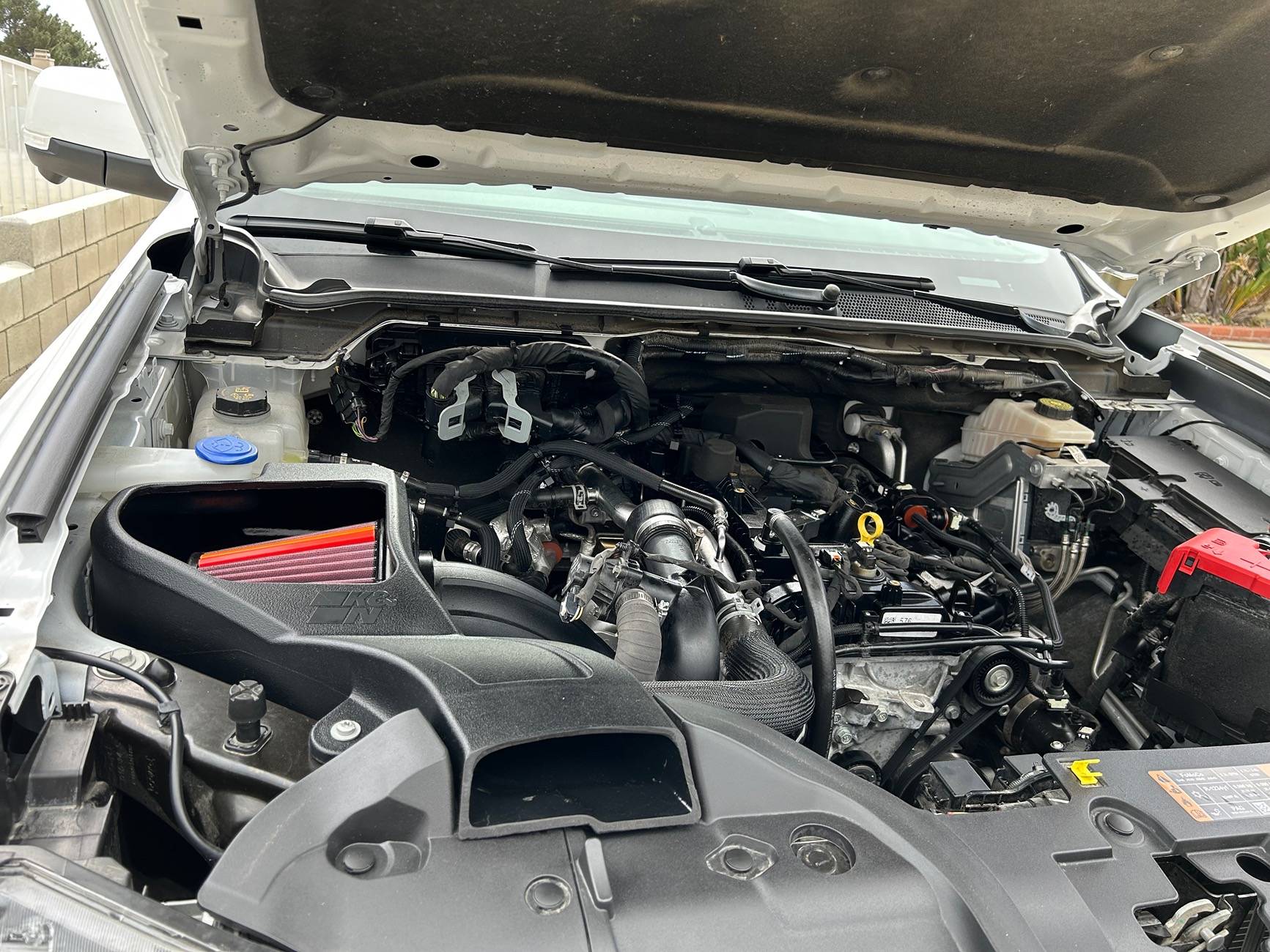

K&N used my 2024 Ranger Lariat FX-4 to prototype their intake system for the newest generation of Rangers. Finally got the production version, it makes the turbo more audible and the whoosh whoosh is nice. I was surprised that the get up and go was very noticeable. Picked up about 15 HP and 21 lbs torque
Oh. I have the 2.3 engine.

This K&N intake is running a dry filter as per the op with a specific Dyno chart.🇺🇸

I'm not hating on it. To each their own. It looks good. It will sound good, perhaps at the expense of intaking hot engine bay air when the hood is shut, it appears, unless there is sealing around the large opening I couldn't see. I would think the dyno run was done with the hood open. I'm not sure how well the inlet above the front grill receives ram/ambient air while at highway speeds, however; so, that may offset it while in motion. 🤷‍♂️ I see the advantage/desire for racing applications, hearing the turbo compressor, or for looks. 😉
I wish there were an aftermarket setup that was similar with a better filter element. I've used K&N in the past. From my experience, I wouldn't deem it worthwhile. If anyone wants to research air filtration, add ISO 5011 to your internet search query.
Just chiming in on the conversation, don't mind me. If you want it, get it. 👍

Dyno "Numbers" mean nothing - especially from someone who will profit from those numbers.
Dynamometer readings are an indicator of added or reduced hp beyond an OEM setup. These numbers change based upon altitude, ambient conditions, dynamometer utilized and SAE correction factors.
However, there is no conspiracy theroy connected to dynamometer readings. They can’t be adjusted up or down to suit the operator/owner. Instead, they demonstrate real world application for crank and wheel horsepower.
This particular intake is well designed; uses a larger diameter air intake tube and venture, along with a larger, better designed air box. Thus it provides greater CFM flow and larger air intake capacity. Top is sealed by the hood and fire suppression, blanket. Only limiting factor is the air intake funnel.
This can be overcome by the addition of a Velossa Tech Ram Air Intake.🇺🇸
