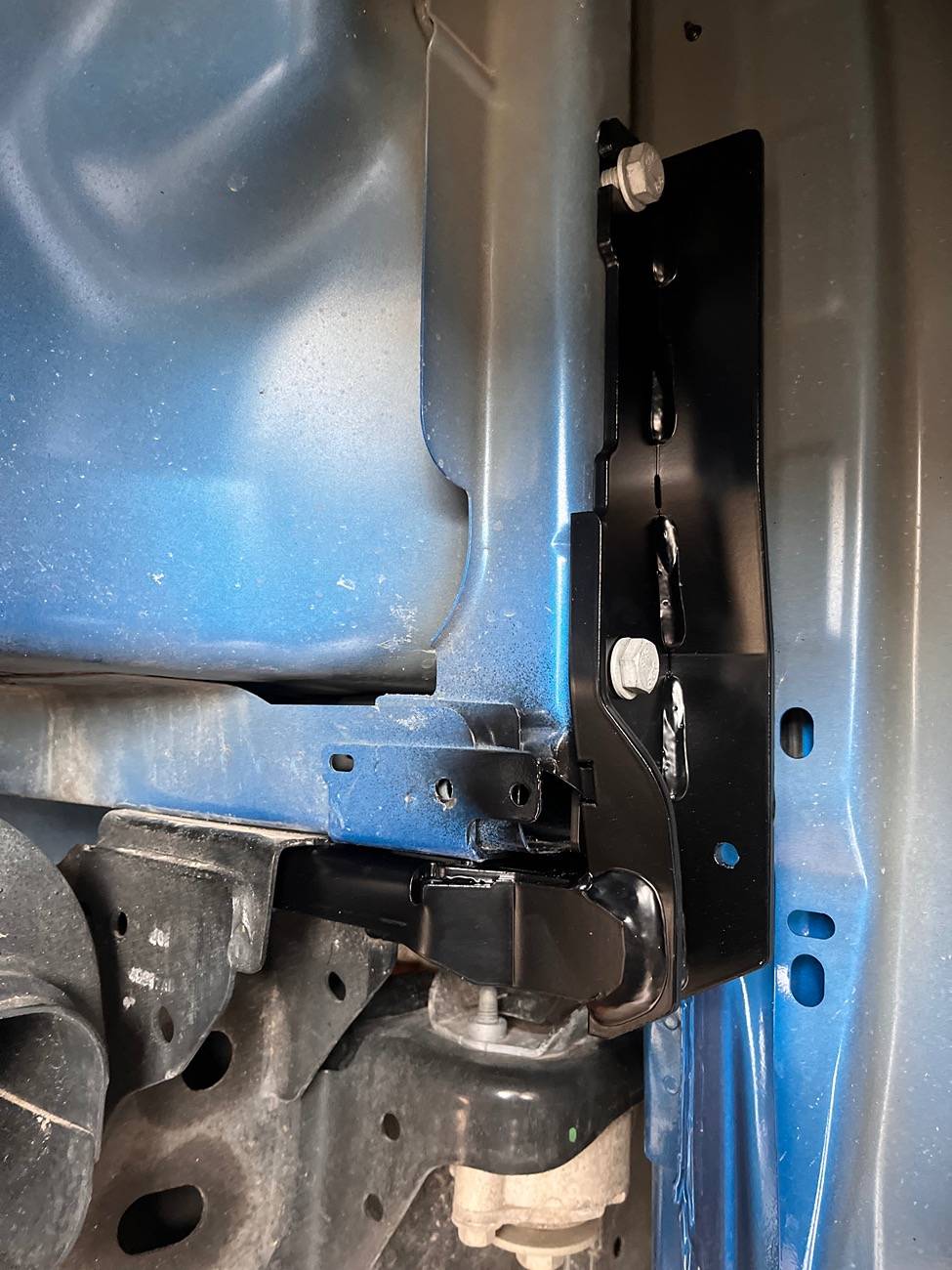

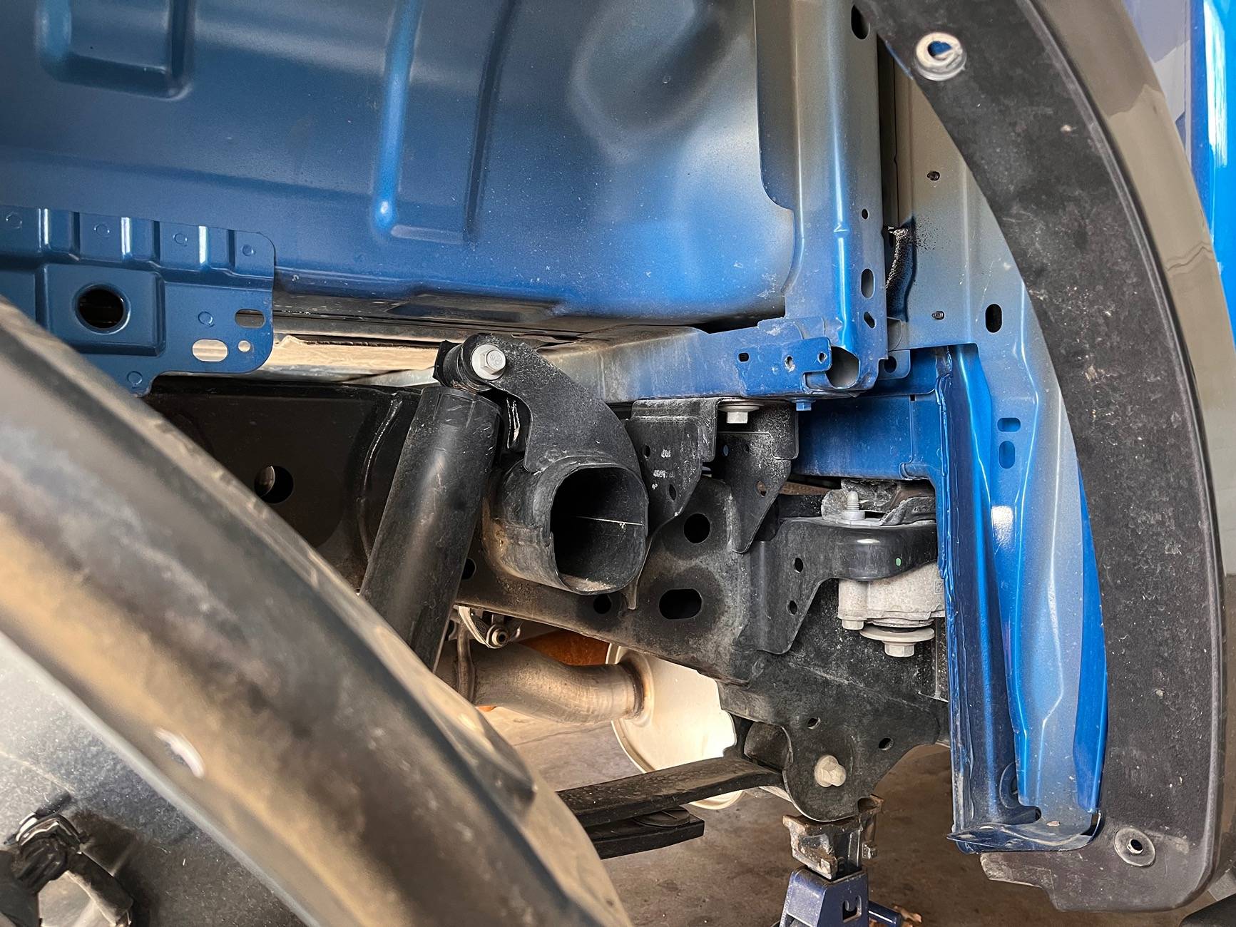

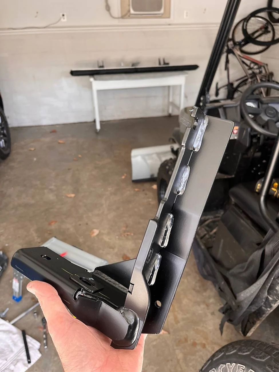

so got an email that the ford ones were in stock- hit the order button. two days later- on my door step. yup, definitely not in the same league as the egr ones. these are more like frame extensions.
install was actually not bad. hardest part was getting the damn fender liner out of my way.
drilling the rivits was easy. (sharp bits)
my rivet gun wasn’t big enough for the new ones so said screw it and popped the extra screvits in there.
i’ll do driver side this weekend.
overall- was bad at all.
