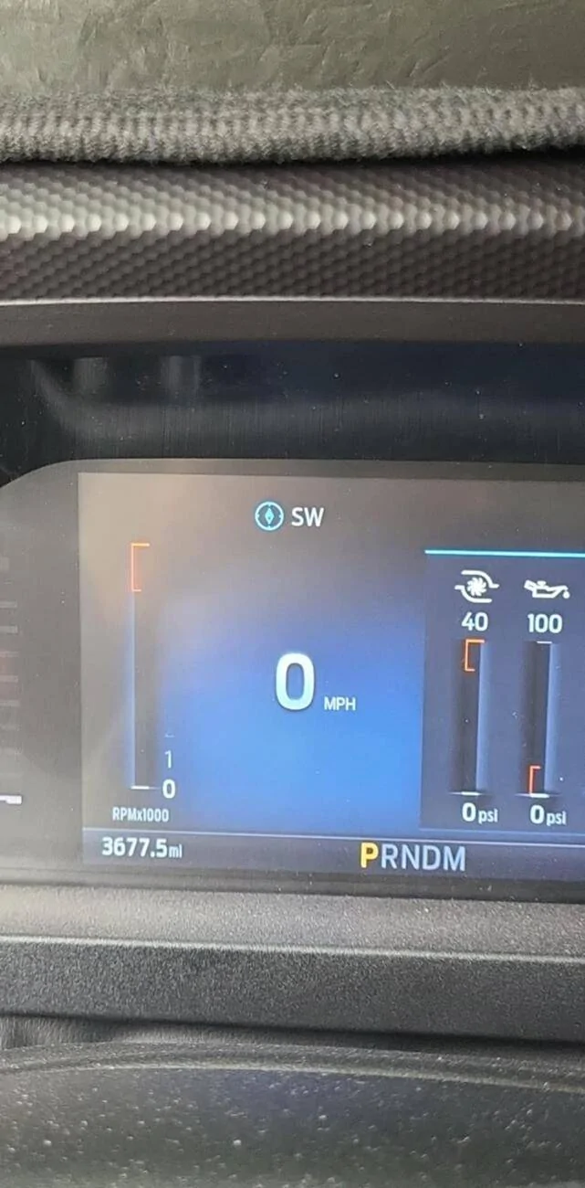

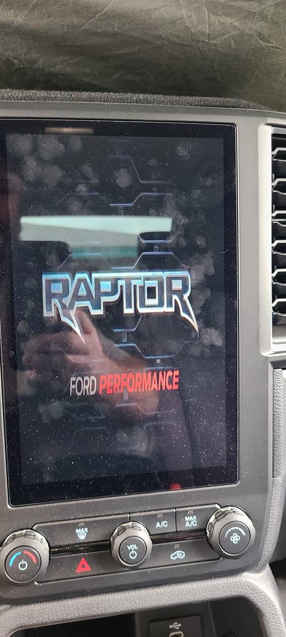

So the line that says disable auto start/stop nag isnt just the screen turn off? It turns off auto start?
415
247
Aircraft examiner
Yup, just took the a off thr screen. Still shuts off at lights, oh well.
But, i did acrivate the compass on the xl 8" cluster, snd it works while driving and matches what direction my phone says. I also checked all the splash screens settings and only the raptor one works.
