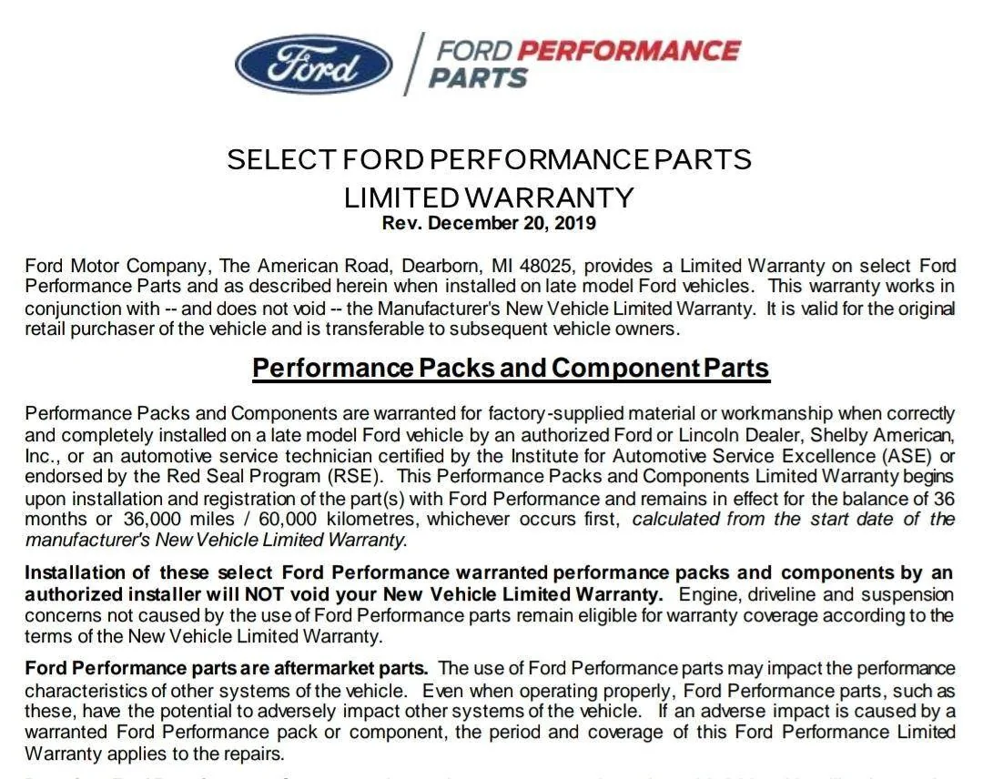

I know there's some confusion about Ford Performance limited warranty, just wanted to clear this up:
1. Does not invalidate your factory 36k / 3-year warranty when installed by an ASE certified tech.
2. Does not affect any extended warranties either UNLESS it is deemed that the performance modification was the cause.
Therein lies the rub. If your past that 3yr / 36k and your torque converter fails or the torque lock clutch plates start slipping, there is a very real possibility that you're footing the bill because the dealer can deem such failure due to the pro-Cal tune since the torque output is much higher.
So, there is some risk there. It will be interesting to see what happens if there is a transmission failure at say 55k miles, will they blame the pro-cal tune? How about 90k for someone that has an extended powertrain warranty?
That remains to be seen. Although I will say that back when I had my 2016 S550 GT PP with a FP Stage 2 Power Pack, on the mustang 6g forums we did not see any warranty denials, but most of those were within the 36k window, not after. And they were almost always engine related, not drive train.
The language absolutely leaves an "out" for Ford to deny warranty after the 3yr / 36k new vehicle warranty (covers EVERYTHING), so the factory powertrain warranty is 5yr / 60k that could be voided. I'm guessing the situation they are considering is that if Ford Performance causes a large amount of failures due to an oversight in testing (unintended consequences) and it occurs due to added stress of pushing performance limits, say at 75k, most pro-cal tuned RR's start seeing converter slip, they have an "out" to avoid a massive loss due to warranty claims of thousands of vehicles vs. the one or two that grenade early on due to a factory defect that manifest (not related to the FP mods).
If it's just a small sprinkle of a few customers here or there, they may honor them to keep the customer base happy so long as their cost is within an acceptable window even past that 36k, but what about after that? The language is undeniable, they DO have an out. Just some food for thought, there IS added risk.
The added torque WILL shorten the life of the transmission, period. The question we all have is.... how much? Also consider that the RR that completed the Baja 1000 (aside from its safety / weight reduction / durability mods), used a factory tuned 3.0L and 10R60, it used the factory fox live valve shocks / suspension geometry but with a modified coil spacers to compensate for over 400lbs of additional equipment (2nd spare tire, full cage, larger gas tank in the bed, spare parts etc.).
The Baja 1000 isn't about just going fast, it's even more so about doing with durability in mind as the brutal terrain will cause failures for anything not well designed to handle the abuse. Would have extra 50 hp and 100lb-ft of torque have made a difference in the Baja 1000? Probably not much as the terrain is mostly what is limiting the speed, not the engine power.
Since they did NOT run the FP Cal, so we might ask, would that 10R60 have survived that race with the added torque? Maybe, maybe not! I have zero doubt that Ford Performance pro-cal is well within the mechanical limits of the 3.0L Ecoboost TT, had the RR come with a 10R80 I'd be all for it without any hesitation at all, but it didn't....it has the 10R60 whose clutch packs that make up the torque lock have a lower torque rating.
I'm not trying to sway people one way or another or suggesting the 10R60 will fail early, I've had Ford Performance cals on past vehicles (2016 Mustang GT PP, with Stage 2 Power Pack installed by dealer). Just trying to help people really understand the limits of the warranty and the possible risks. Maybe I will reach out to the FRPP tech staff to see if I can get a straightforward answer, I've had relatively good luck interfacing with them in the past as most of them are auto enthusiasts who take pride in their work product.
