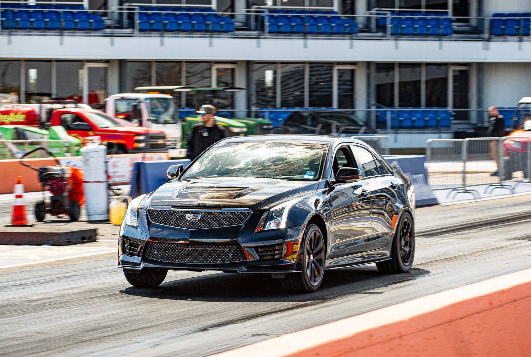

A lot of us in the Cadillac V-series world run an ethanol mix, myself included. On ATS-Vs, the fuel system isn't capable of providing the extra volume needed to run a high mixture of ethanol. In order for that to be effective, we upgrade both the high pressure fuel pump and the low pressure fuel pump. Then it requires a flex-fuel sensor to accurately read the mixture, and a tune setup specifically to take advantage of it.
Ford Ranger Ford Performance Ranger Raptor Tune ats-v

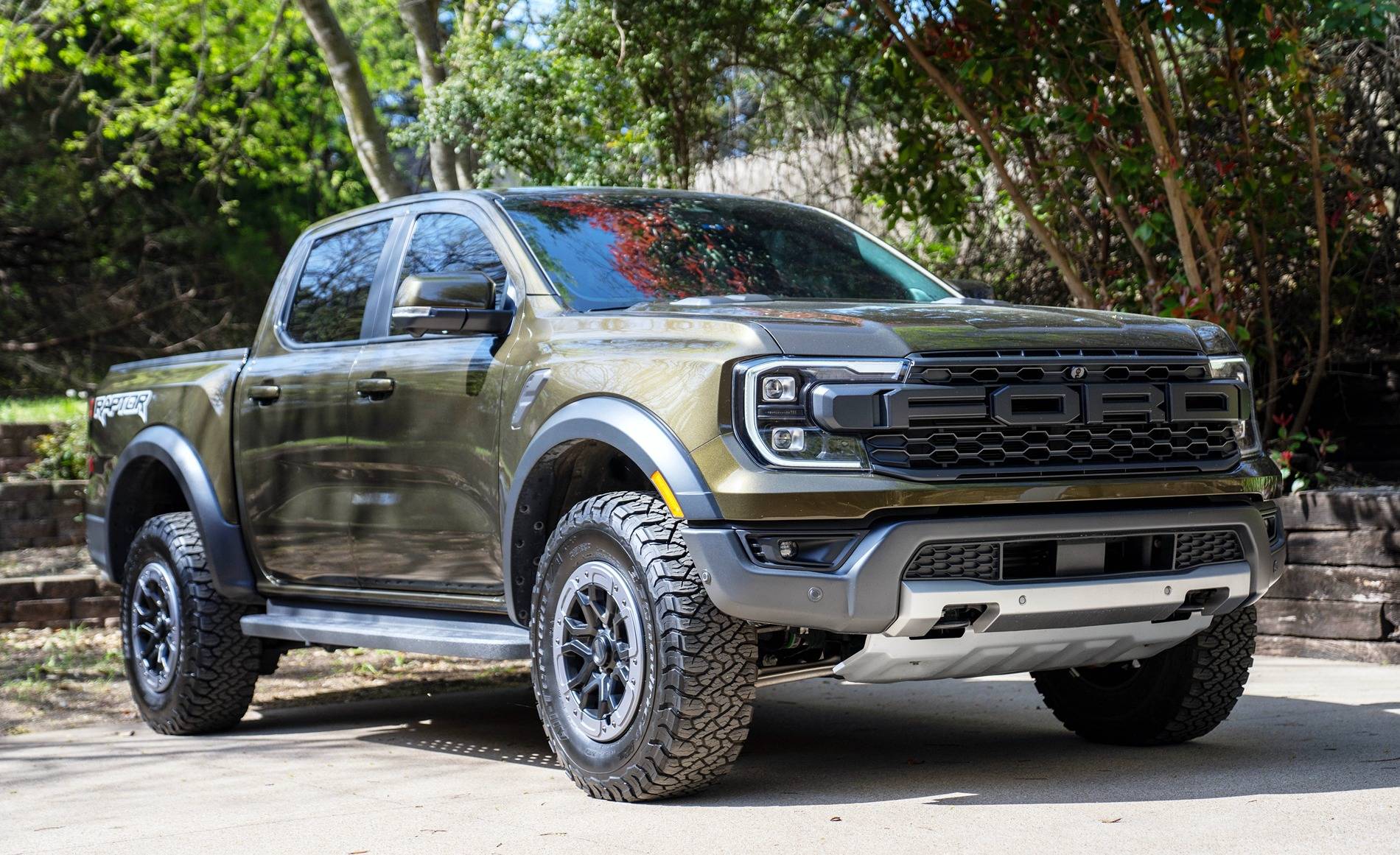

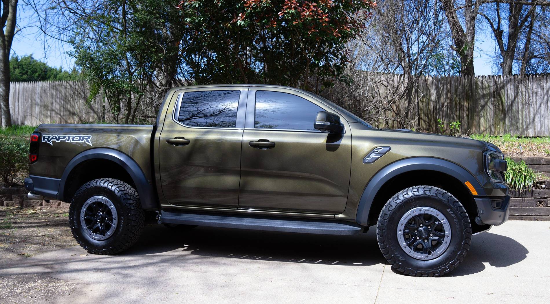

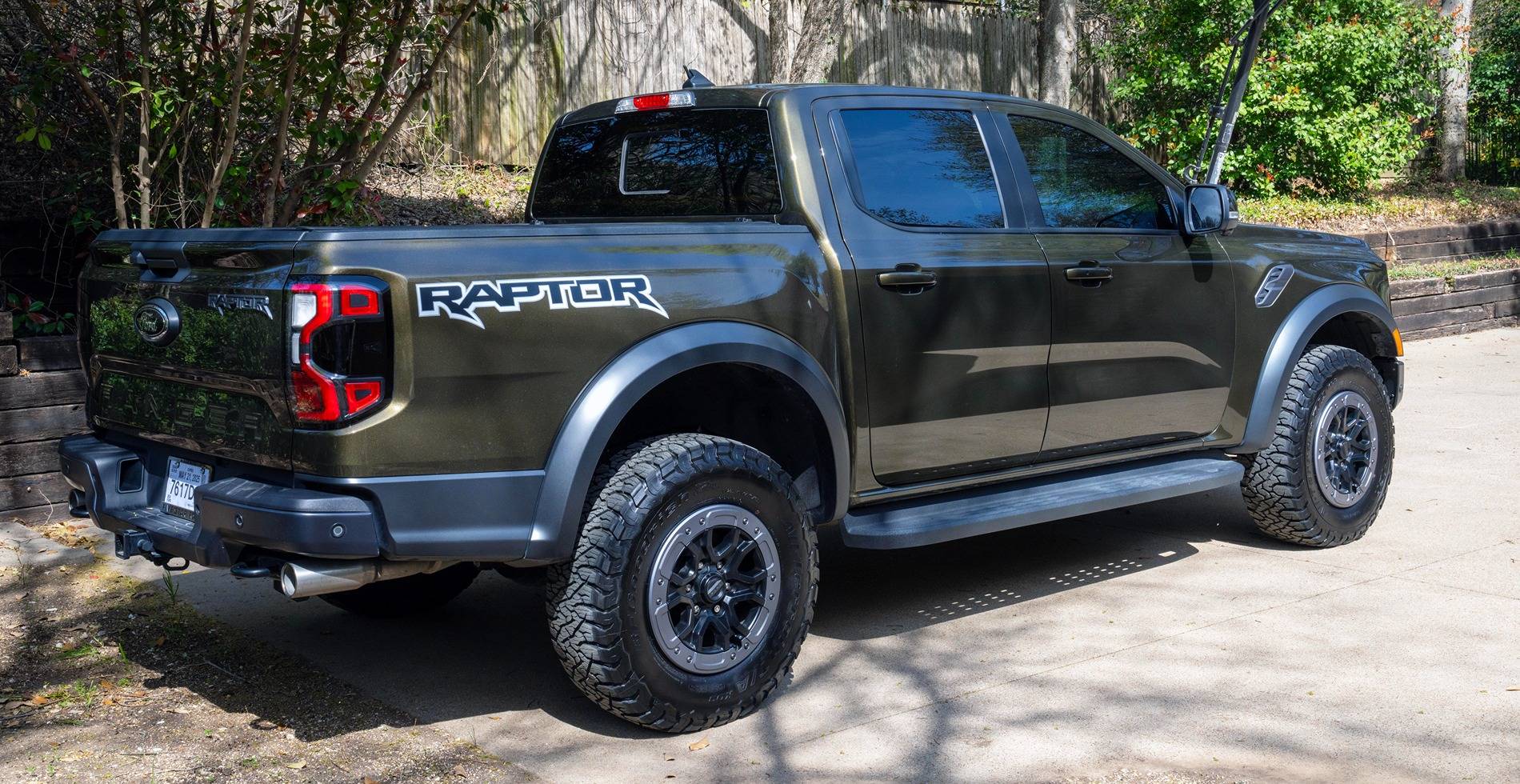

I finally got a chance to take some pics in some better lighting, so you can actually see that it is green.
Ford Ranger Ford Performance Ranger Raptor Tune front
Ford Ranger Ford Performance Ranger Raptor Tune side
Ford Ranger Ford Performance Ranger Raptor Tune back
