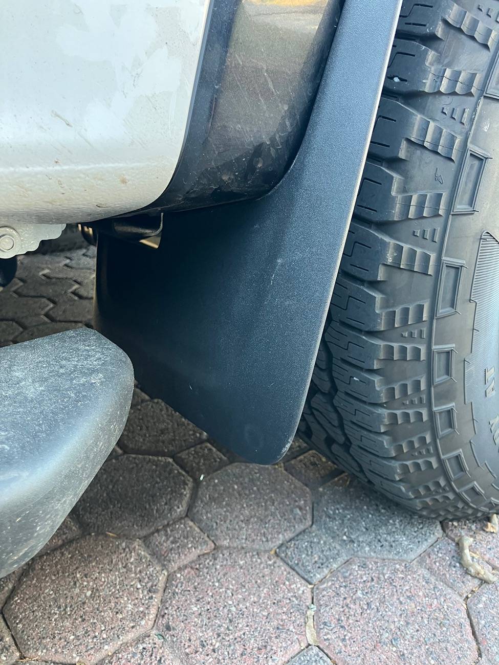

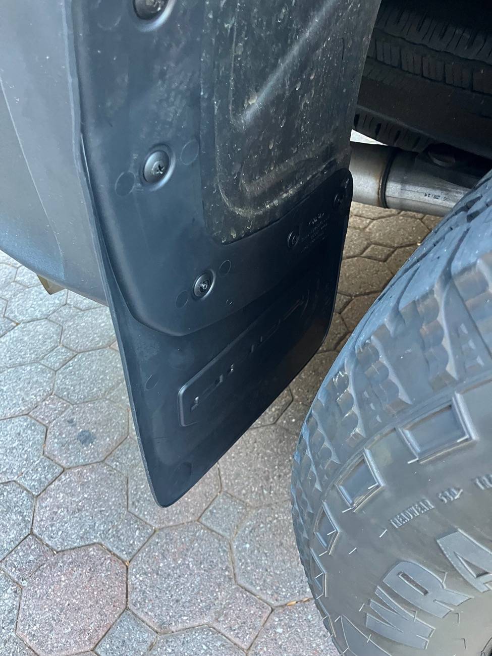

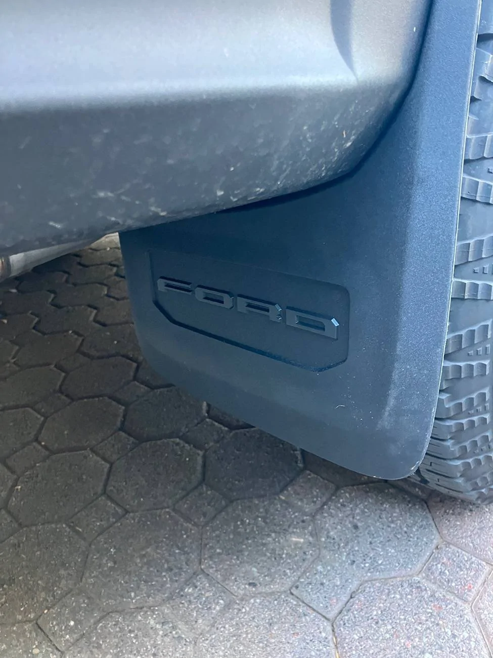

Installed the OEM mud flaps. Stock rivets were a pain in the ass to remove with a flathead. I recommend a rivet removal tool for anyone adding mud flaps, it was so much easier.

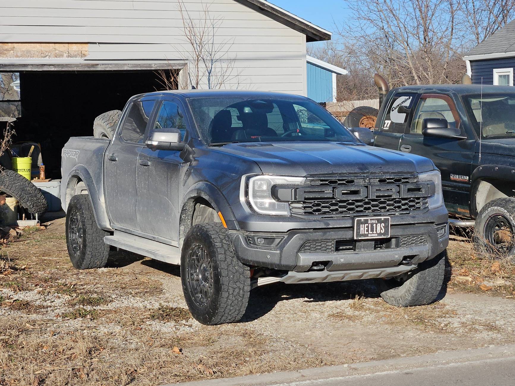

Not sure if this counts, but today I was humbled…

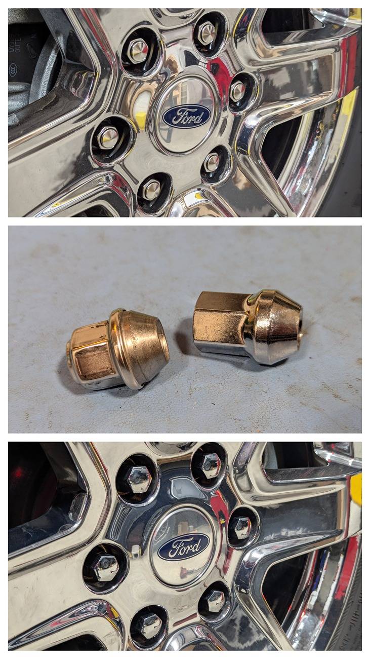

Swapped out the factory 2pc lug nuts for some nice 1pc Gorilla Auto ones
Looks good. I would like to know how they hold over time?
I dealt with the same style two piece lug nuts on FCA vehicles and came to realize that while they still had the rust jacking/swelling issues but the trade off for one piece chrome ones is that eventually the chrome would chip and rust would start on those.

Not a direct comparison, but I've had really good luck with the black finish Gorilla uses on other vehicles so I'm hopeful the chrome ones will hold up well too. My other vehicles see a lot more tighten/loosen cycles (summer/winter/track setups) and for now my Ranger only has the factory setup so I'll probably only be hitting them 1-2 times per year and I'm trying not to drive it much in the winter so 🤞

Did you remove the Phillips head center part before removing the original rivets?

I did not. That would’ve been much easier?
They are call "scrivets". You have to use a phillips driver and with a very lite to almost no pressure try to unscrew them. Most will not screw out all the way but once the head raises off the base, you can pull the center section out and then the base is easy to pull out.

I just did about a dozen of them installing the rear mud flaps. The key is basically no downward pressure when you are unscrewing or they pop back in. Once they’re proud of the rivet I could usually turn them the rest of the way with my finger tips. One just wouldn’t back out no matter what, I eventually just cut it out with nippers since the kit had longer replacements. But yeah, night and day difference removing them with the screw out.
