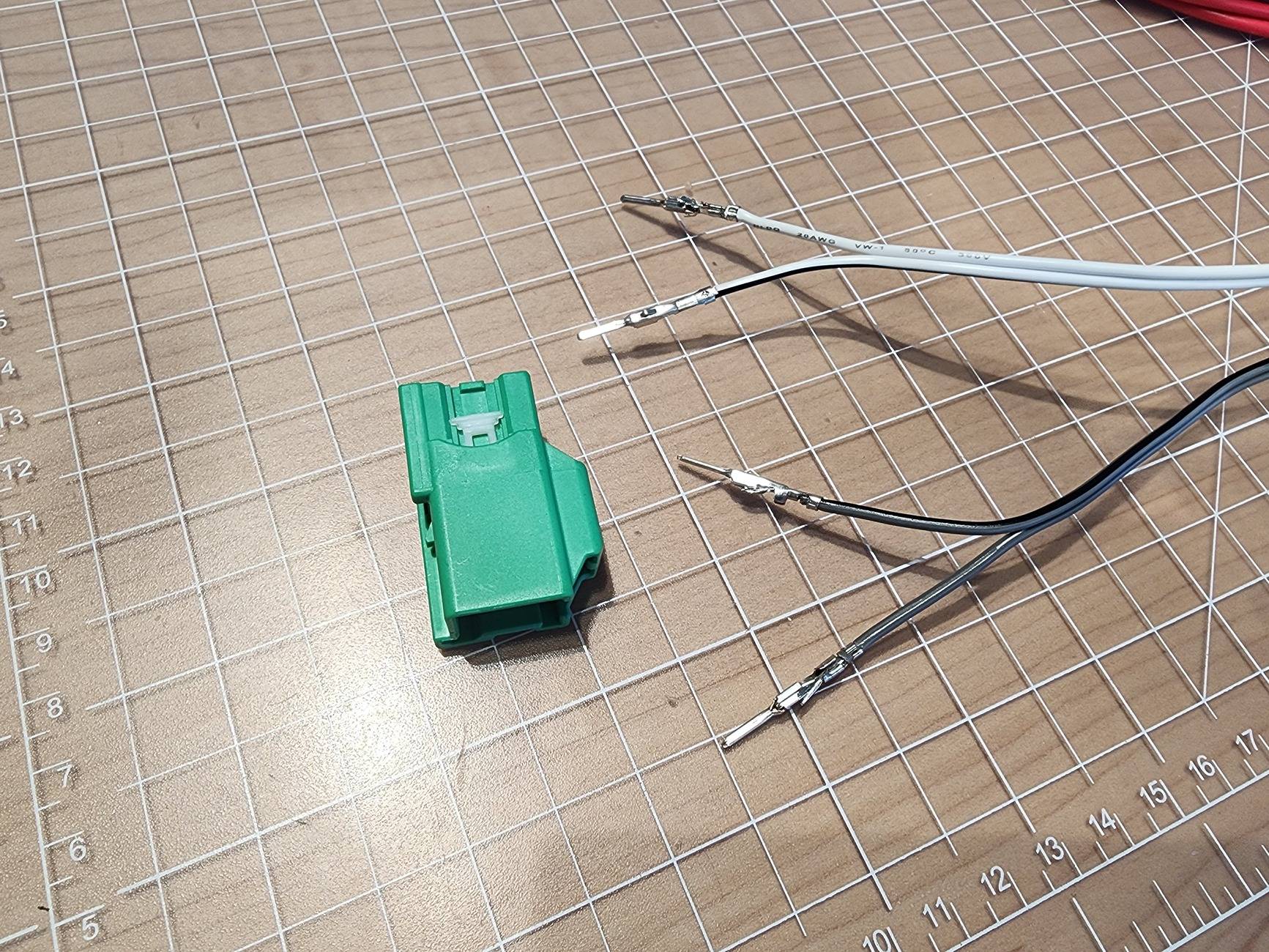

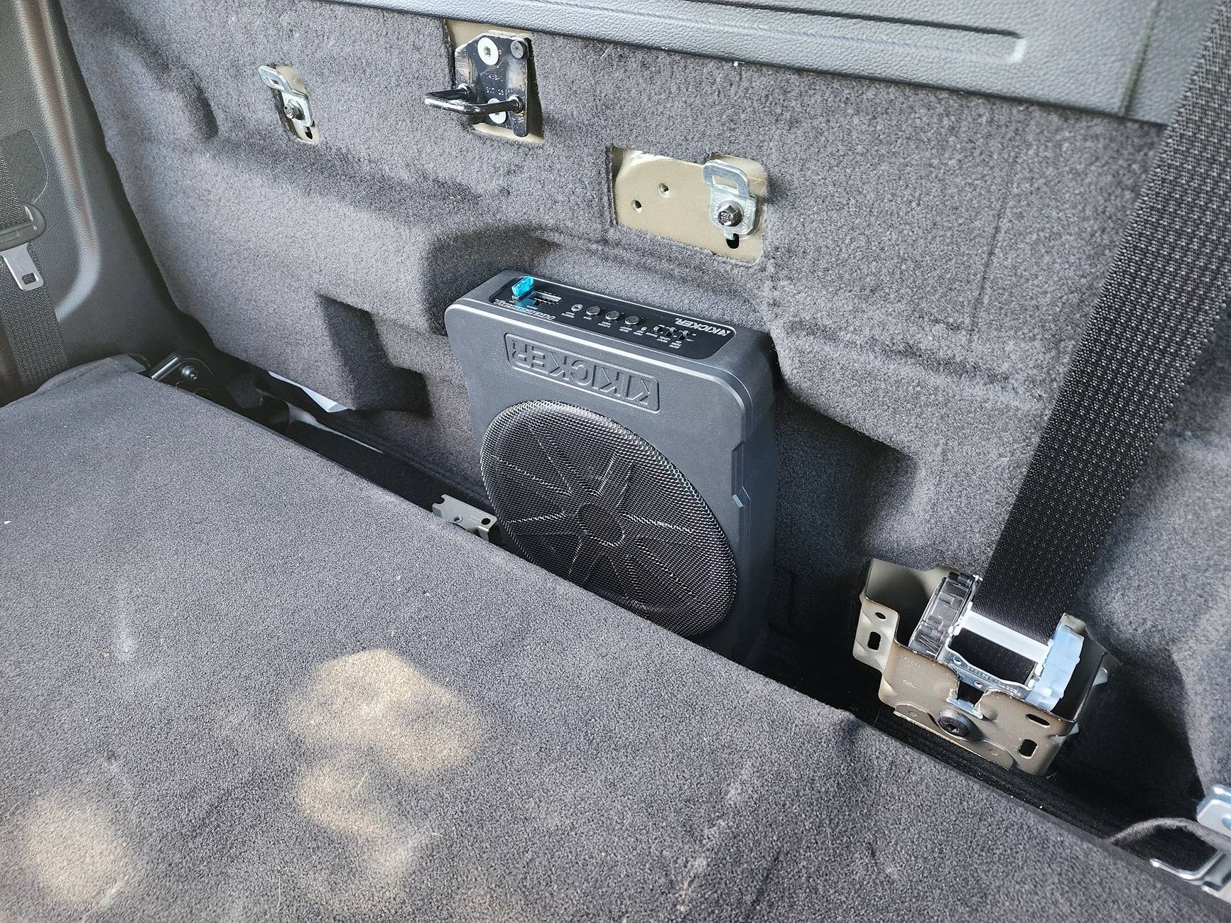

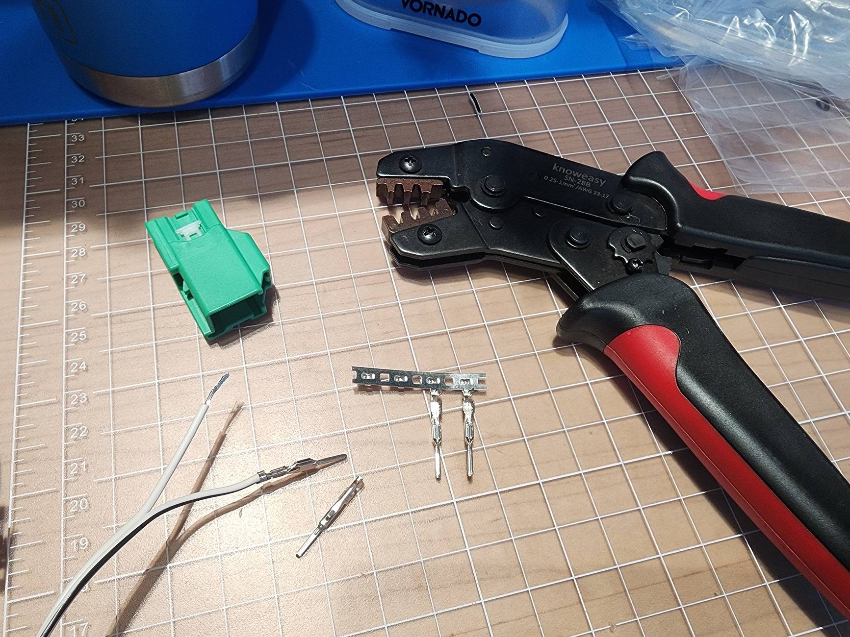

Installed a 10" sub. Found the factory wire harness connector Ford p/n WPT-1456 so I didn't have to cut the factory harness on the stock sub. There are 2 versions, one with pigtails and one without. I got the one without so had to crimp the uninsulated connectors. Just depends on the tools you have and amount you want to spend. Pigtail is about 4 times the cost I think but you spice those, whereas this one you crimp and plug.
Ford Ranger What did you DO TO your 6G Ranger today? 🧰 🛠️ ⚙️ 🧽 20240521_173945
Ford Ranger What did you DO TO your 6G Ranger today? 🧰 🛠️ ⚙️ 🧽 20240521_153343
Ford Ranger What did you DO TO your 6G Ranger today? 🧰 🛠️ ⚙️ 🧽 20240521_154732
It's better than stock but not winning any SPL awards. As you can see it doesn't take up much space at all, pretty much replaced the stock sub. I've also got sound deadening mat ready to go but I'll save that for another day.

- Stock sub is something like 5 1/4". Sounds good for what it is but a 5 1/4" can only do so much, even with DVC and a fancy designed box.
- The sub I picked up is the Kicker 46HS10, 10" hide away sub. It's ok, not sure if it's worth the price. I'll have to see if I can tweak it and adjust the settings some to get it sounding better. It is still better than stock. They do kave both a 8" and 10" that are similar in size and both fit where the stock sub goes. In reality, the sub that goes in the cubby under the seat is the best sounding option and something I'll upgrade to at some point when I do a full system swap. Eventually I'd like to do the mObridge plug-n-play kit and swap out all the speakers.
- I plan on adding sound deadening to the doors first along with some egg foam right behind the speakers. I'll likely do the rear of the cab at the same time. I wish I would have been able to sneak in and do the roof when I had some hail dings removed. They had the headliner off and that would have been perfect time. I'll have to do that when I get some time and motivation. Floors will likely be last. I did the CTS-V and it made quite a difference. I'm not coating every surface, mostly just eliminating harmonic resonances and vibrations, making everything more solid.

I haven't mounted it permanently yet. The jack holds it in place on the bottom and the rest of the sub is wedged between the seat when it's up. The back of the sub rests in the recess for the stock sub almost perfectly so there's no lateral movement. I think those subs are designed to just sit under a seat, hence their low profile. I will 3D print a bracket and utilize the stock sub mount bolt for the top and maybe do the same for the bottom. It would be pretty easy to make something far simpler to hold it in place though.

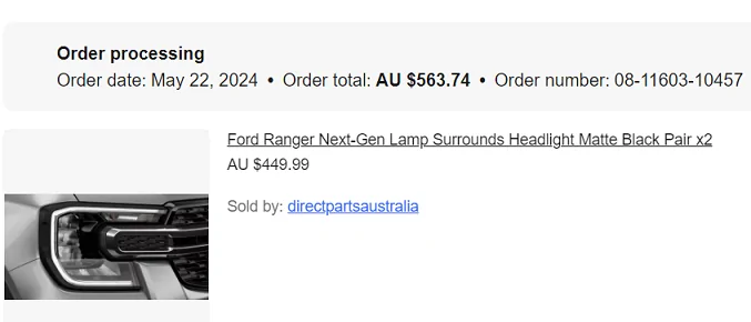

Well I should say that I liked the looks of the front bezels enough that I order the fronts today.
I really like how those tie the front lights into the grill and all seems to match up really nice.
Sort of completes the look.
The rear looks nice, but I didn't see the same sort of value there, so I only ordered the fronts.
I was thinking I could live without the rears and save the 300+
Thanks for sharing the info.
Much Appreciated.
With Shipping and tax the front pair only comes out to $392 US.
Still pretty pricy but I do like how they tie it all together with the grill.
