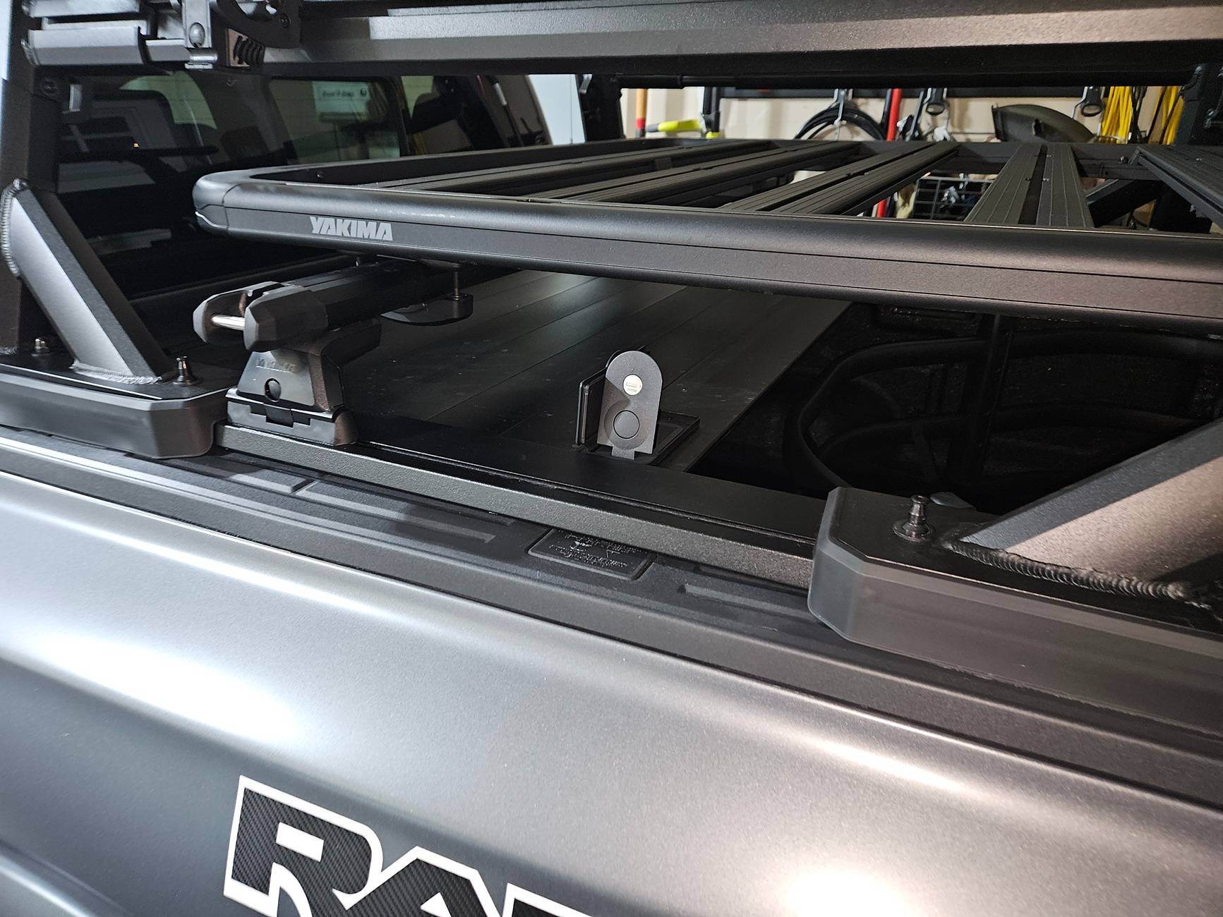

I just thought I'd follow up to show how it turned out.
The tonneau cover does leak, but I know that I didn't do a great job of adjusting it. It's cold here in Wisconsin, i'm just going to fix it in the spring.
It works for now. I also picked up a SkyCamp 3 to put on the Overahaul HD bars in the spring.
