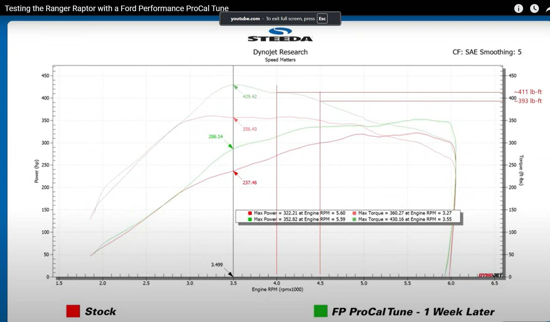

BTW, can anyone tell me the typical RPM range the Pro Cal holds the 3.0L in during Sport and also Baja modes vs. stock?
I know the 10R60 durability has been a hot topic with the Pro Cal, but the shift points play a BIG role.
I marked them up on Steeda's real time Dyno run of stock vs. Pro Cal after the "learn period". If you're running the truck hard, acceleration is going to mostly be in the power band where torque falls off, not the torque band. Towing would be in the torque band, but it's also going to be heavily ECU limited.
The 3.0L even with the cal is only pushing about 411 lb-ft of torque at the wheels AT 4,000 rpm which equates to about 1.14 x 411 lb-ft = 468 lb-ft at the crank.
So, the 10R60 is going to see 470ish lb-ft of input torque during acceleration when driving for performance uses, which equates to a (1 - (468 / 600) * 100 = 22% safety margin on the input torque to the 10R60, not much different from peak torque stock in the torque band which is 29%.
This may also be part of the Ford Performance strategy for transmission durability. Not only do you get the best acceleration in the power band, since power is work being done, but the torque output is lower than in the mid-band around 3k.
That's at a 4,000 rpm hold point. Torque drops a bit more if it's holding at 4,500 rpm. I know many have mentioned that the Pro Cal holds a bit higher up than the factory ECU cal and obviously it's trying to keep you in the power band for maximum acceleration, but it's also less stressful on the lockup clutches as the peak force is lower.

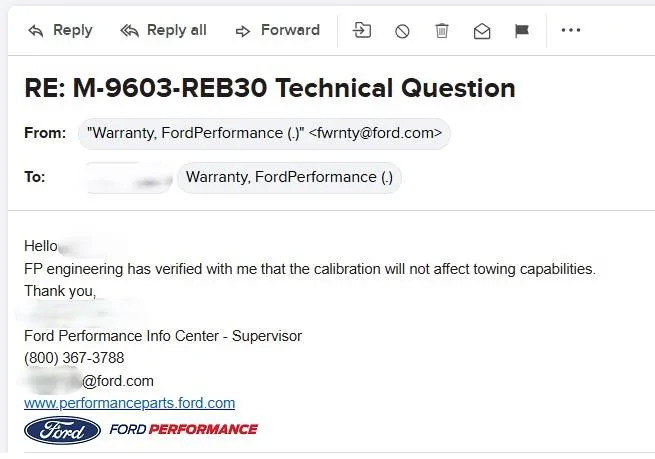

With this reprogram how does it affect the modes like ECO - Sport - Slippery - Tow
I can't comment on the modes in terms of drivability other than the Pro Cal does not affect the max tow rating:
