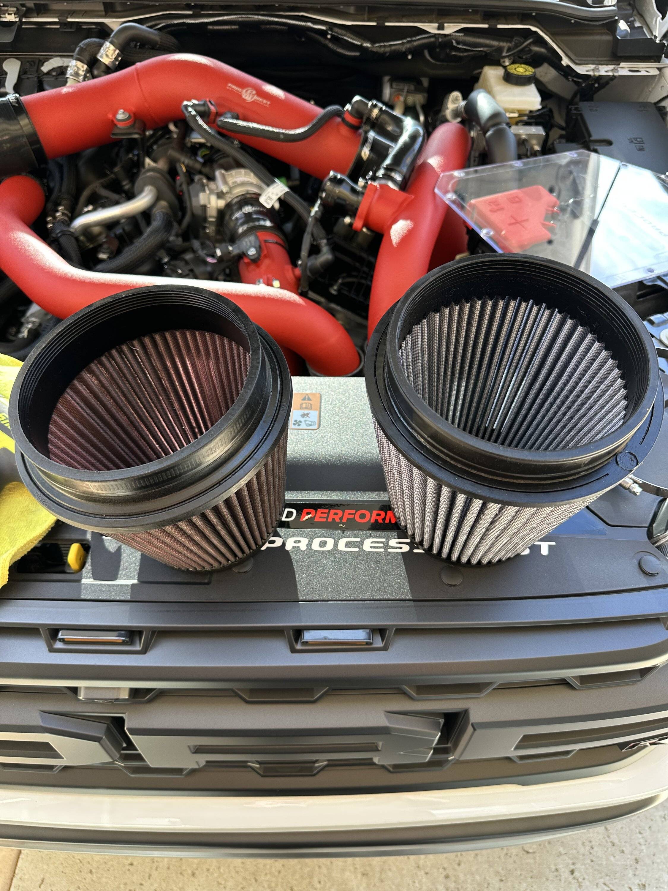

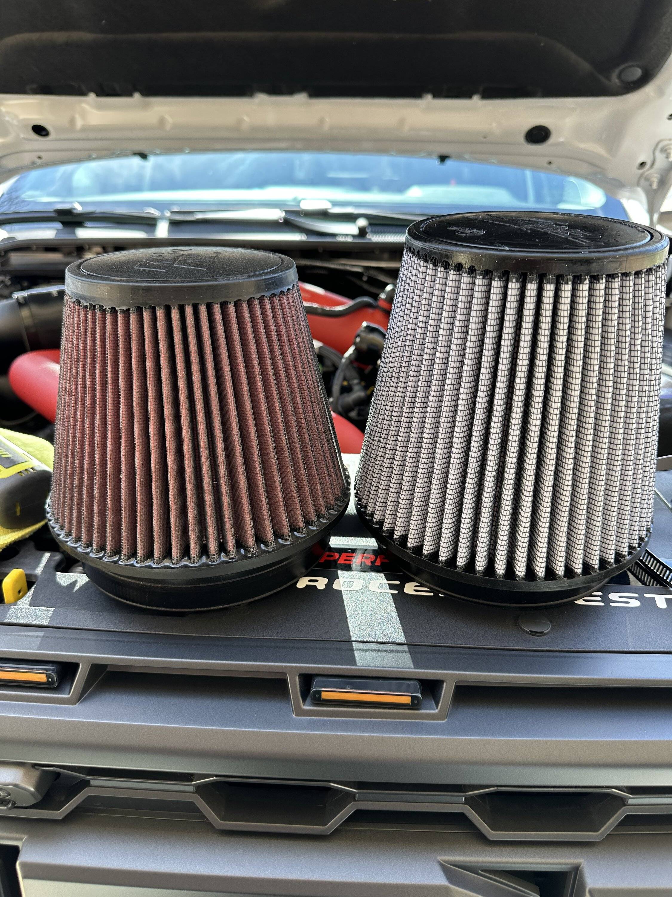

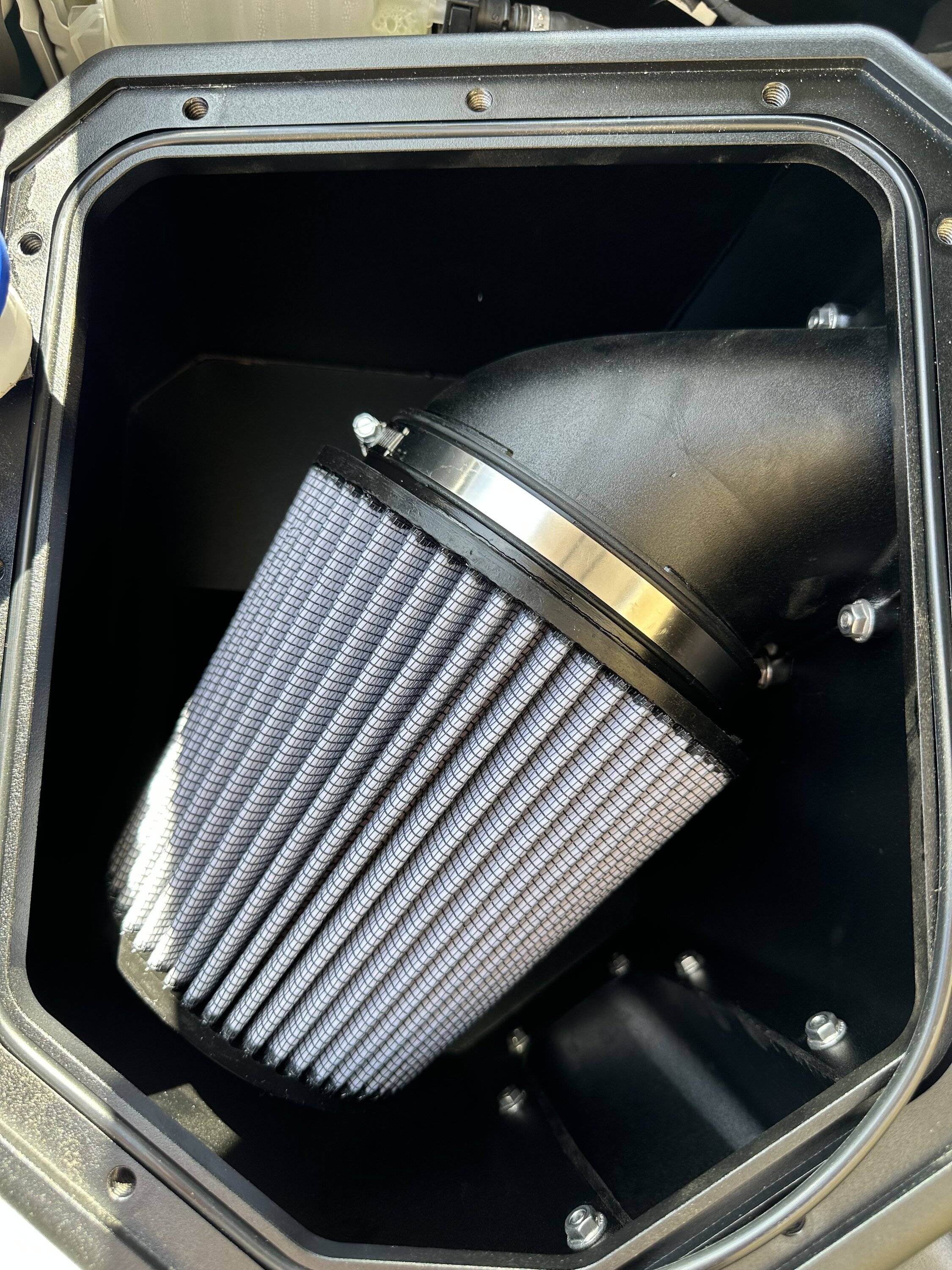

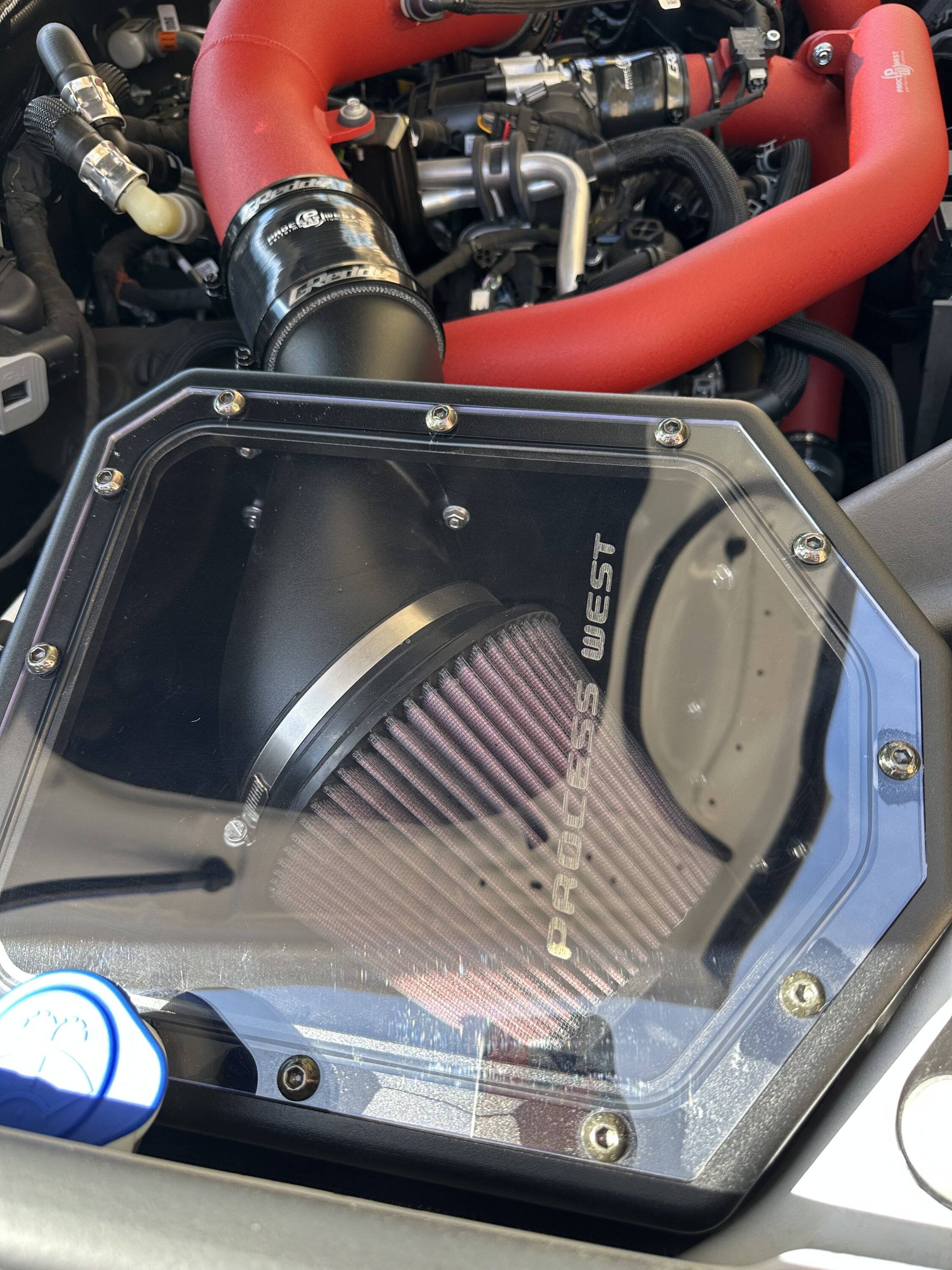

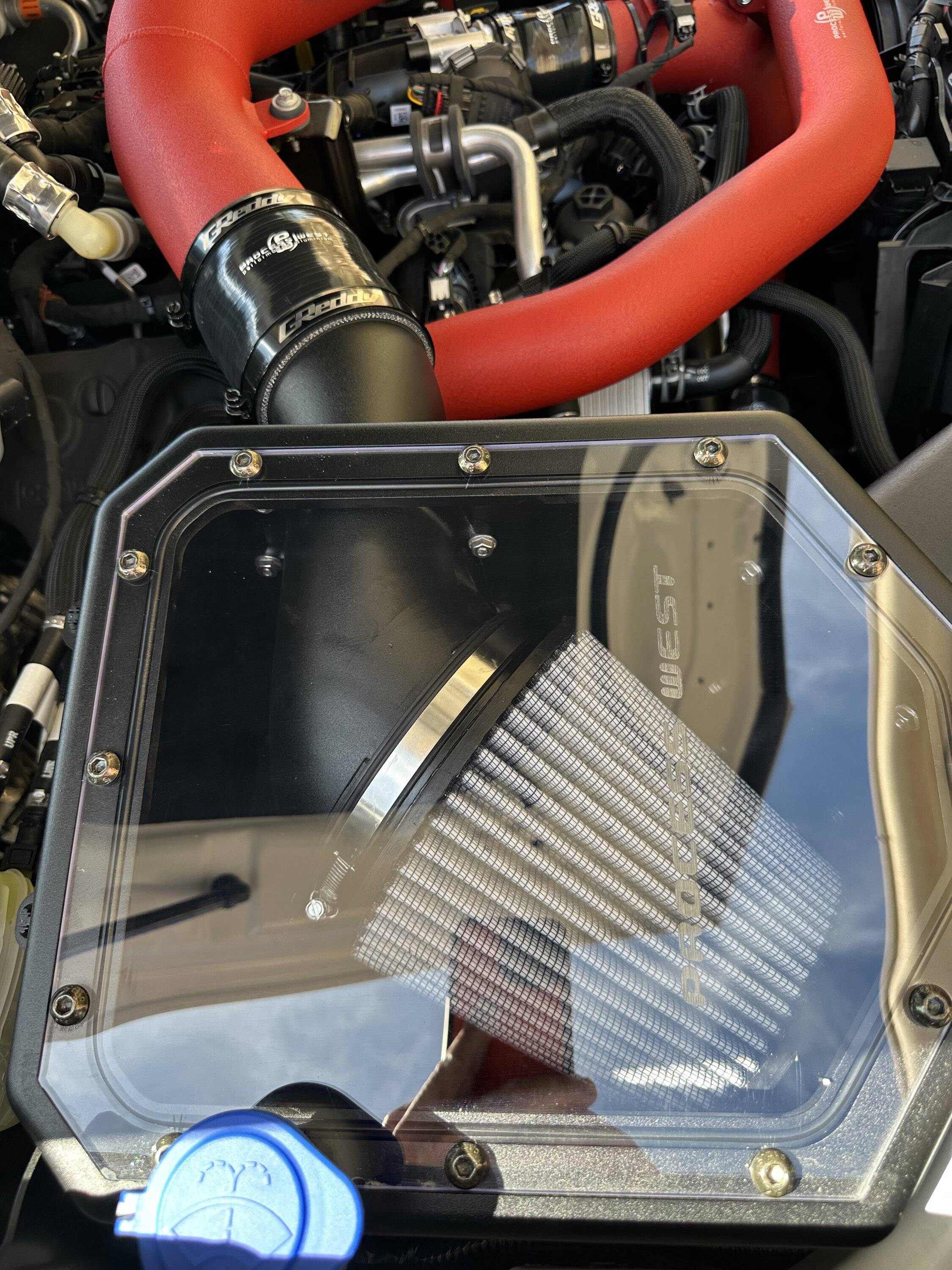

I have the full PW intake kit & Intercooler pipe kit but wanted a dry filter for it so I did some research and found a AFE 21-60507 looked close in measurements just a little taller so I purchase it and test fit today just dropped in but tight fit perfect if anyone wants a Dry filter for there PW intake 👍🏼

Why the preference for the dry filter?
I always preferred dry filters over oiled I don’t know what filter PW uses but took me a while to find a dry option just my preference 😉
