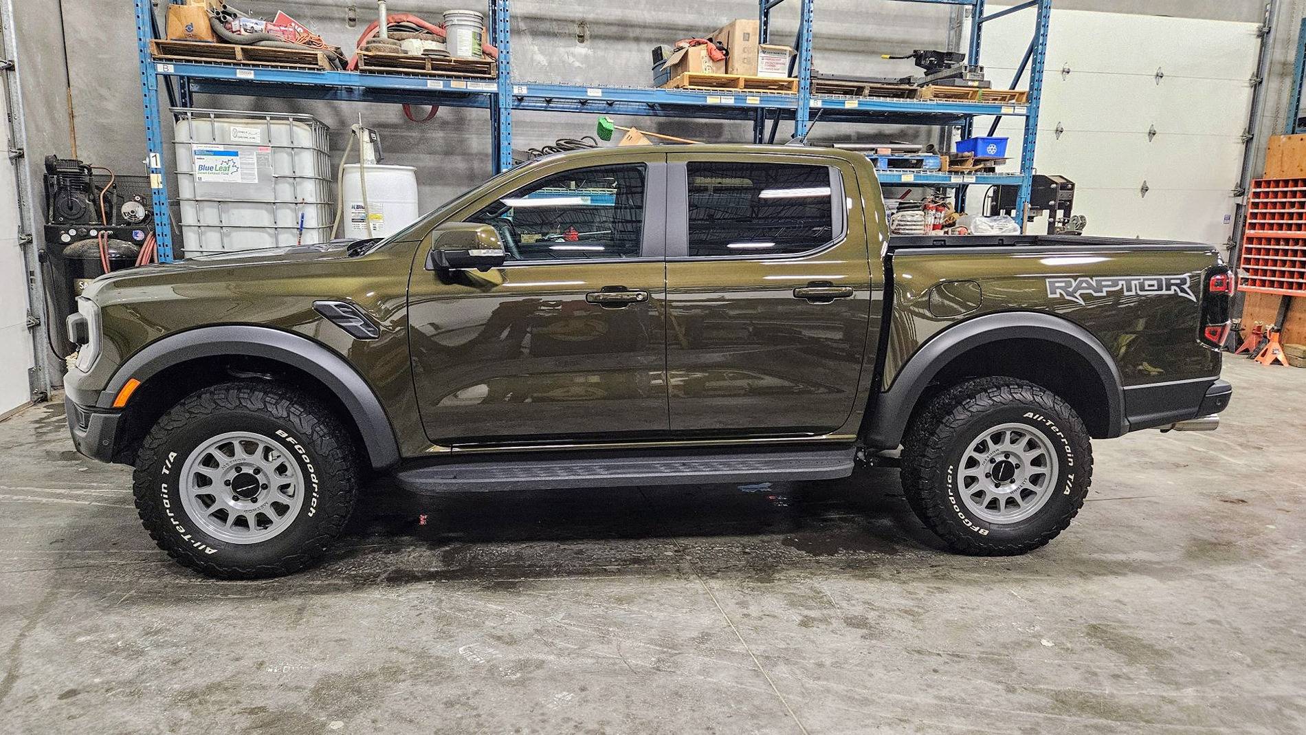

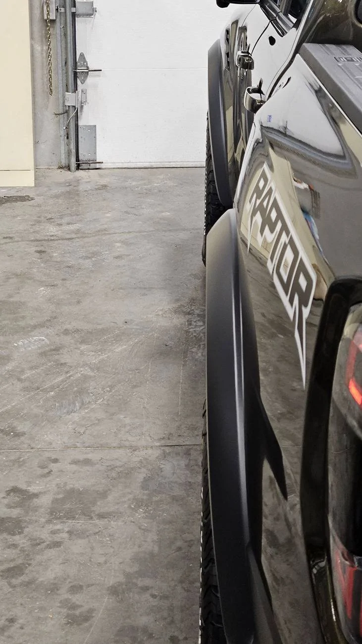

The +35 offset give a nice increase to stance. One of the reasons I went with +35 is when I go to a wider tire, 305 or 12.5 it should sit flush with the fender flares.
Might I trouble you for more pics please? I am leaning towards the same wheel in matte black vs the 305s which are 25mm offset. Some more angles and pics of the stance would be much appreciated.

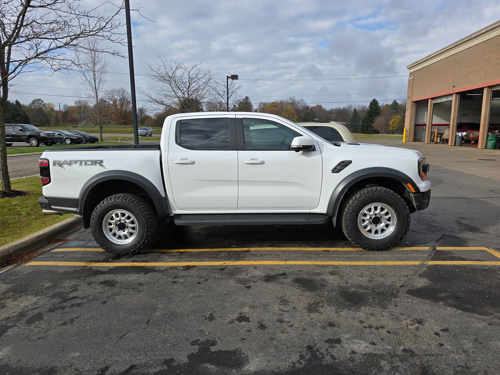

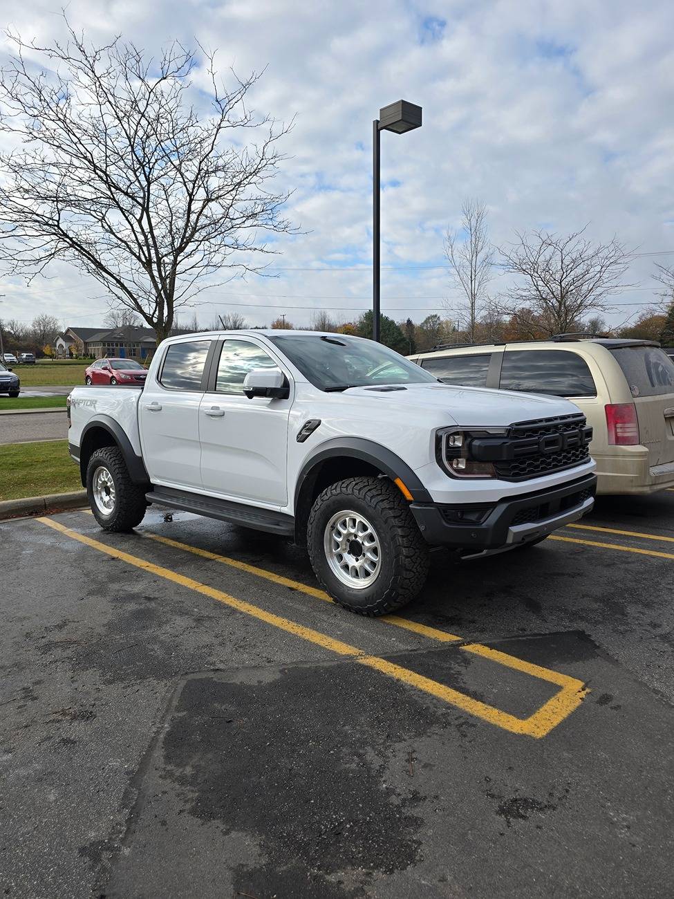

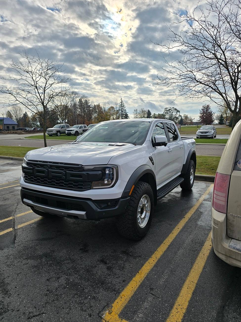

Method 703 17x8.5 +35 with Bfgoodrich K02 285/70R17
