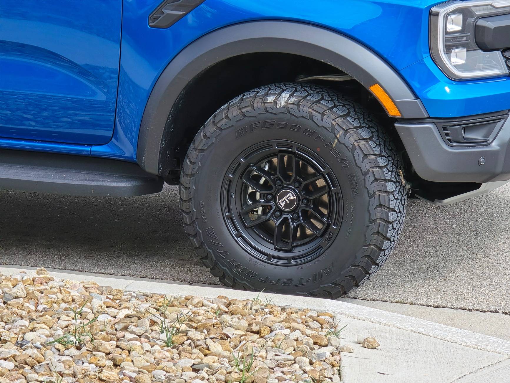

Yes, I was able to slide the front's out without cutting anything at all. I plan to reinstall them after I get the perch collars
They ride great, very similar to the KO3's, maybe a little more road noise.
They sit pretty close to even with the top of the flare. Slightest pit of poke maybe, I'll add a few more pictures.

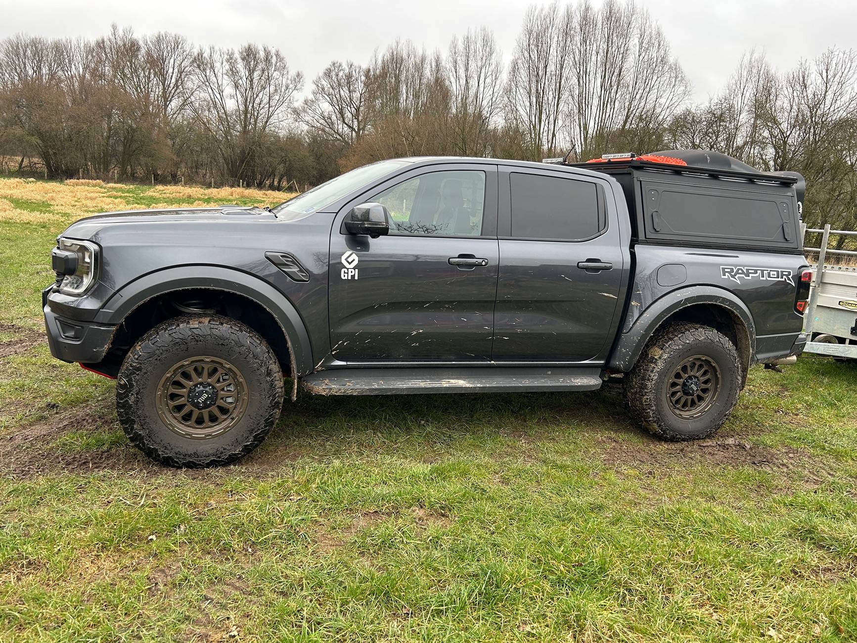

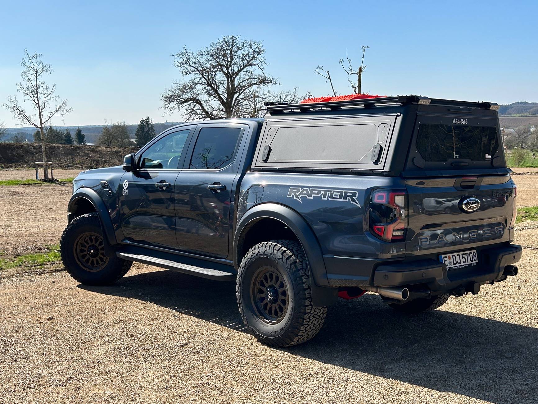

Oh, they want them lol ! Remove the crash bars and get the proper alignment with an adjustable UCA. I’m running stock UCA and no crash bars. All good here. Plus I’m running a 35x11.50.

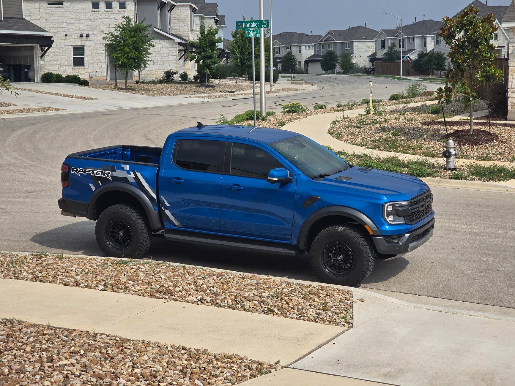

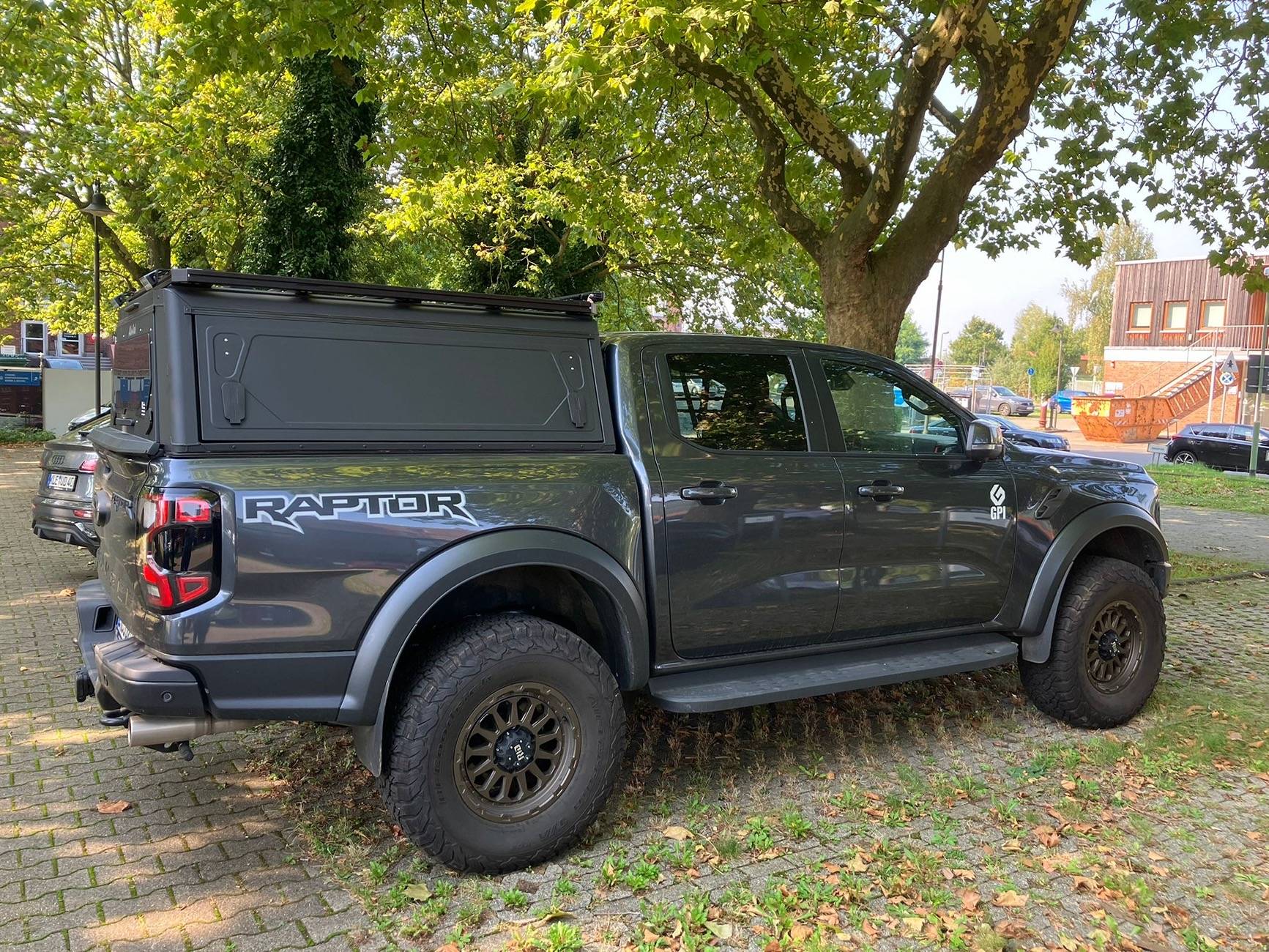

I installed Foutz 2.5" Collars in the front and 2.0" in the rear. I was able to leave the rear crash bars in place so far, I haven't been able to completely flex everything out to confirm full articulation clearance but for regular driving and fast unimproved roads I have not had any contact.
Before the Collars
After:
Picked up just about 2.5" in the front and just under 2" in the rear.
How did the ride change after installing the lift collars?
