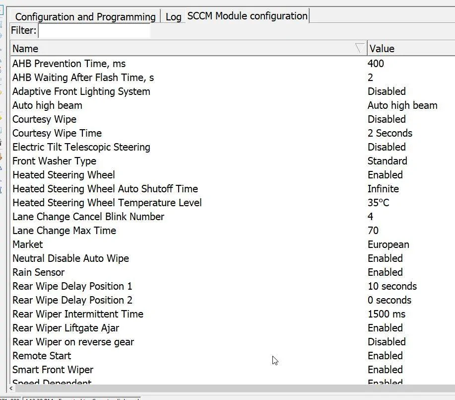

Hello everyone. I am trying to see if there is a way to adjust the temperature setpoint for the heated steering wheel. I have scoured the asbuilt data and can't find any information on this, but I have another thread where a couple people told me I could with forscan and one person even said they found it but won't tell me where it is. Can anyone point me in the correct direction? Im extremely familiar with forscan, I don't know why I'm having so much trouble with finding this parameter....
I (thought) I just posted on that other thread late last night that I found it. but when you posted this realized it was still sitting there waitng for me to submit. Doh!
it's in the SCCM module

If you get a chance to try this and confirm it works, please post back here or PM me and I'll add it to the "confirmed" tab of the spreadsheet.
