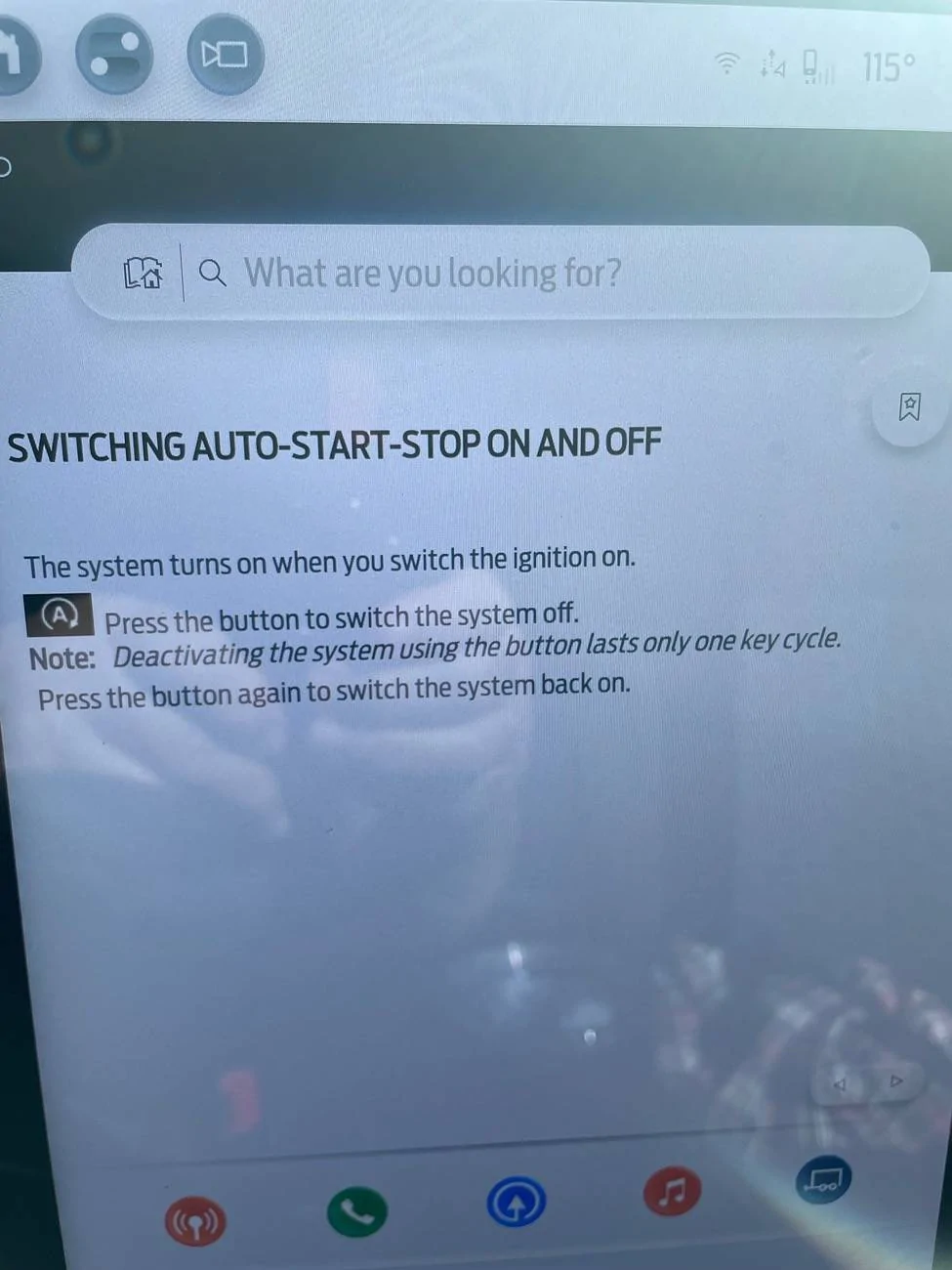

When I do this this I get a notice stating it will last only one key cycle ............... or something to that effect.

Well, I have just jinxed myself. I got my Ranger on 9/13 and once I turned off the auto-start-stop my truck had NEVER shut off when I stopped. When I posted the directions I used it worked for me. When I was asked for a screen shot showing where I turned it off, I decided to take a screen shot. When I reached the section to turn it off I got a different screen. The one that initially displayed had the tab you slide to turn a feature on and off. This time I got the notice that says it only works once and must be turned off each time you start the truck. No more slider. I then decided to take a quick ride to confirm my truck didn't turn off when I stopped. As I started my drive I saw my neighbor who has ridden with me numerous times and each time commented how he wished his Lincoln's start-stop could be turned off permanently. I stopped and the truck kept running. I explained what I was doing and I asked him to take a ride and video a series of stop and starts. The first 3 worked as normal and the truck kept running. On the forth stop it shut off and continued to do so until I press the button to deactivate it. Now I am not a happy camper and wish I never responded to this thread.

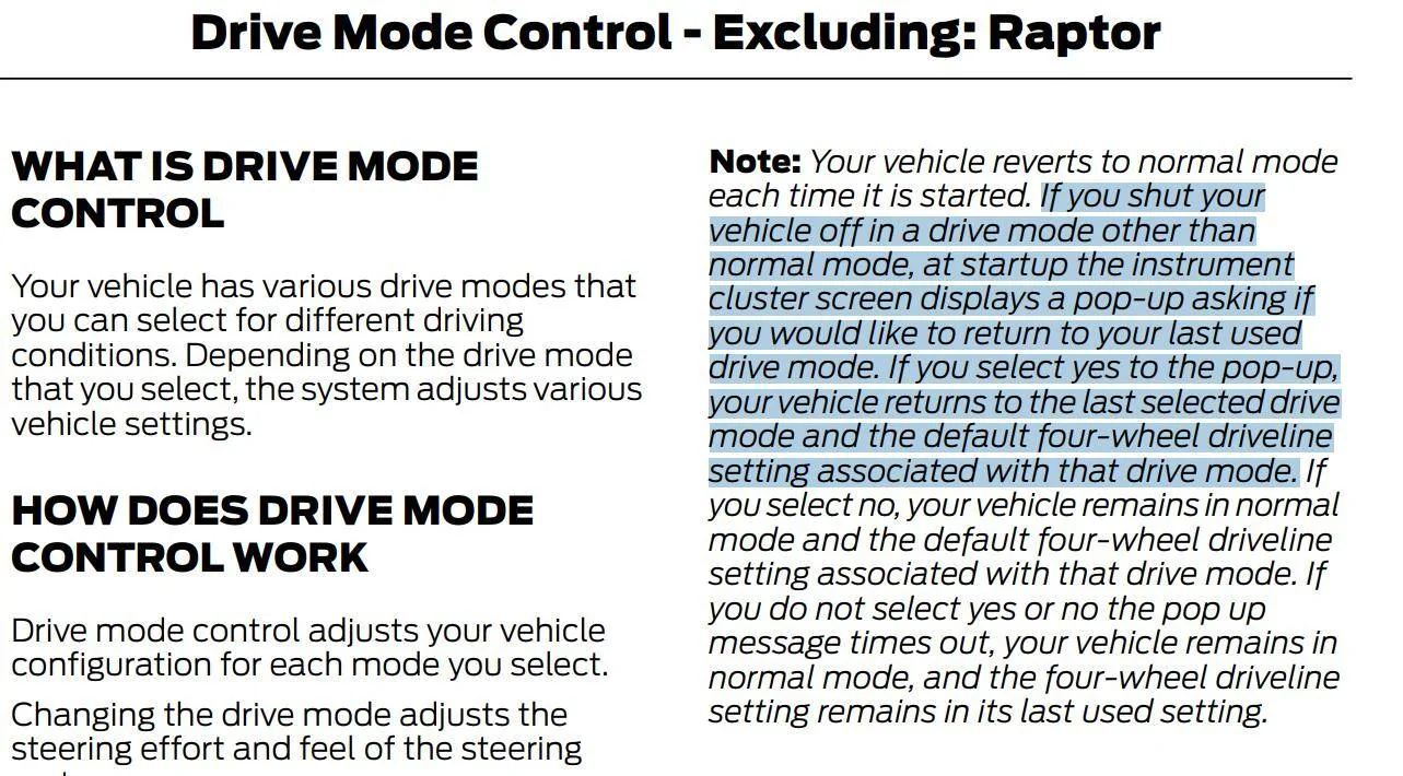

Sorry thought I was in the Raptor forum. The manual is imprecise as to whether you can save any settings in a non-Raptor - see partial. On my Lariat I just pushed button as part of start up routine.

I follow these steps and I get a screen that says auto-start-stop is deactivated when you shut off / restart the engine. Auto Hold which activates the brakes when you come to a stop can be permanently activated/deactivated in settings.
Yep, this is only a temporary for auto start/stop toggle. Shut off the truck and it reset to on. It’s not a permanent solution. Been there done that.🇺🇸
