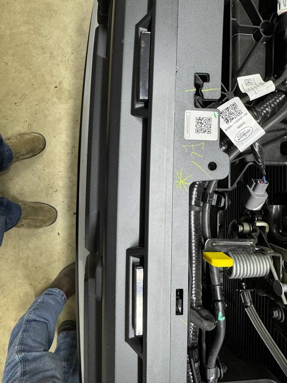

They do not insert at all. Photo of test fit, but I also did flip it and tried the actual side. They are not tapered so doesn't matter, was trying to make sure the wire wasn't keeping it from pushing in. Confident the bit of red tape covering the adhesive is not the culprit. These clearly are not made specifically for the Ranger and should not be advertised as so. Disappointing considering the premium price. Hopefully they will cover the return shipping due to their false advertising.
How were you able to drill out the hole to pass the wire through. The video says to use a ½“ bit but it barely fits in the middle port and rubs. I worn off some of the plastic on the bottom edge. . The other two are a no go. I drilled pilot holes but I can’t drill out so that the connector goes through. Kinda PO’d because I should have done more research.

how did you drill out holes to pass the wire through. I watched the video and it says use a 1/2 bit but it rubs and the bit rub o
It's easier if you remove the grill. Removing the grill was easy. I saw a "how to" video on Youtube and had the grill out in under 10 minutes. With the grill removed you will see that the portion of the grill with the 3 light pockets is just a trim piece held on by a few screws from the back of the grill. With the trim piece removed drill the 1/2" holes from the back side. Then you will have to drill holes in the grill that line up with the holes you drilled on the trim piece.

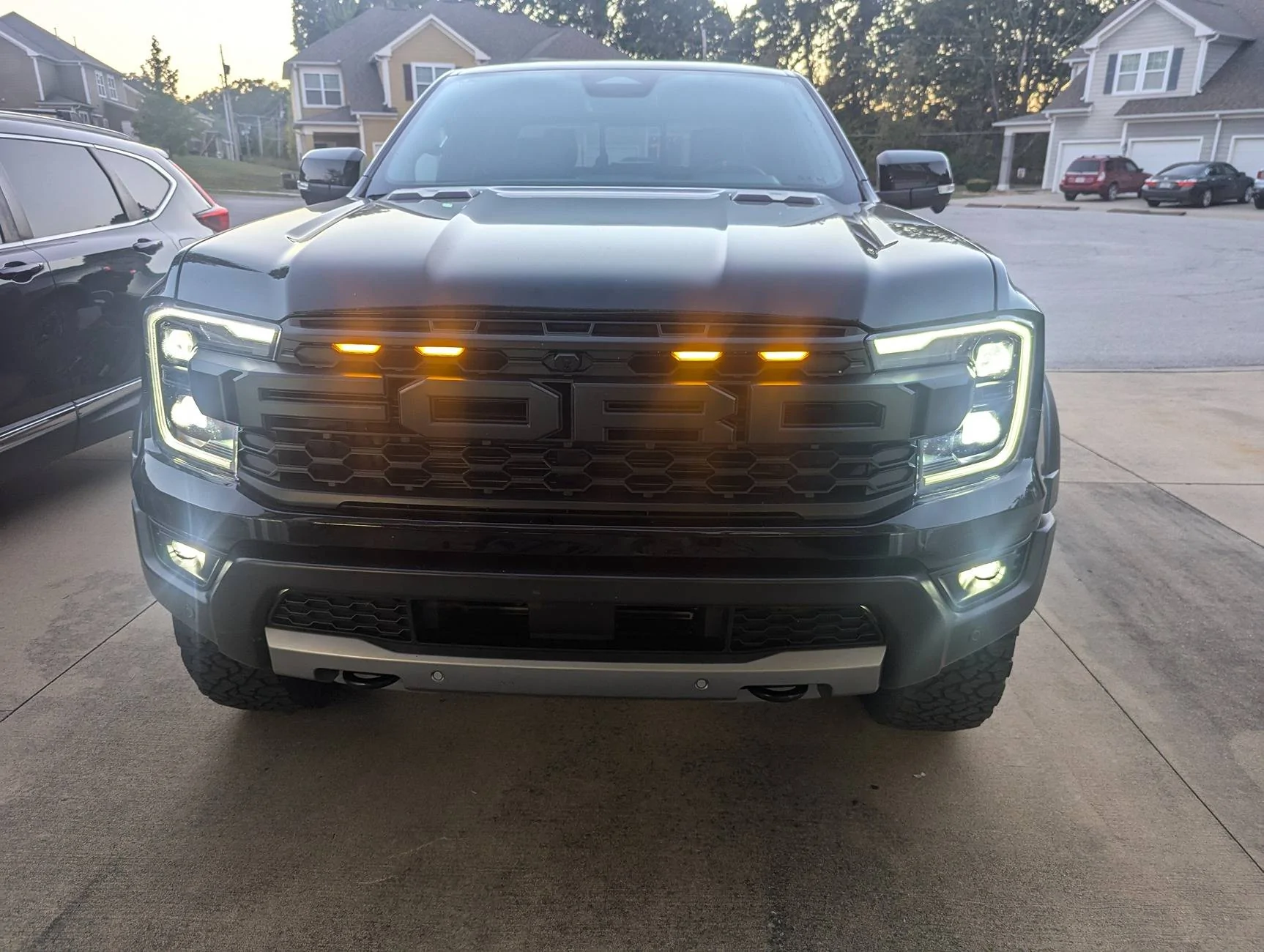

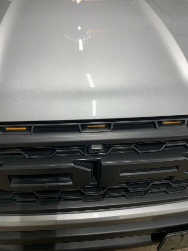

Most people weren't happy with the fit. They are a bit too thick to fit deep enough in the pocket to sit flush with the front of the pocket. I'm that guy that sanded the housings down a little to make the rear taper down a bit so they fit all the way in the pockets. (2nd pic)
