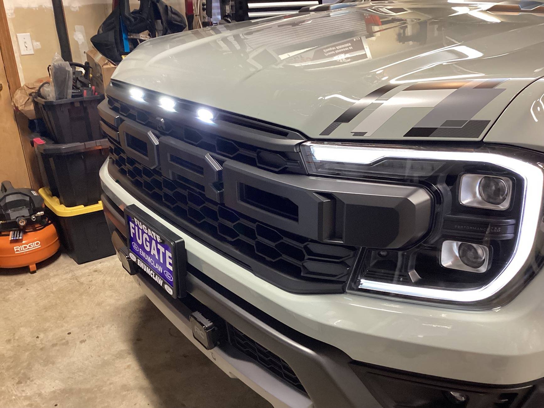

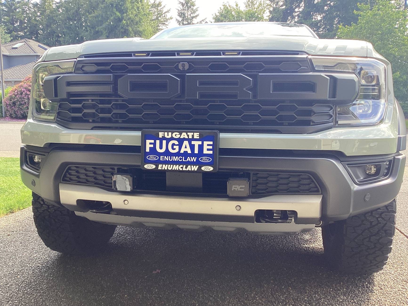

Removed the cover over the grill under the hood, drilled small holes in the grill. Powered them thru the break controller in the fuse box, number 50 I believe.

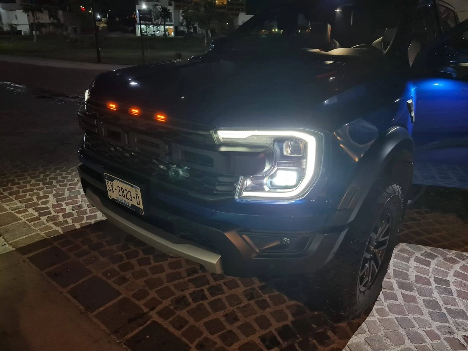

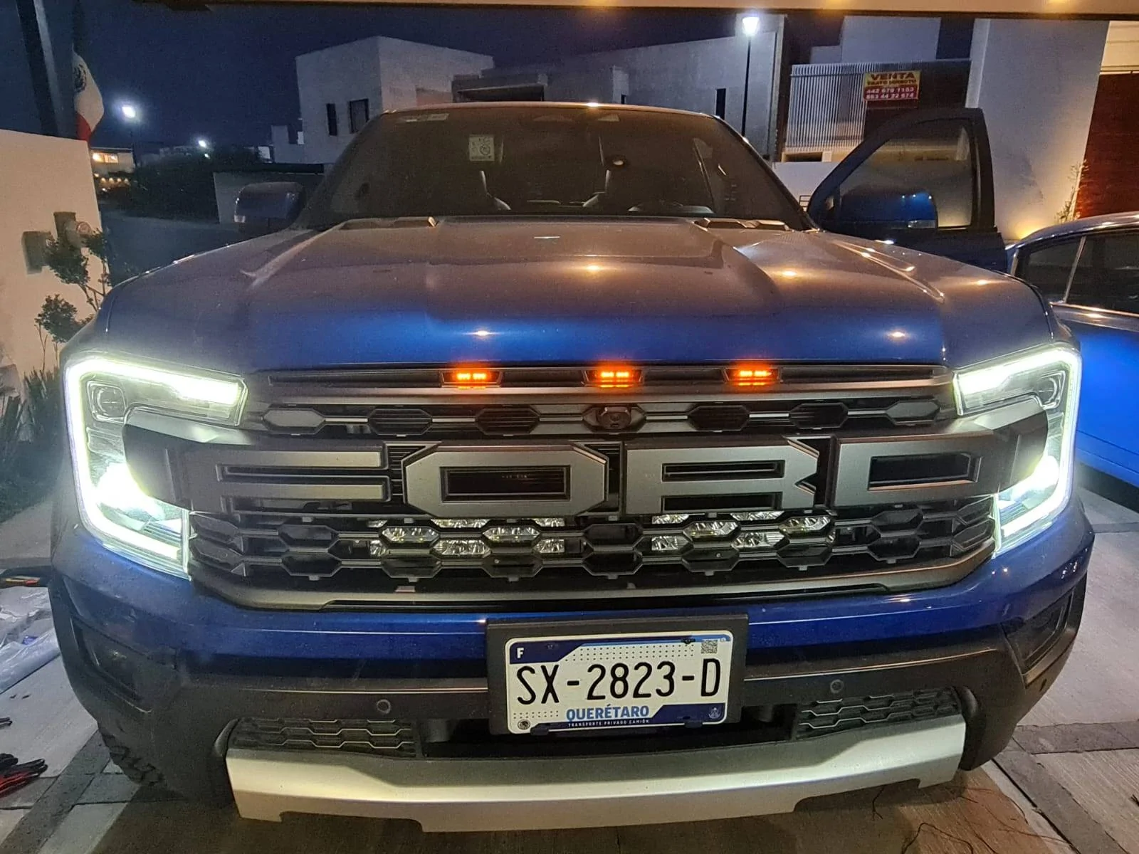

I have mine but are amber color. They do fit pretty flush with the grille, but not exactly the same in all cavities, you need to make sure to place them so they look as similar as possible. Mine were connected according to the instructions of the seller, and work as running lights. you cannot see them much while off, because the lenses are smoked.

IT's important to be clear about the lights you have installed in this post. I believe that the prior post from Ivan Baez is with the ebay version of the amber raptor lights. The line in the middle of the light tells me it's not the lights from F150leds.
I purchased the lights from F150leds and quickly returned them because they stuck out way too much for my liking and I didn't want to test how deep I could shave them down without destroying their integrity or seal for water protection. They were very good about refunding what I originally paid, but I had to pay for the return shipping.
There's a bit of curvature to the grill and the outside lights hung out over the bottom lip of the grill. The center light was about even with the bottom of the lip, of course that means that the top lip was sitting way back from the top of the light.
I wondered if there's enough demand from the 2024 owners to justify a US company to develop lights specifically for the Ranger Raptor grille yet, so I went with the ebay version for now and will wait it out for a better product.
