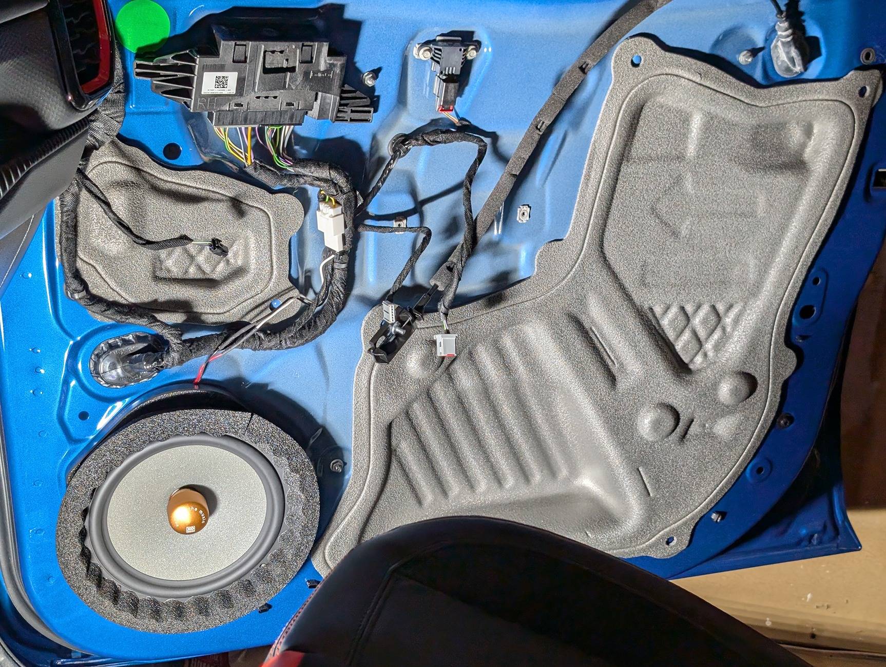

They came out pretty good, but I did have to do some work. I was sent custom rings for them but they weren't exactly flat and I had to file them down a bit for fitment. That being said, they sound fantastic with the matching tweeters.

OP, If you're still around. Where did you get those rings? I'd like to go a similar route & am too lazy to make my own. Thanks
They were made by Morel for me.
