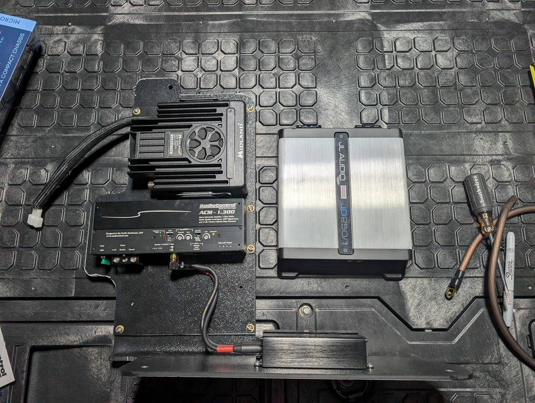

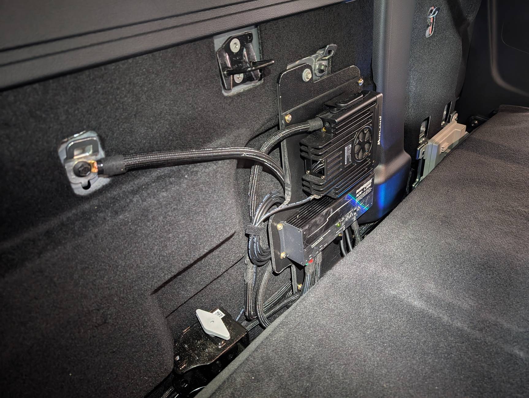

I did go back and replace the amp with an AudioControl ACM 1.300. Definitely the right amp to use especially given the space. Updated the first post to have some pics at the end but that amp is tiny compared the the JL
This let me move the GMRS radio down a couple inches and I removed the spacers on the rear seat latch. Back seat closes just fine now like before.

Any power or sound difference between amps? I believe they have the same RMS wattage output for the sub, I believe. Curious what settings you'll use on the amp too. It's a nice compact package!

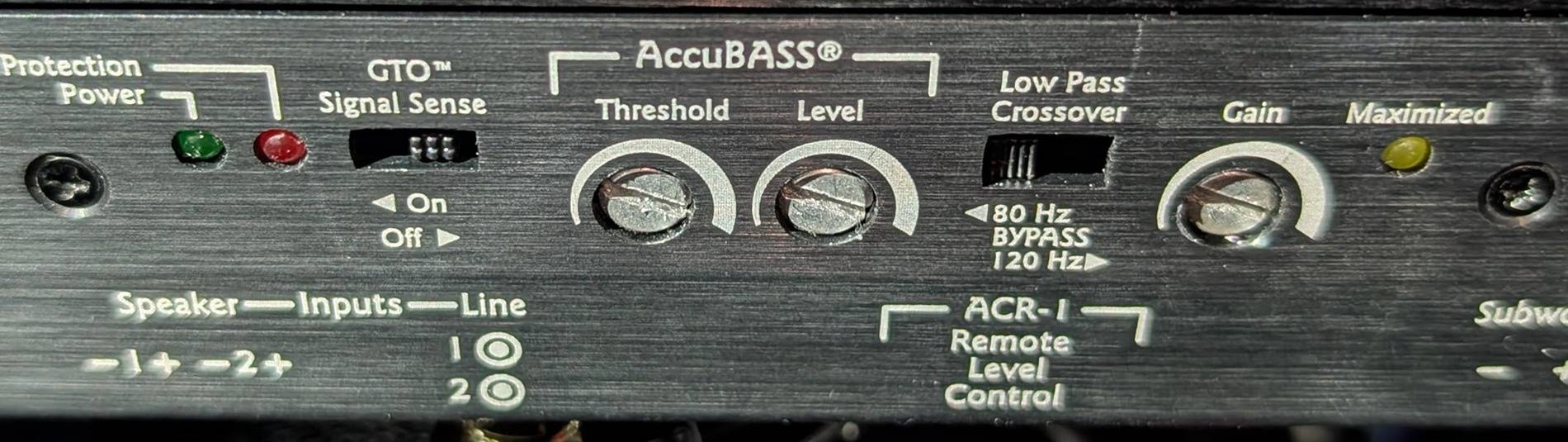

Thanks! It does seem like the ACM is a little more powerful (listed as 300 watts vs 250 but I don't know what they are actually putting out). I have all the dials on the amp turned down as far as possible, the crossover set at 80Hz and the remote "off" (which uses the actual remote wire vs trying to detect something on the audio signal). In the Ranger's audio tone settings I have the bass turned down to three positions from the left. Basically turned things down as much as possible as it's a LOT of bass coming out of that sub.
I mean it sounds amazing but I can't imagine turning things up. I usually listen at volume 10-12, and for max maybe 16-18. I feel like the with the JD250, I could turn it up a little louder before going deaf, but not by much.

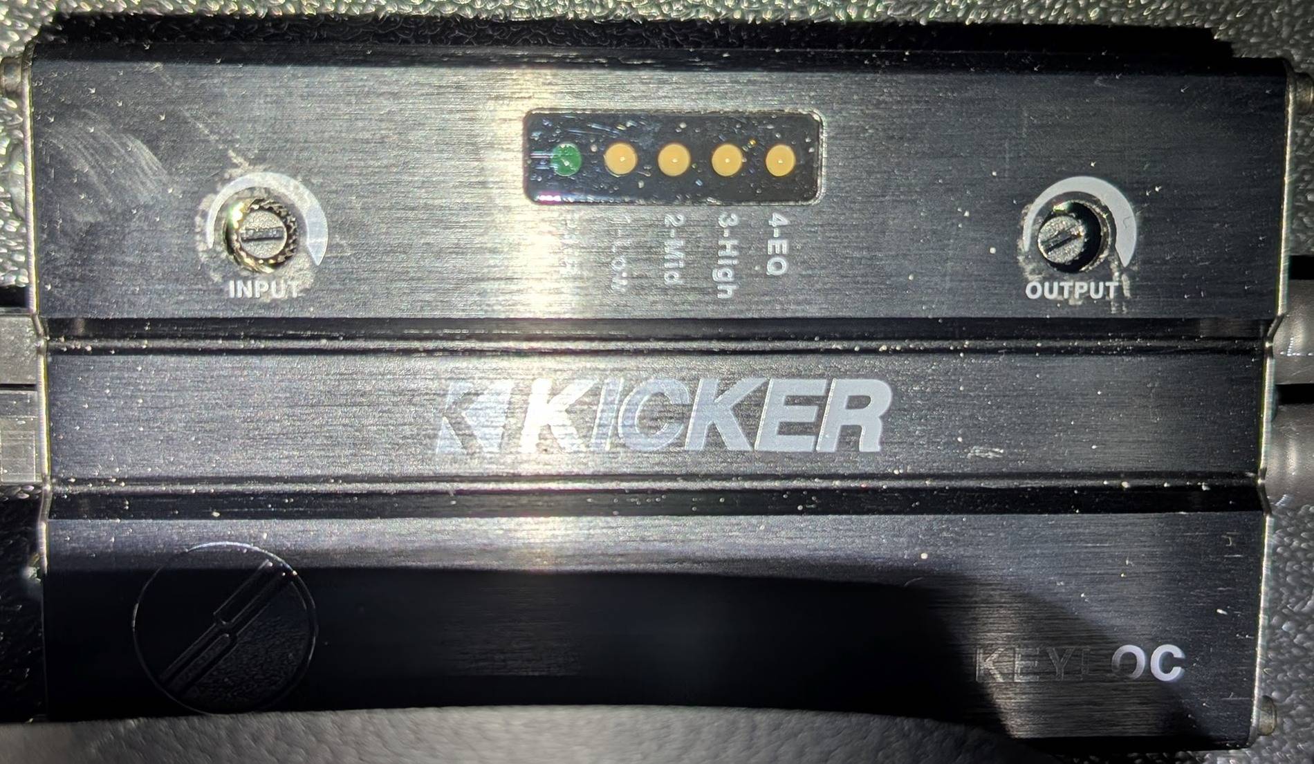

The KEYLOC from Sounds Good Stereo comes with the adapter cables, etc, but they also cover up the two dials on the KEYLOC. From the KEYLOC manual pdf, there is an input and output gain, I may take the stickers off and adjust the output gain down a little.
Could also just use a Key500.1. Has KeyLOC built in, sounds good makes a harness for it, saves like 200 bucks.

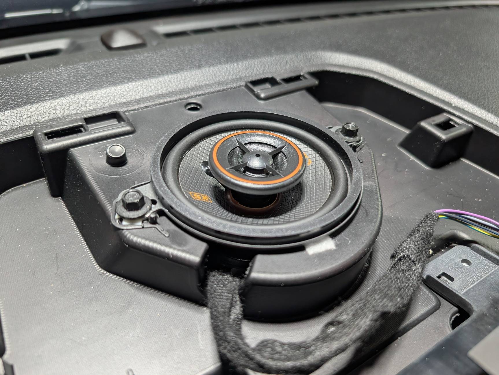

I updated the main post -- replaced the center channel speaker on the dash with a Kicker KSC350. Thanks to @GLW for the recommendation and wire polarity.
On the wiring from the plug, the solid white wire is positive and the multi-color wire is ground. I just dismantled the stock speaker to re-use the plug. It's held to the stock speaker with a rivet that pulls through the plastic bracket. You could also just clip the existing cable and wire it in.
The speaker fits best with the contacts towards the front of the vehicle, this let the speaker sit down in the cavity.
I took the cover stickers off the KEYLOC and adjusted the OUTPUT gain down about 50% from where it was. I didn't adjust the INPUT gain, and I covered these up with wiring harness tape to keep dust out.
OUTPUT gain is now at about 8 o'clock.
And on the ACM 1.300, after adjusting the KEYLOC output gain, I was able to adjust the gain and thresholds. All of them are set at about 10 o'clock.
With these settings, I was able to re-adjust the settings in the truck. I've now got Treble at +2, Mids at +3 and Bass at -1. Sounds fantastic and doesn't bottom out or get muddy.
