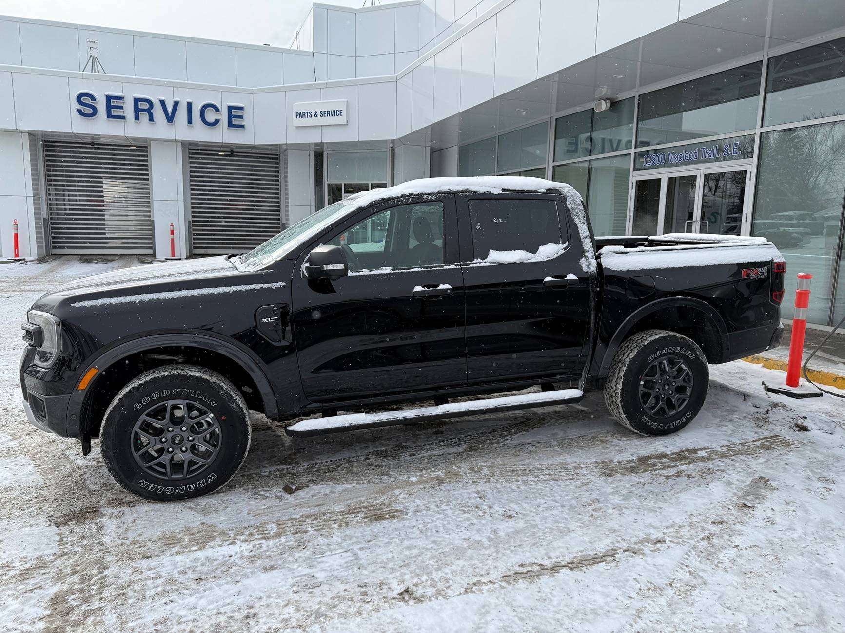

Thanks everybody for all your advice! I finally went to check one out today in person. Sales guy put me in a 2.7 xlt mostly to drive the v6 as he’s convinced it’s the better choice in engines. I had to agree after trying it. The whole vehicle felt so natural I didn’t even think about driving it. Right size, right height looking down on the road. I wasn’t a fan of the seats in the xlt, something I’ve become hyper sensitive to after my current car. The Lariat we sat in seemed much better. The tech is all first rate Ford. I’ll have to keep watch as to what they have coming up on their lot. While we could order, he did say he’d throw me one overnight as a loaner to truly see if it would work longer than he short city loop we did.
