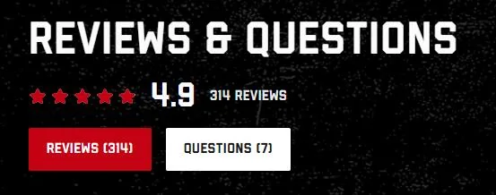

I dont think the Rough Country level kit is a problem. Maybe if you are doing serious off road EVERY day. But to me this is important:
Ford Ranger 2.5” leveling and tire advice 1743597401728-on
