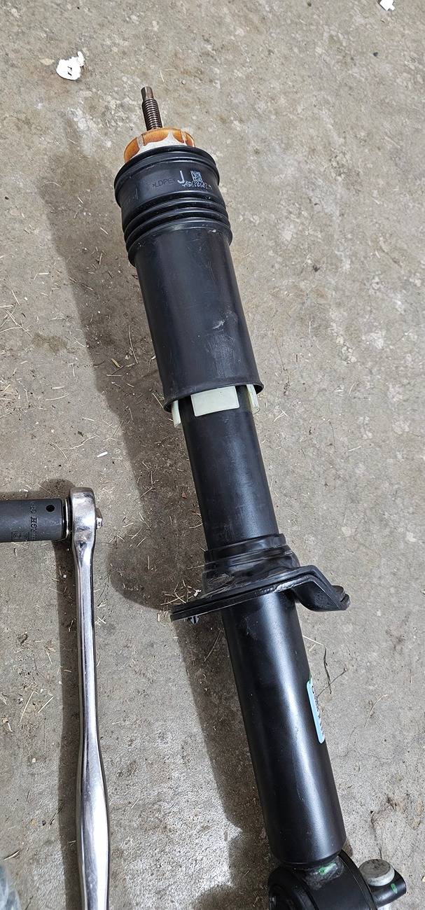

How hard was it to swap everything to the new struts? I just ordered a set of those bilstiens for mine.
I got it done in a night. I had to fight with the bump stop to get it off, I ended up using a puller device to pop the retaining ring off the top of the strut piston that wouldn’t allow the bump stop to just slide off, but that was the only thing that really slowed me down.

Did you have to use a spring compressor to swap it over to new strut?

Okay, so I get the top hat and spring off, how dl I disassemble the factory shop to get the bottom plate off?
There's a little metal ring that prevents the bump stop from just sliding off, you'll have to remove that with one of those two or three-arm pulling devices, should come off very easily with the puller. That white plastic piece is just friction fit onto the shock body, I got it off by just ramming the bottom plate into it like a slide hammer till it came off.
Got it done yesterday, installed the struts at the same setting as yours turned out well. Did you have to get an alignment?
