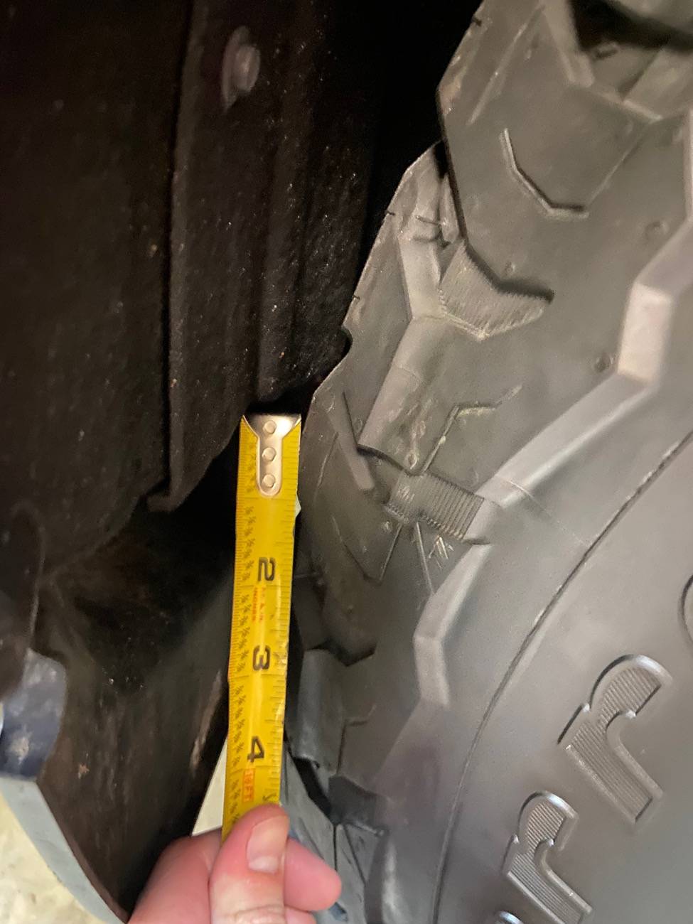

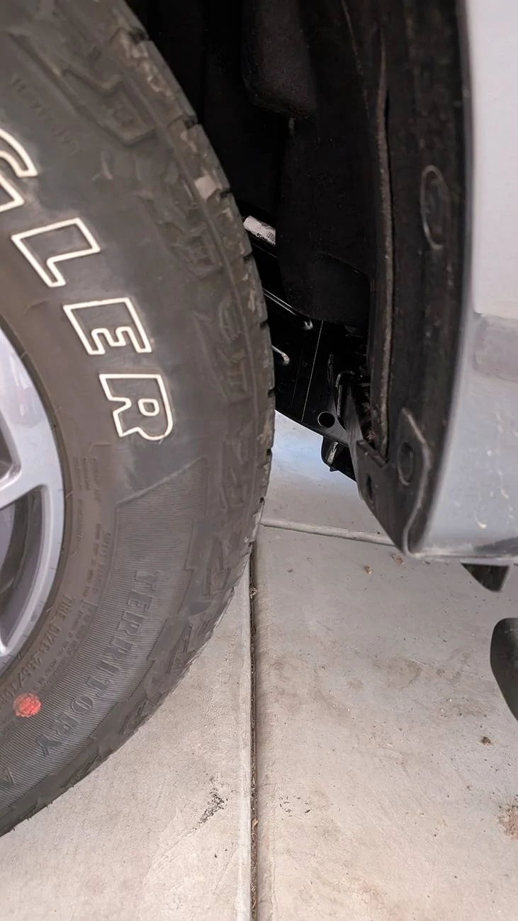

Have you happened to notice how much extra fender clearance you have with the wheels turned? You're at 32.8X11.5, I'm wanting to verify that a 33.2"X11" tire would fit. Its not a huge difference, but you never know. To me it looks like there's significantly more than an inch of extra space, but pushing the weel further out and going with a wider tire will also have an effect.
The 285/70s certainly take up a bit of room, but even out on the trail this last weekend I did not run into any clearance issues. I imagine the 33.2’s would be fine. You’ve got probably another 1/2” by removing some wheel well liner before you’d be touching the crash bars anyway! Here’s some pics:

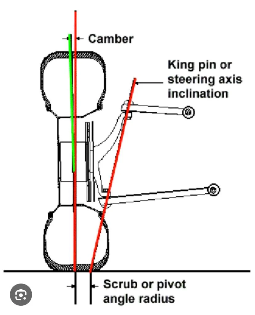

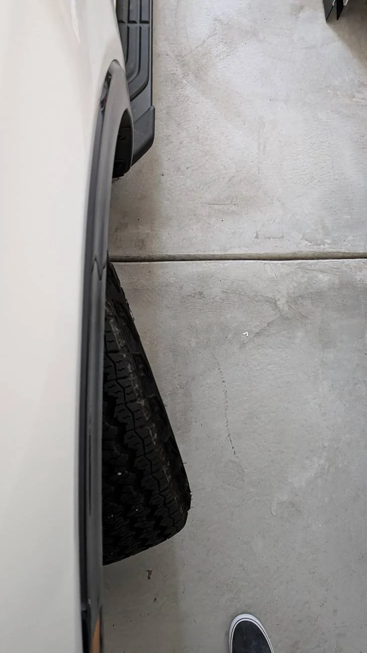

One more quick question, love the bronze wheel, but I'm possibly looking at the Method Double Black which only comes in a +25 offset. Do you think there is much difference between the +25 and +35? I know there would be some more "poke", but didn't know if with that tire size if it would cause any issues - rubbing, suspension, etc. Still trying to picture all this offset stuff. Thanks again!
Offset is just a measurement in millimeters, so +25 offset is 10mm (little less than half an inch) further from the centerline of the truck than my wheels. This increases the track width of the truck obviously, but since the extra width was gained by pushing the rim of the wheel further out from the hub you’ve gained scrub radius. Scrub radius is how close the center of the tire contact patch is to the point on the ground where the King Pin angle intersects the ground. Visualize the wheel pivoting (good) around a point on the ground versus swinging in an arc (bad) as you turn the steering wheel.
Ford Ranger 2024 XLT FX4 Ranger - New Method 703 17x8.5 +35 offset w/BFGoodrich KO3 285/70R17 tires IMG_1702
Lots of scrub radius is bad for handling. so generally want to stay as close as you can to the OEM offset spec. +55 is OEM offset, so +25 would be a gain of 30mm (1.18 in.) in scrub radius, but likely would be tough to notice much difference in steering. +0 or negative offset you would likely notice a difference in vehicle handling.
I have the slightest bit of rubbing at full steering lock in reverse with the +35, so that would also be more rubbing with the +25. Nothing some trimming can’t fix tho!
Lots of scrub radius is bad for handling. so generally want to stay as close as you can to the OEM offset spec. +55 is OEM offset, so +25 would be a gain of 30mm (1.18 in.), but likely would be tough to notice much difference in steering. +0 or negative offset you would likely notice a difference in vehicle handling.

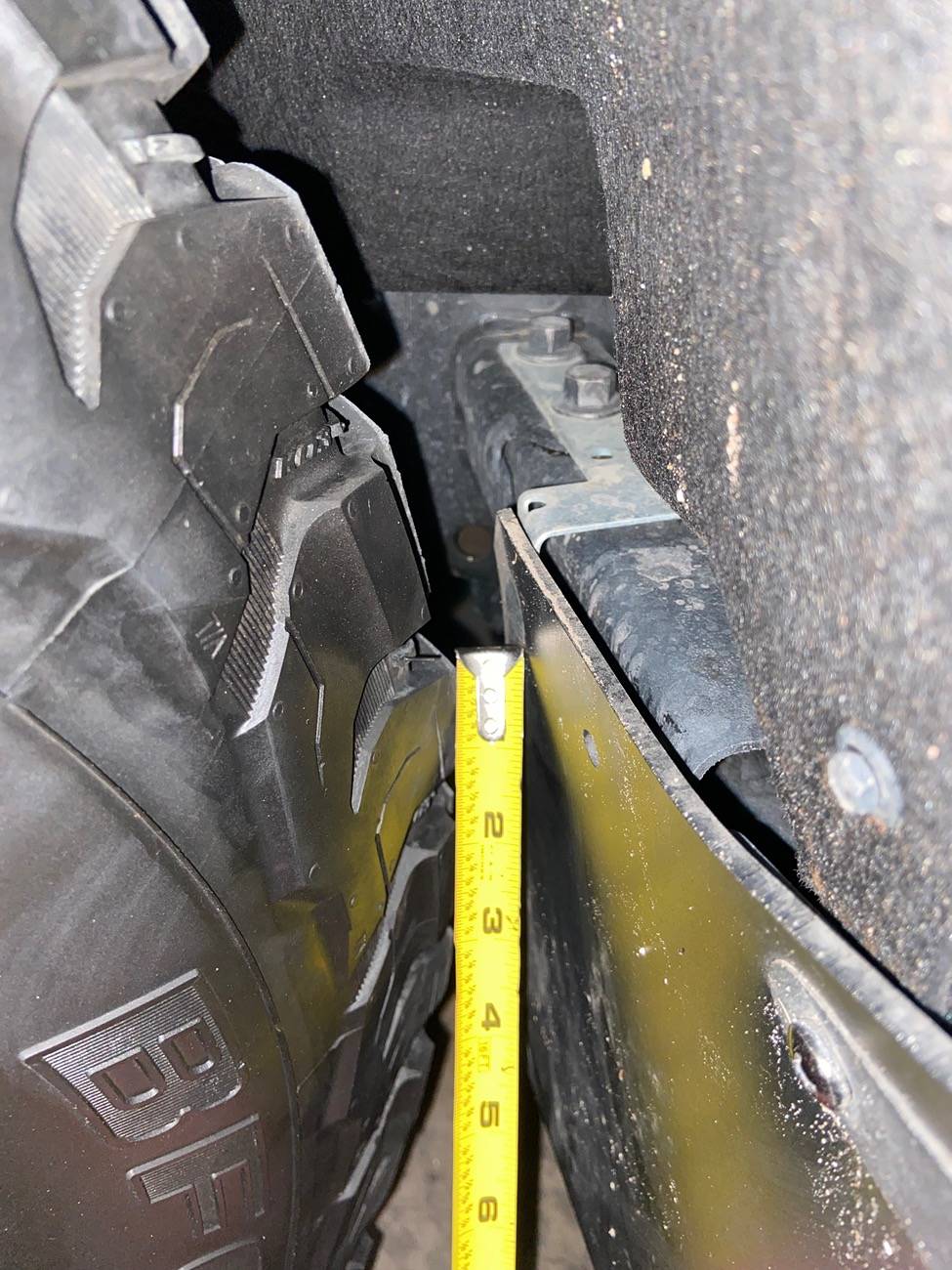

Thanks! Your setup is exactly what I'm looking for. However, I do like those Method Double Black wheels. I'm basically trying to avoid any Intrusion (crash) bar work. Not sure I want to cut those things. Also, I'm sure it voids some kind of warranty then there is insurance if something were to happen - "Well, you replaced/removed/cut your crash bars". Lol. Thanks again for the explanation.
I think you would clear the crash bar still, it would just be some wheel well liner getting scuffed.
I don't know what insurance would say, but that sounds like something they would do haha. Safety wise, I wouldn't have problem removing the bars since the ROW rangers don't have them to begin with from what I've seen and neither do the Sasquatch Broncos.
