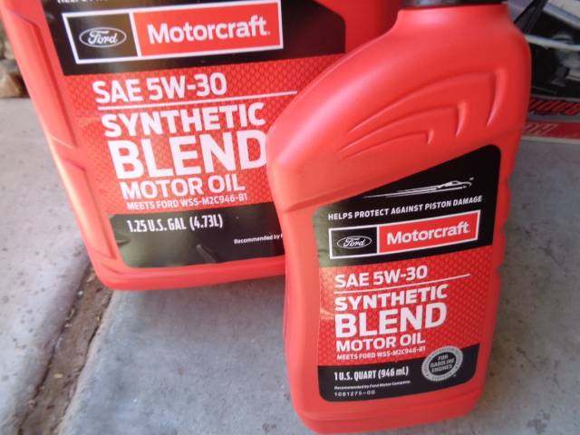

MOTORCRAFT SYNTHETIC BLEND!!--Specified in the owners manual
Ford Ranger What oil will you be running after your 1st oil change? DSC03788.JPG
Actual the owners manual states that Motorcraft Synthetic Blend is recommended... what it specifies is an oil that meets WSS-M2C946-B1. There are a lot of oils that meet that specification.
Motorcraft Synthetic Blend isn't the best choice when looking at a variety of tests.
More here

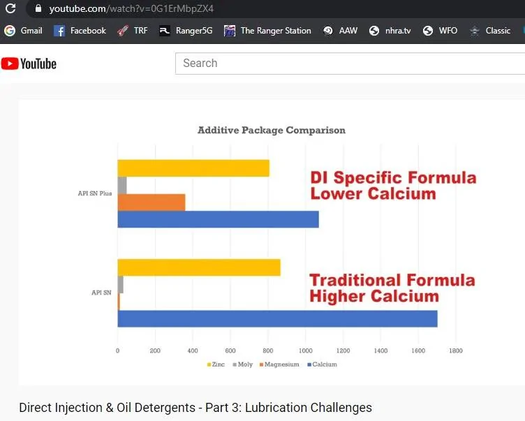

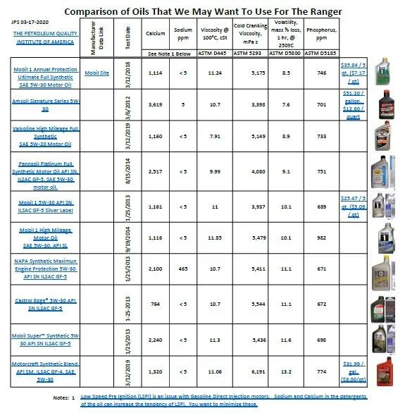

Amsoil oil and filter.
Only have 540km on the Ranger. After the break in I will be putting AMSOIL Signature Series and an Amsoil filter.
Amsoil has an insane amount of calcium... and that's not a good thing for GDI engines...
Something around 1,000 is good... it has over 3,600 :shock:
Ford Ranger What oil will you be running after your 1st oil change? 2020-03-24 Test Data
Ford Ranger What oil will you be running after your 1st oil change? Sodium and Calcium
Amsoil’s 5W30 Signature Series has 1300 ppm of Calcium and 1000 ppm of Magneseum to meet Fords Specs for the LSPI Motors.. It’s a requirement from Ford in order to be able to recommend an oil to make sure the right protection is there and warranty approved.
