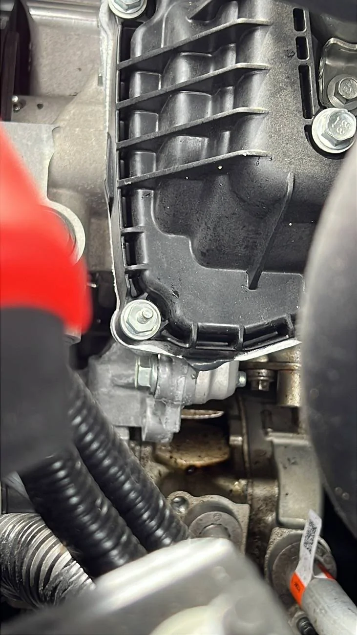

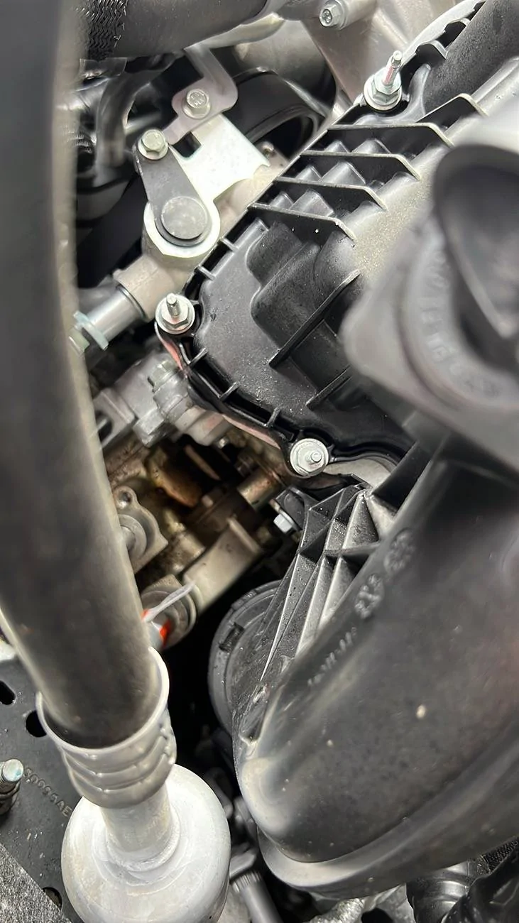

Hard to see with my crappy pic but this is the line going into engine. I first noticed there was less of a flush fit gap on the front side of it vs the back side of it. It actually stood out because I felt like I could catch my finger nail on the front but not the back before I even realize it was the leak point. I have to assume the o ring would be right there wouldn’t it? Wondering maybe the o-ring kept it from being worse vs a failure point on this one.

Likely, the O-ring prevented a major leak.
As far as being loose, they probably mean the bolt fastening the flange of the fitting. Maybe a minor issue with the bolt not getting torqued or Loctite and slipped through QC for that sequence of operations at the engine plant. This is why fasteners typically have paint marks to indicate the original orientation at manufacture. It's difficult to poka-yoke every facet of operations in manufacturing.

Yeah that makes sense. It kind of aligns with what I saw personally. The way the gap was on the front end seems to make sense with it not being torqued to spec. That o ring may have saved the day.
