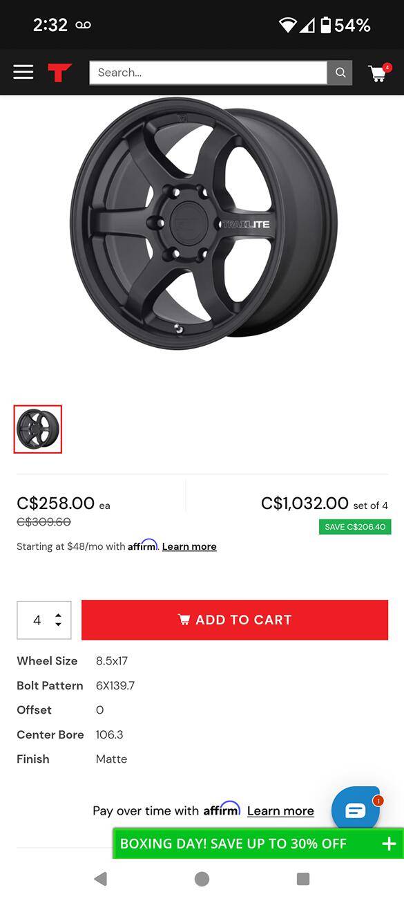

I've read every thread here that even vaguely mentions offsets and don't have a definitive answer. So let's get right to the point.
Can we run zero offset wheels on an otherwise completely stock truck? No suspension mods, no cutting, no trimming.
Is anyone running zero offset wheels currently? If so, what width are they?
I really want a set of Motegi Trail Lites in 8.5" 0 offset, I don't want to settle for +18 if I don't have to.

Yeah I've seen that thread. I wish the pictures showed how much poke there is better.
Do we know that the wheel is 9" wide? I asked but the OP of that thread never gave an answer.
OP also mentions plans to remove the crash bars as things are very tight. I'll be honest, I don't know what people mean when they talk about removing the crash bars.
Edit to add: Just Googled those wheels. Seems they only come in a 17x9, et 0. So that is somewhat encouraging. An 8.5 would have 6mm less poke. Not much at all, but something.

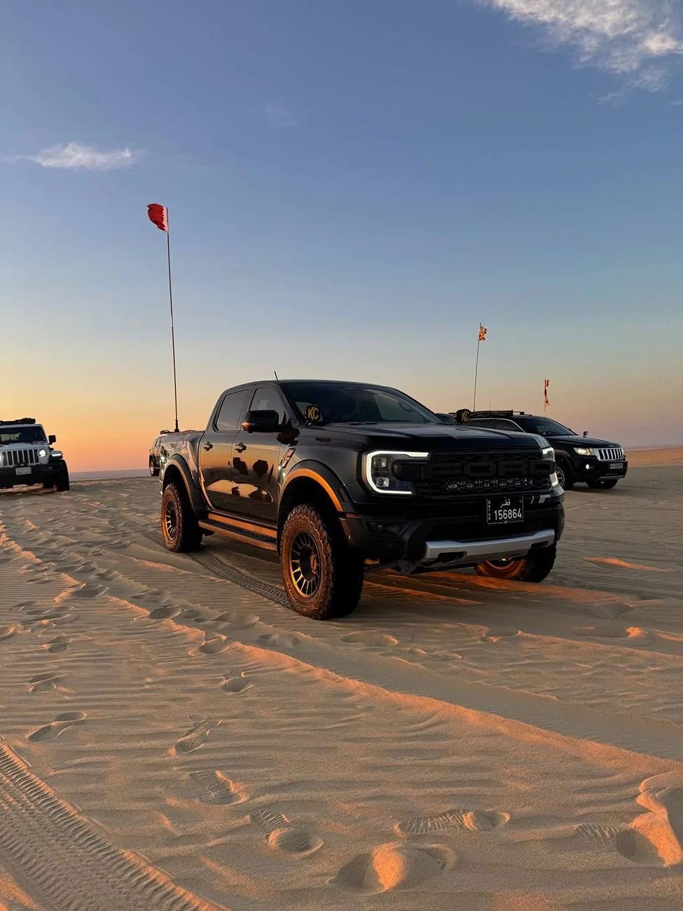

I’m running zero offset method 707s with stock tyres and offroad hard.
There is some minor rubbing at full lock on the mud flaps but nothing of any concern.
