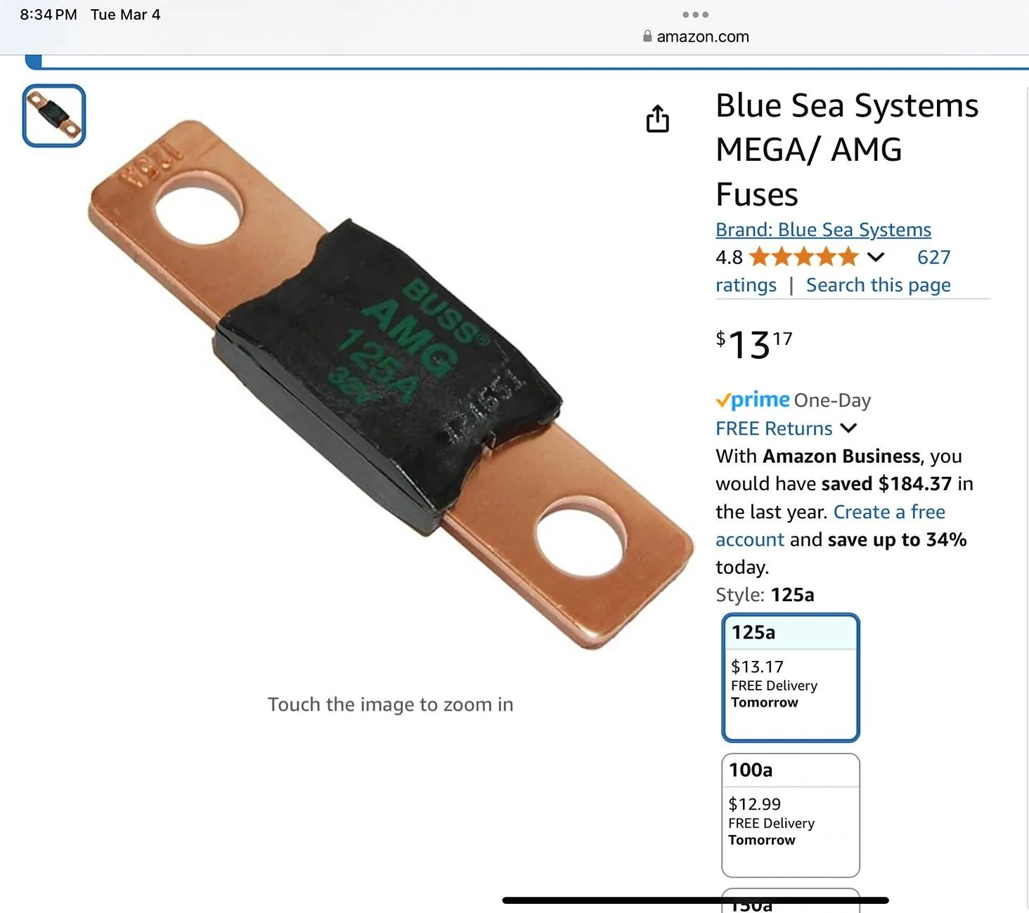

I want to add a 24” FUSED 6 AWG cable with a 120 amp or 175 amp Anderson connector pair at the end, to connect a powerful portable MORRFlate TenSix compressor that draws 90 amps start, 50 amps running.. I don’t see any way to clamp on those huge alligator clips.

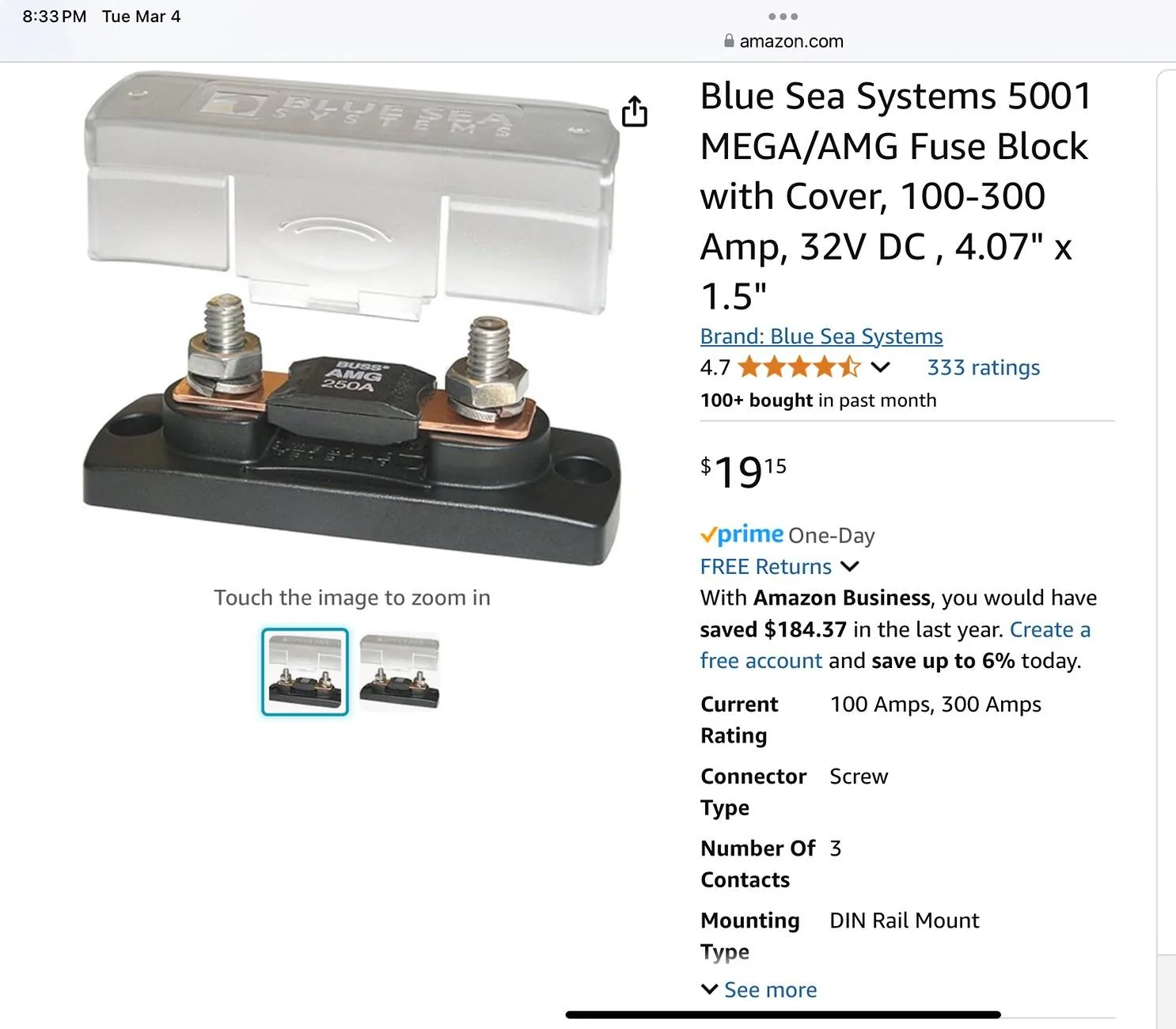

I have wired an RV with a Blue Sea Mega Fuse holder with cover, but that gets pretty bulky and needlessly complicated for a truck.

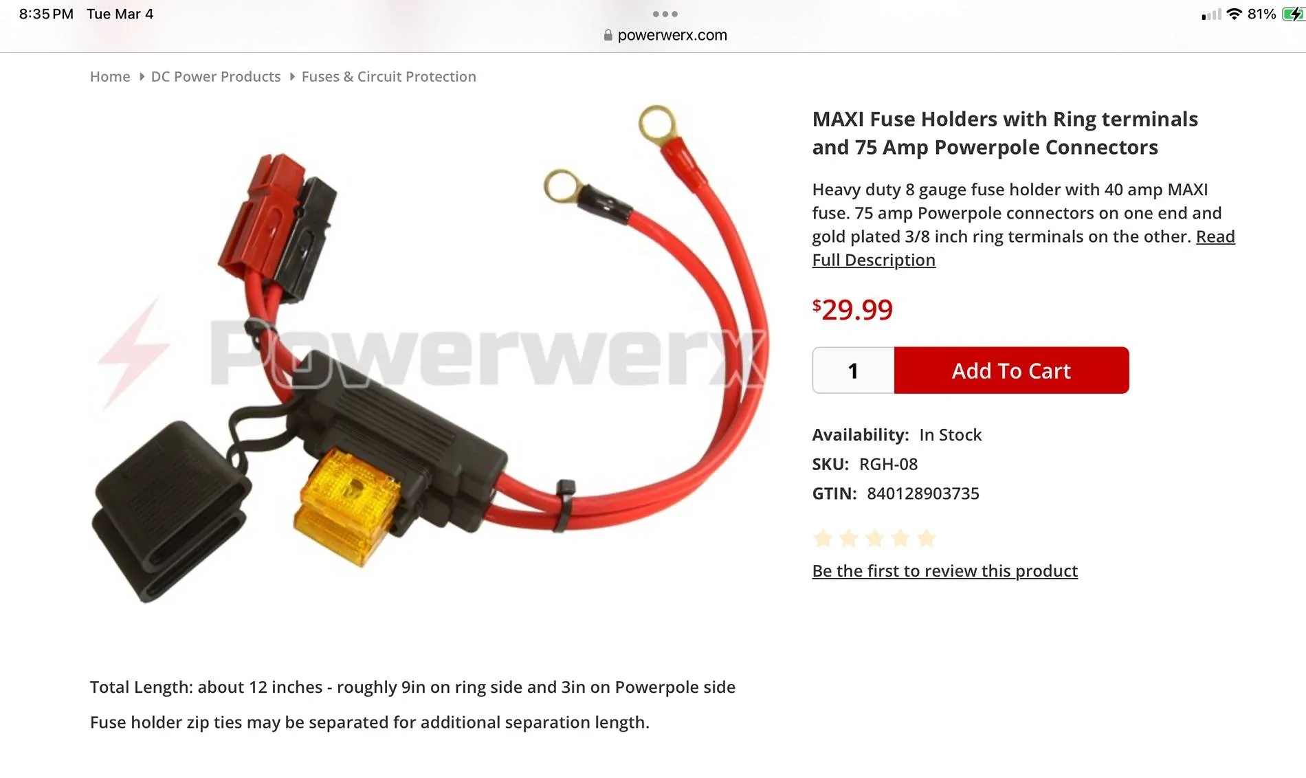

I was hoping for something simple like this but with bigger cable and fuse. Would a winch company have one?

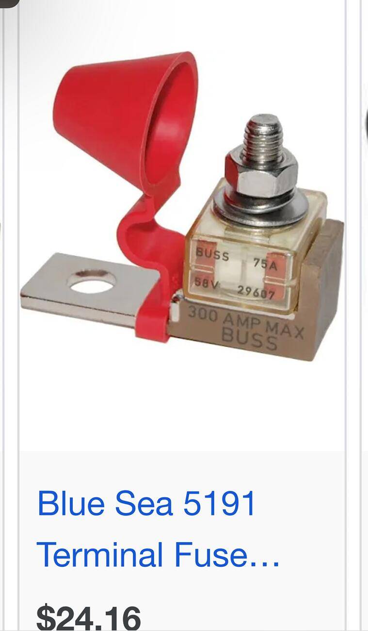

Not sure if this addresses your question but I wired straight to one of those side terminals (on the right). I used one of those large fuses that stacks vertically between the stud and the nut. Like this below. (Been using for about 6 months or so now issues)
Ford Ranger RR: How to disconnect the battery Positive cable? And connect a fused 120A Anderson cable? 1741199315379-jm
i use this for my arb dual air compressor mounted in the fender wall

I have used those before on an RV, to protect the hot wires coming off a pair of lithium batteries, and I quite like them, Blue Sea stuff is top quality marine grade. it is an elegant solution, did you have to cut away the red cover, and do you think the stud is OK in terms of height? It has a 3/8” terminal hole, that is a little large, Can you post a pic of your installation? Thanks,

I bent the solid straight portion of the fuse over to make it a 90° angle and then just made two small vertical slices on the red terminal cover so that it bends around it a little bit. Love the blue seas stuff i use a bunch of it. Ill have to take a picture when i get a chance i just checked and dont have one. The screenshot i sent is probably not the exact one i used.

Just checked my past order i used a 60A one and it has a 3/8” (m10) mount for the battery side and is suited for a 5/16” ring terminal on the accy side (on top of the actual fuse).
even if the battery side is a bit large the flange nuts that are already on there do a good job of holding it down and making good contact imo.

I'm running the MORRFlate TenSix compressor as well, except I ran 4 AWG high current cable to an SB 120 (120A) anderson plug mounted in the tub power panel. I used a 100 amp MIDI fuse and holder (like the Blue Sea in your photos) from the battery to a 100 amp relay, connected to my AUX 6 switch. That way it's not a live cable all the time.
