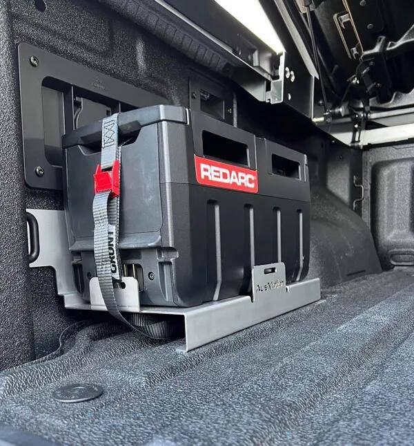

As others have suggested, the best option may be a portable power station type solution in the bed - We have a big range of mounts for those and could create one for you (we ship to the US).
Here's the one we do for the Redarc Go Block.
