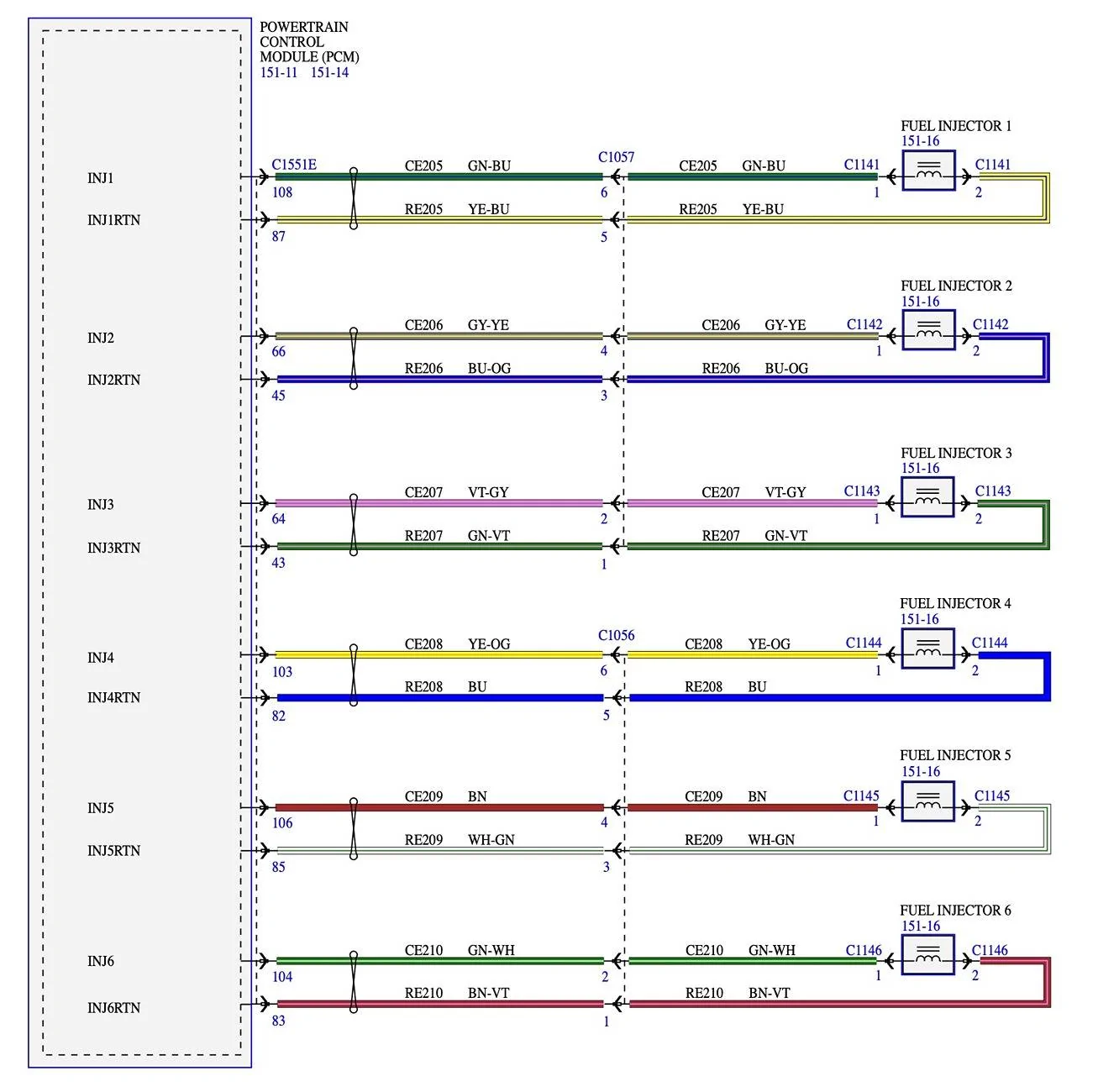

The 2024 Ranger Raptor 3.0L Ecoboost is direct injection only. The wiring diagram manual shows only six direct injectors, whereas an engine with port and direct injection would have a total of twelve injectors, six for direct and six for port. A physical look also confirms this.

But are you sure though? It could be they just forgot to put them in the wiring diagram. And maybe you just can't see them because Ford did such a good job hiding them.
Oh, (insert sarcasm).
Case closed, Johnson!

Well, imo, that sort of sucks the 3.0L is direct injection only. That means future additional maintenance will likely be needed to clean the carbon deposits off the valves since no fuel with cleaning additives ever hits the valves. As I understand it, that involves removing the heads and walnut blasting the carbon deposits off the valves, usually by around 80-100k miles from what i've read

Thanks for the reply. Looks like you are from Kenya? I should have specified, but I was looking for confirmation on a US spec ranger raptor. The specs for the internal RR have shown direct injection only, but the US RR spec sheet shows direct and port. Can one of the lucky few that has already received their RR take a look under the hood?
I will be honest shame on Ford if they have let a typo persist this long and trickle down to all of the online reviews...

Yes I am from Kenya. Screenshot is actually from the manuals on the USA site, and matches my VIN specific ones as well. Marketing sheets had also mentioned a dual port fuel injection system as does the Ford training manual, but I am 99.9% sure there are direct injection (GTDI) in the NA market too.
