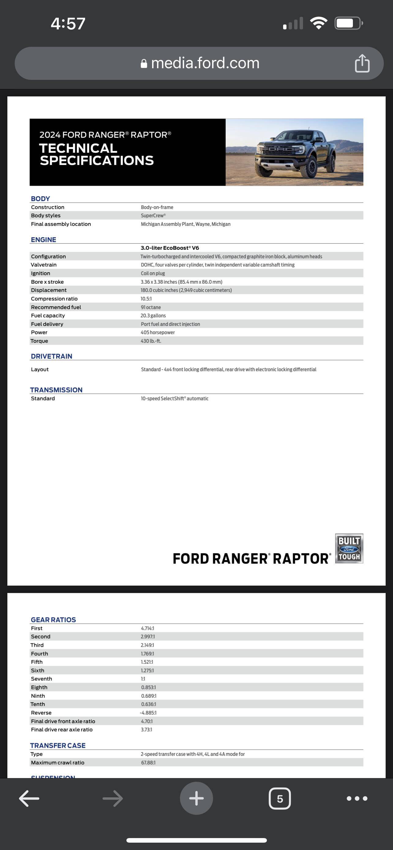

Searching through the internet and finding some mixed information on whether the upcoming Ranger Raptor engine 3.0L TT will have direct injection or both direct/port injection.
I know it’s basically the same engine found in the bronco raptor and explorer ST, but those are only direct injection.
This technical spec from Ford shows both direct/port injection.
Any intel on whether ford worked on the 3.0L TT engine and added port injection? This would actually be ideal as I’ve had GDI and the power loss after several tens of thousands of miles was noticeable from carbon build up.

That's 100% an error. This forum has found more than a dozen errors within the publications for this model. The 3.0 EB is direct injected. The only EB engine I'm aware of with dual direct/port injection is the 3.5L Gen 2 that's in the F150 Raptor and Ford GT.
A decent true catch can from a reputable brand will make the issue negligible. Not all catch cans are created equal.

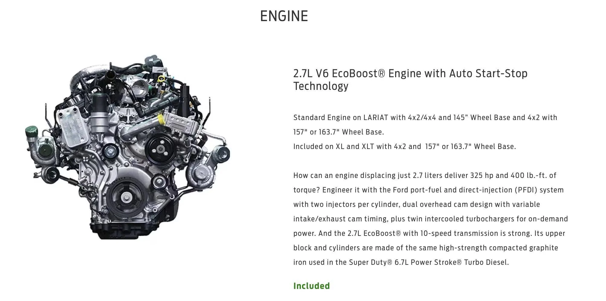

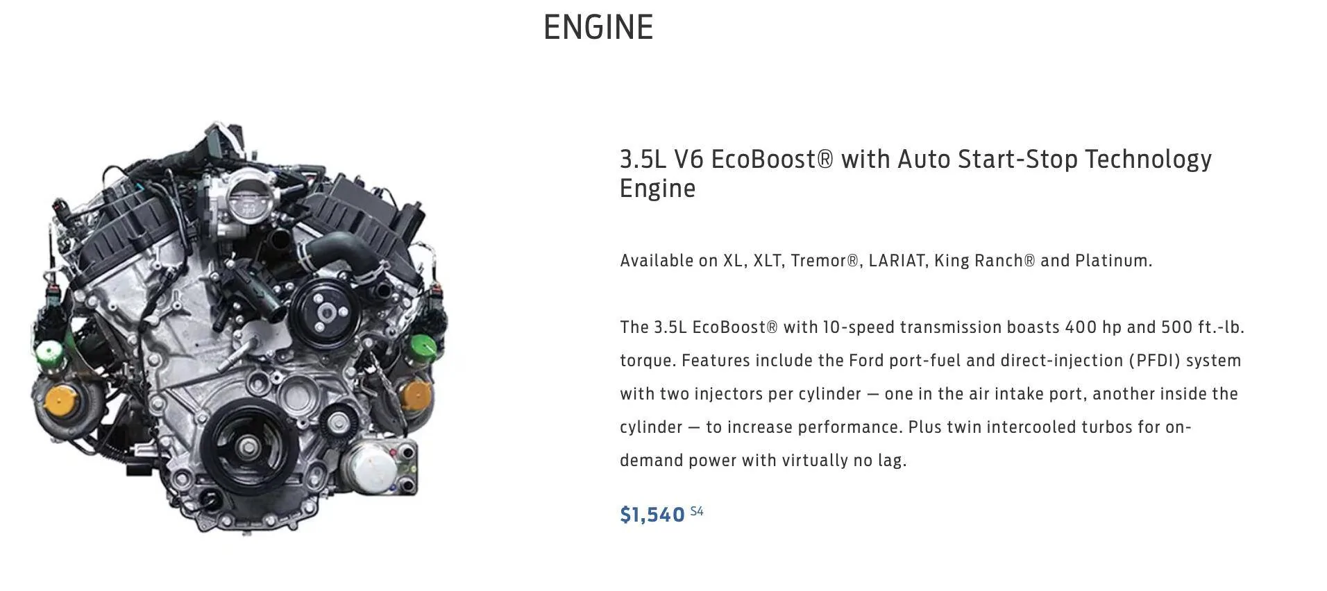

Im pretty sure the 2.7 and the 400 hp 3.5 in the f150 are dual injected.
Ford Ranger Ranger raptor engine GDI vs port and direct injection Screenshot 2023-06-09 at 9.17.04 PM
Ford Ranger Ranger raptor engine GDI vs port and direct injection Screenshot 2023-06-09 at 9.16.38 PM
Thanks for the info. Yeah it appears you’re correct. The second Gen 2.7L came out right after the second Gen 3.5L with some of the same improvements like the addition of port fuel injection. It’s in the F150, Bronco, and the upcoming Ranger.
