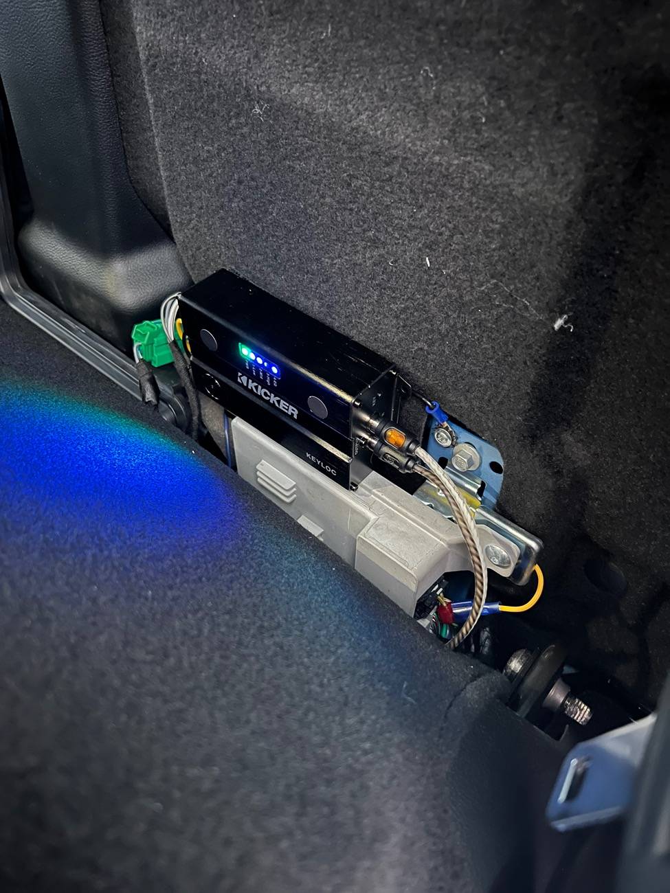

Did you replace the sub? Has anyone tried upgrading the speaker?
I did. I added an amp and a sub under the rear seat. Bought a plug and play harness. Sounds amazing
I have all the links if you’d like them.
Reactions: DMC
RRaptor24
Bubba
Mar 25, 2024
Prius
Crane Operator 😜
Please do on the links, thx
This is the sub enclosure
https://www.ebay.com/itm/1926103196...-aneEvjQ1K&var=&widget_ver=artemis&media=COPY
this is the sub I got and it fits and sounds fantastic
https://volunteeraudio.com/product/hertz-mps-250-s2
This is the plug and play adapter, no cutting into wires and comes tuned and set with the kicker keyloc. I picked the option to get rid of the factory bass roll off.
https://soundsgoodstereo.com/produc...-o-including-unleashed-read-description-below
As for the amp, you can pick any brand you want, if you’re only adding the sub you will need a mono amp with a RMS of 600 watts. The kicker amp I used has is a 800w amp which pushes this sub perfectly. But I’ll attach the link to the amp I used, I like this amp because it has a Bluetooth bass knob so you don’t have to run a remote wire.
I had it installed at a custom stereo shop, they were ranting about the ease of the install with that harness and the quality and sound of the system
https://a.co/d/aWzJ4E1
any other questions just ask

The Kicker LOC you ordered is for the round BO system?

Yes sir! It may not show for the 2024 model but the one for the 2023 is what I ordered.

Okay cool, I almost ordered the first one that was Bo unleashed for oval. Glad I checked with you first.
Is it the US Rangers that had round sub, and AUS had oval?

Apparently they put the oval in the Aus trucks.

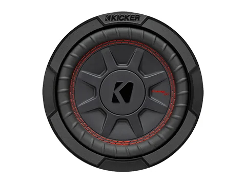

Do you happen to know the volume of the sub box? I was looking online to try to find that info to match a sub, but couldn't find anything...

I inquired with the seller of these enclosures, and this is what they said:
"Hey mate needs to be a shallow 10" as there is only 10.5liters volume. Also be careful what sub as the outer rim of the sub cannot be larger than 272mm."
So .37 cubic feet and 10.7" max outer diameter of mounting flange.

pretty small. I’ll be curious to see which subs get used. I’m thinking the Kicker CompRT would work well at a good value. Otherwise spending twice as much to get the JL TW3 or Hertz MPS 250 (like RRaptor24 did here). The Rockford Fosgate options out there look to want more volume.

I also was looking at the Focal shallow 10" sub as well (standard or flax) - both take min. .35 cubic feet sealed. I'm leaning towards the TW3 for dual voice coil.

I’m not sure the volume, but I will say that my Hertz Mill Pro 250 sounds amazing
