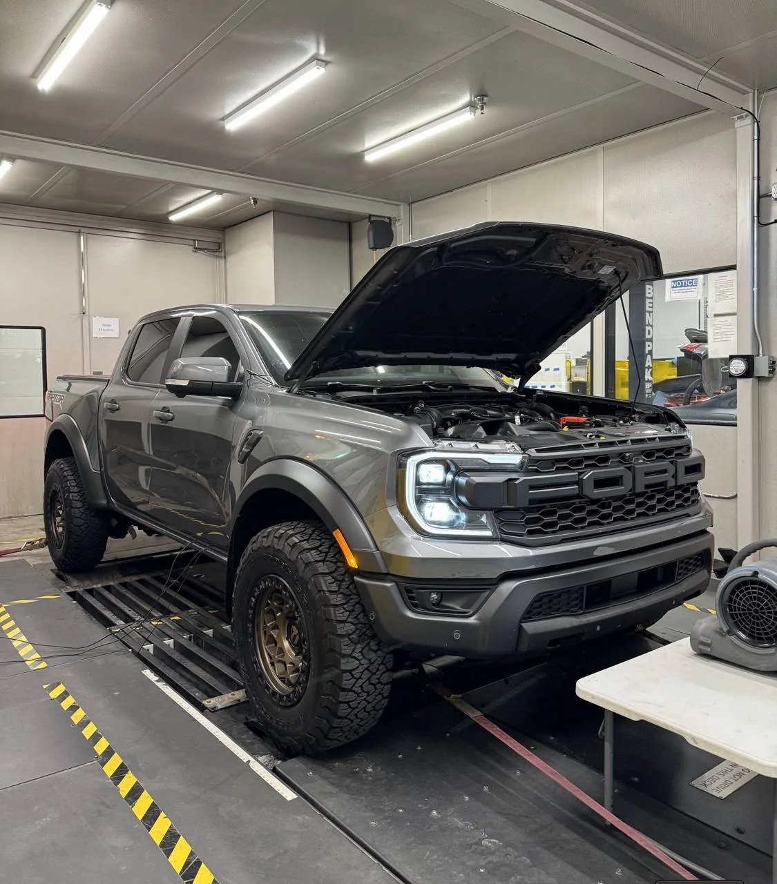

I’m limited by NDA’s, but yes a major company has prototyped with us. We should have everything released to the public before SEMA. I’d have more done but I’ve been busy with @NPTR educating me on how turbos work, tuning, warranty, aftermarket, what these trucks can handle, etc. I’m learning so much. It helped me figure out a completely stock RR running e85 can make 471 rwhp & almost 500ftlb torque. ESSIM actually read e78. Fueling for 700rwhp
