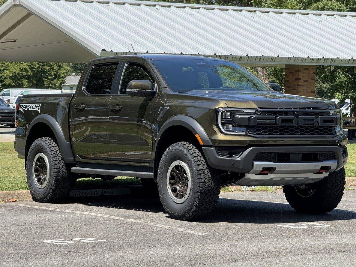

I believe I like the silver beauty rings from the bronco than the ranger grey beauty rings. Am I the only one?

They're growing on me. They don't match the fender flares very well, but as a friend pointed out, they match the stainless exhaust and the front lower fascia and belly pan. I'll probably leave them alone.

So essentially putting 35's on it? Do you know how much more ground clearance you have now?

This is exactly what I plan to do, but I’m going with Foutz or SVC 2” or 2.5 spring collar lift. 2” looks perfect to me, you still have a slight rake which looks best. Great work. Did you take any measurements before and after in the front.
