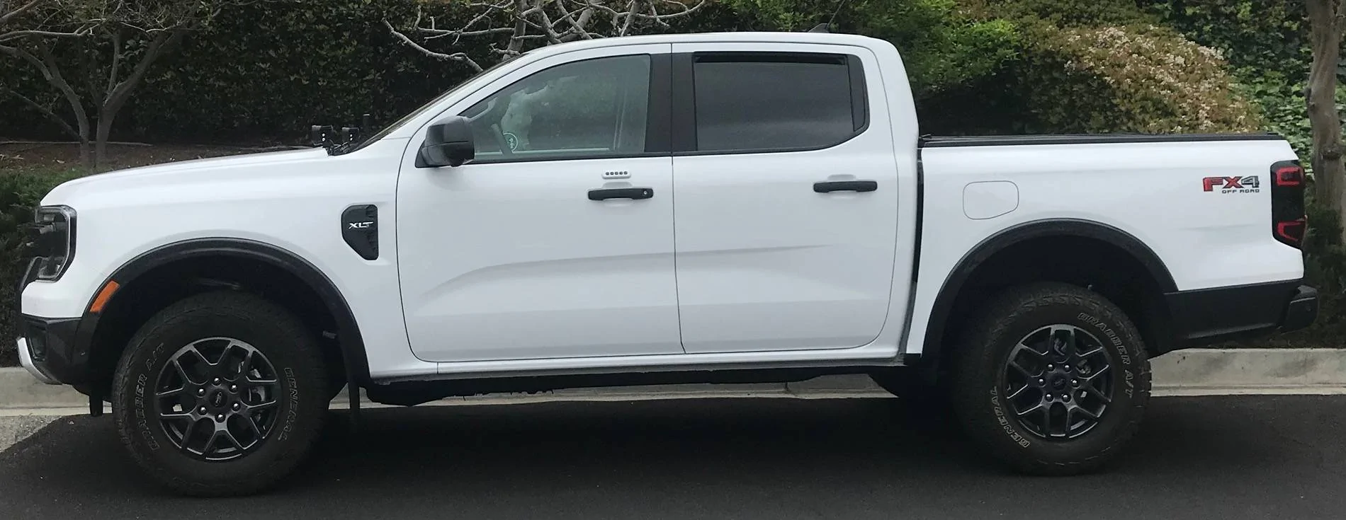

Great to hear! Any chance you could post pictures of it? I ordered mine and was debating keeping it around the 2.5” lift
Ford Ranger Level Kit Installation? C98522B5-18BD-43C6-BD7A-7C690BFE46C9
It still has a little rake to hitch the boat up, but at 2-2.5" should be level with no load.
