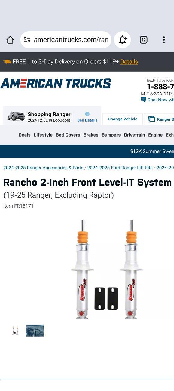

Anyone know if this kit is compatible with a 2024 XT Ranger, seeing different compatibility years listed on different retailers and the Rancho website has nothing listed for 2024 Ranger. They might get back to me on it wlfrom when I called but I'd rather not experiment even if the retailer guarantees fitment or refund. Any help would be appreciated-Thanks
Ford Ranger Rancho Level It RS66508R9 Suspension Leveling Kit fitment for 2024 Ranger Screenshot_20250424-150426

I'll be installing this same kit on my 2025 Ranger Lariat FX4 in May. The American Truck sales rep said it would work with all models 2019 to 2025, except for the Raptor. I'll post an update when they are installed.

I appreciate it greatly, I did talk with AT as well and I was told they at least guarantee fitment with regard to the purchase. It's just quite a task for me to do, and I would like to have as much info as I can get. I can say the gorancho.com dealer/installer list is pretty much not maintained although I did find one place on the list that quoted me parts and labor to get it installed with alignment if I wanted to go that way.
