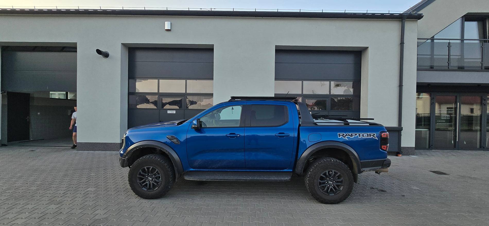

For me it is ok. More or less in normal suspension mode is like with standard springs in sport mode. Coming off the asphalt the suspension has to be switched to offroad mode, because on normal it is too hard. I have already done more than 50 thousand kilometers on these springs and I am very satisfied. Most of my rides I do on asphalt. Combined with the power from Bare with BPT is a must :)

I purchased a set of Eibach springs at a FORD dealership.
Ford Ranger Eibach coil spring level kit installed on Ranger Raptor - photos 20241006_221651
