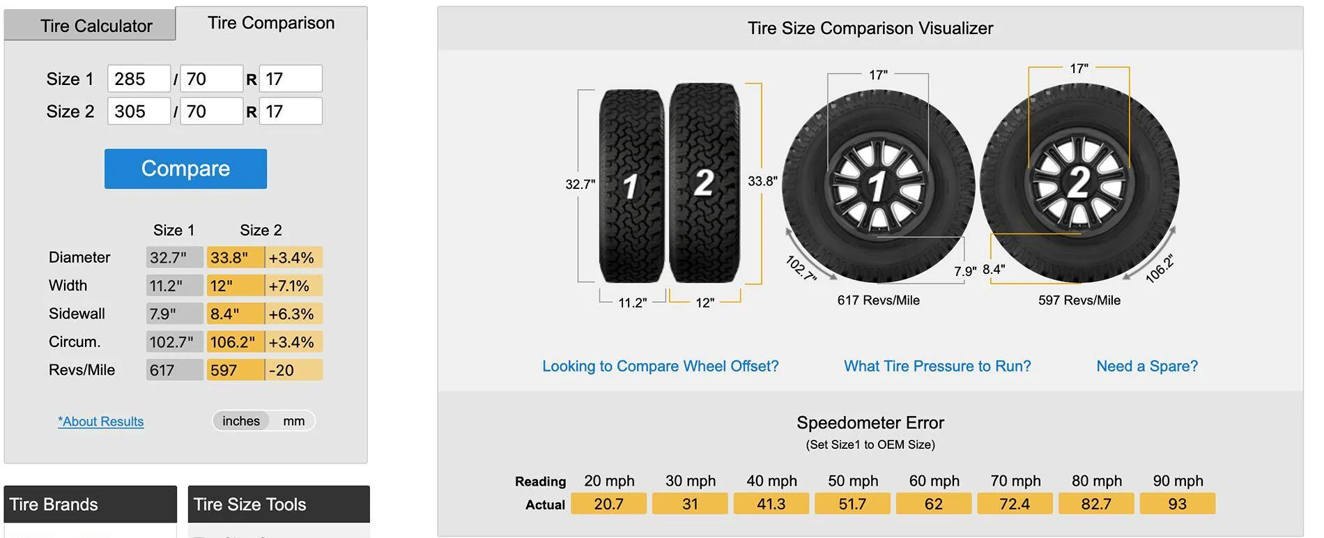

The larger tire is heavier, greater in diameter, and has more friction which will result in lower fuel efficiency.
That's all true. But as I read the question, he's not asking IF but by how much.
It seems to me that the only way to assess the degree of impact is to get feedback from others who have made similar changes. Then you're going from a wild ass guess to a minimally educated guess.

But you're not upsizing tyre? You're just going wider? 285/70/17 to a 305/70/17 is only 20mm wider, which means gearing isn't effected at all
Going to a wider tire also increases the tire height because the "70" in the size callout stands for the height of one sidewall being 70% of the width of the tire. So, 70% of 305 is greater than 70% of 285 (times two for two sidewalls) which increases tire overall height. There are calculators on tire dealer web sites that will calculate this for you if you don't want to do the math.
How it may affect gas mileage is a different story.
I suppose that reading the entire thread would explain my reply. One responder implied that only the tire width was changing which would be incorrect.
