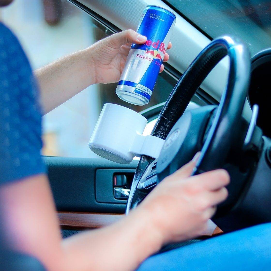

I used to try and get the weight/torque just right, but couldn't. I just got myself one of these bad boys. When you get the 'put your hands on the wheel' warning, you know your beer is low and it's time for another.
Is the tallboy required so it's the proper weight? 😜
