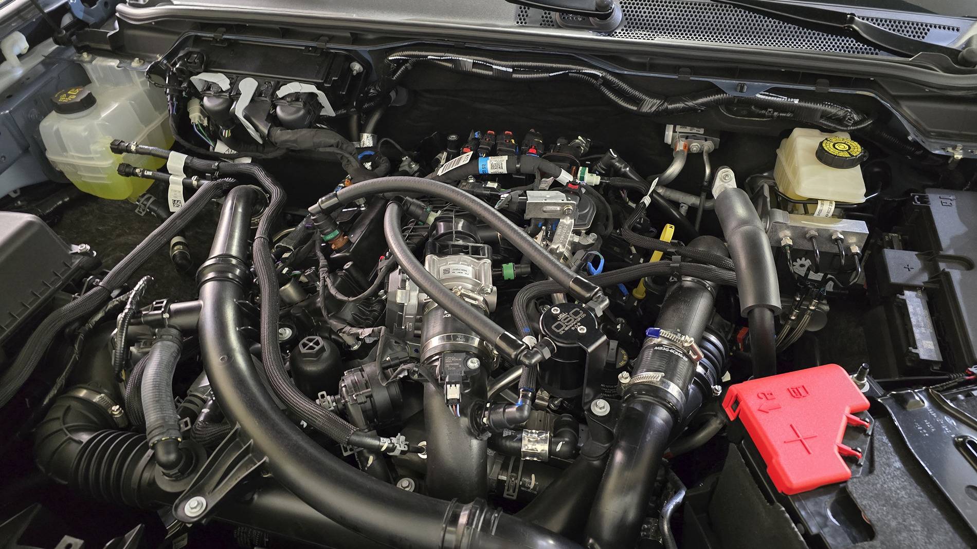

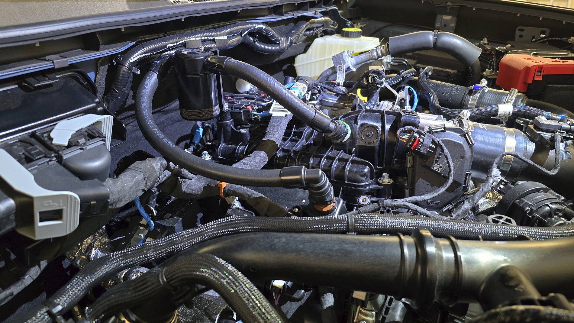

Based on information exchanged with J&L, they felt the 2.7 Bronco and Ranger could be a compatible fit. Emphasis on "could be".
In order for a perfect fit, I shortened the inlet hose by 4'' and the exit hose by 2''. I'm not sure why that is as the trucks look to be identical under the hood.
If you're not comfortable messing with a direct fit assembly, I would hold off until they release a Ranger 2.7 specific kit.
They're great to deal with.

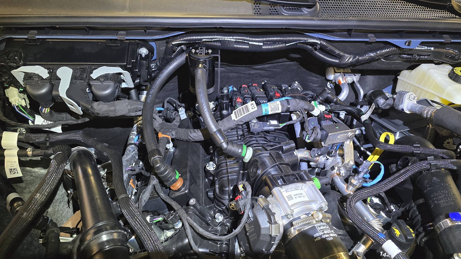

After having installed the J&L (Bronco 2.7) plug & play catch can I quickly realized that the location made checking the contents a pita.
J&L sent me new fittings and I went to work on relocating it. These guys are great to work with.
They need a donor vehicle to confirm fitment. Anyone in the Chesapeake, VA area with a 2.7 Ranger?
