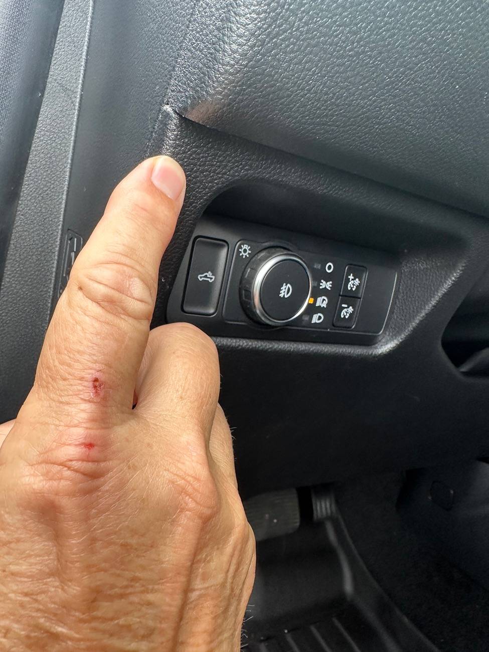

Finally found it. Left of steering wheel. Pull top corner and it will unsnap and fall downward. Also keyless code is located on card on fuse block.

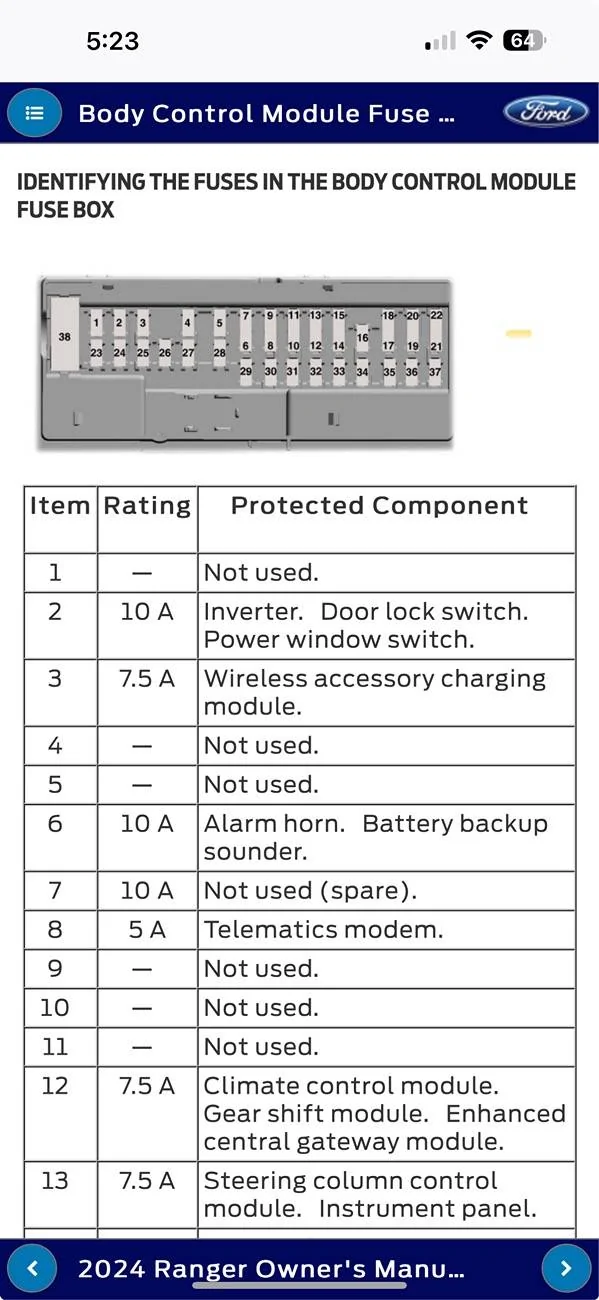

Picture by chance? What does it control?
