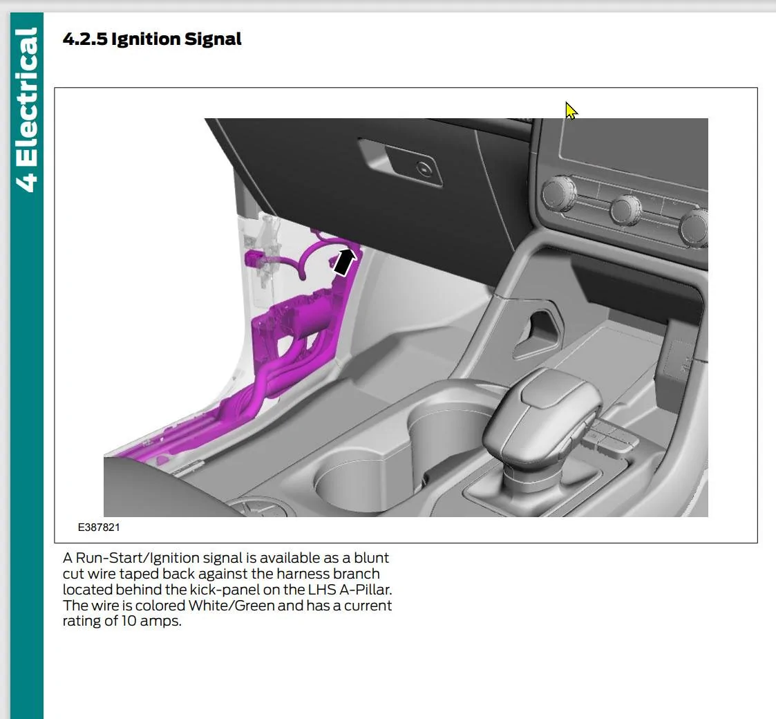

Passenger footwell if you want a live while the car is running... I used AUX 1 which is prewired. The std manual pg 324 onwards provides info of fuses/locations too. However, 139 looks ok anyway.
