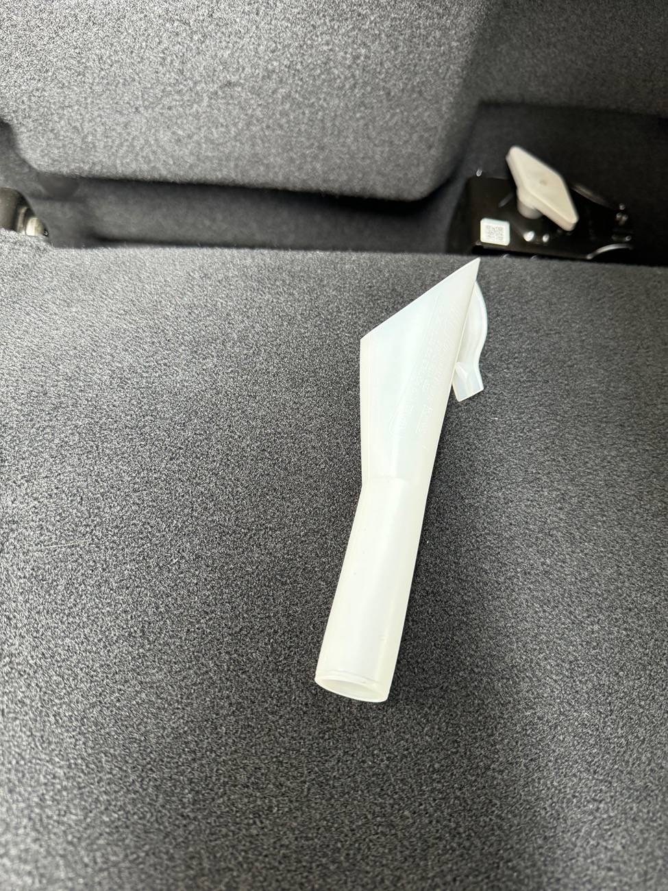

Yes, there are two clips on the left and right of the fule tube, and to open the actual fuel 'door' inside, those two clips must be pressed to the side for the 'door' to be released. Basically, you need a tube of the correct diameter like the gas station filler or the funnel behind the seat.

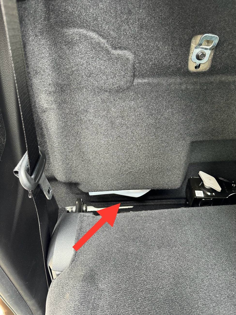

Mold maker
You have to use the white funnel that is behind the back seat by the jack.
I was wondering where they kept it in the Ranger. Thank you! I use it for jet fuel (STP Octane Boost)!!!
