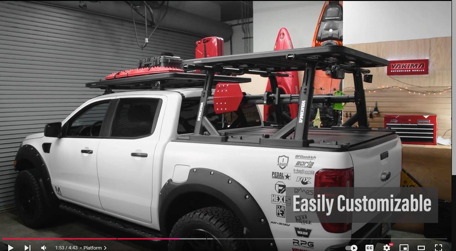

Good morning all!
I'm hoping someone can help me quickly confirm something.
Backcountry is having a 20% Sale that ends today or tomorrow.
I'd like to pickup a Yakima LockNLoad system to fit on an Overhaul HD system that I ordered as well
I would just like a sanity check.
I believe that the LockNLoad size I want is (Platform K) 55 x 49 inches.
This is my speculation since the bed is 59.6 x 48.2 inches.
The next LockNLoad size up would be 60 x 54 inches, and I believe it would hang over both in length and width.
I know this sounds like the answer would be obvious, I'm just seeking validation because I'd hate to get it and have to figure out how to ship it back.
Thanks!
ps. Something like this is what I'm going for

Hi, I 've done same ie. yakima towers + hd bars on bed, and hd bar on roof.
Now instead of unstalling 2 seperate platforms, i would like to add only one yakima H ot C platform along both support (bed and roof).
Do someone already tested this configuration?
Thanks a lot.

Oh, I think I get what you are saying.. you want a single long platform to go across the Yakima bars above the bed and the roof.
Check these videos. Not exactly what you are looking for, but perhaps it helps in piecemeal.

thanks for sharing videos.
my trunk is already configured as first video.
Anyone experiencing this customization?
What about stability of such installation ?
