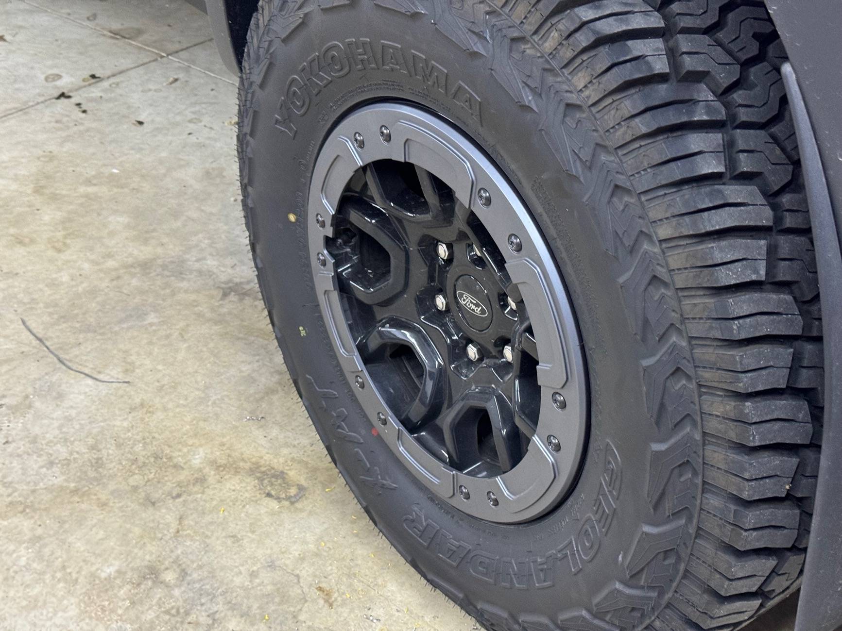

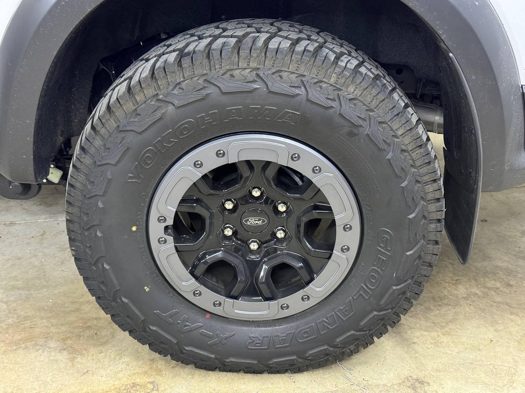

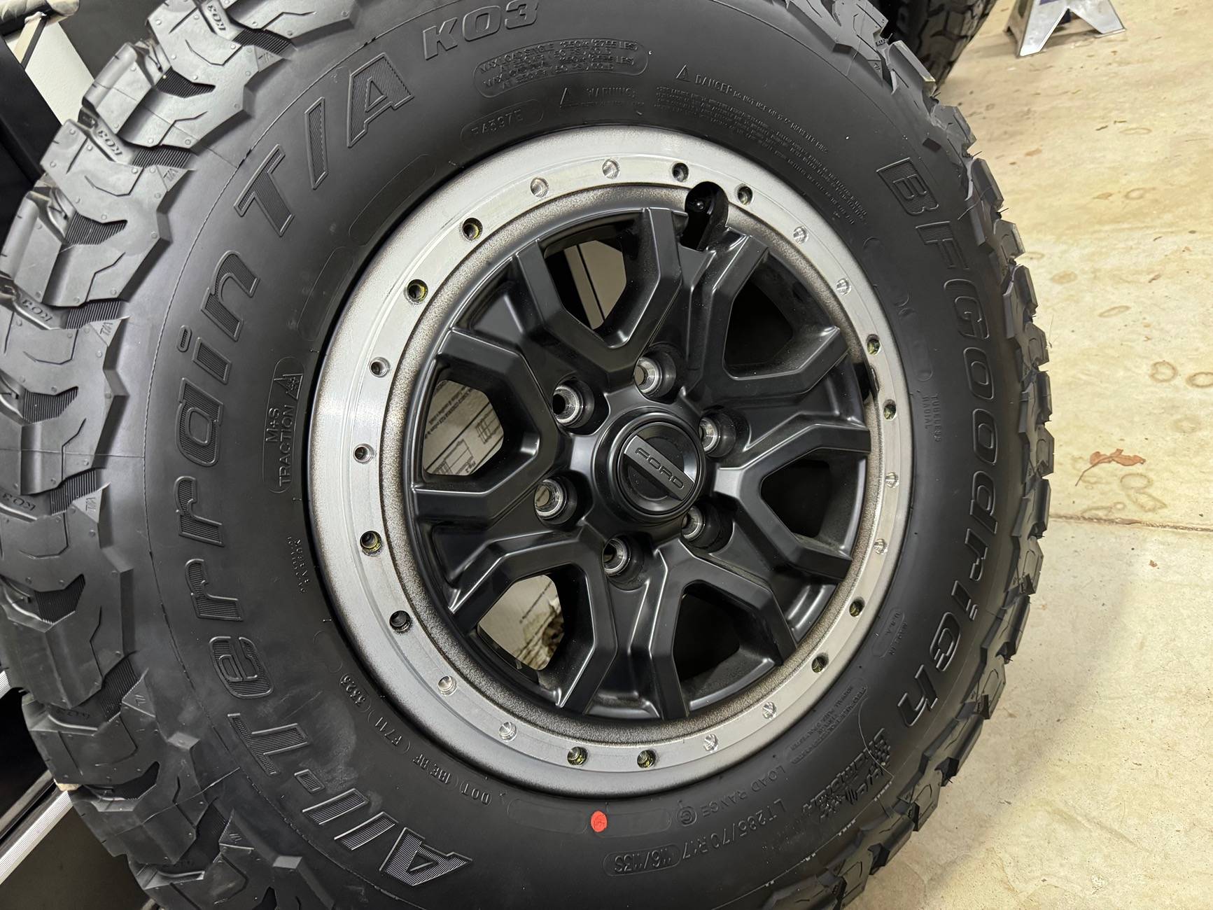

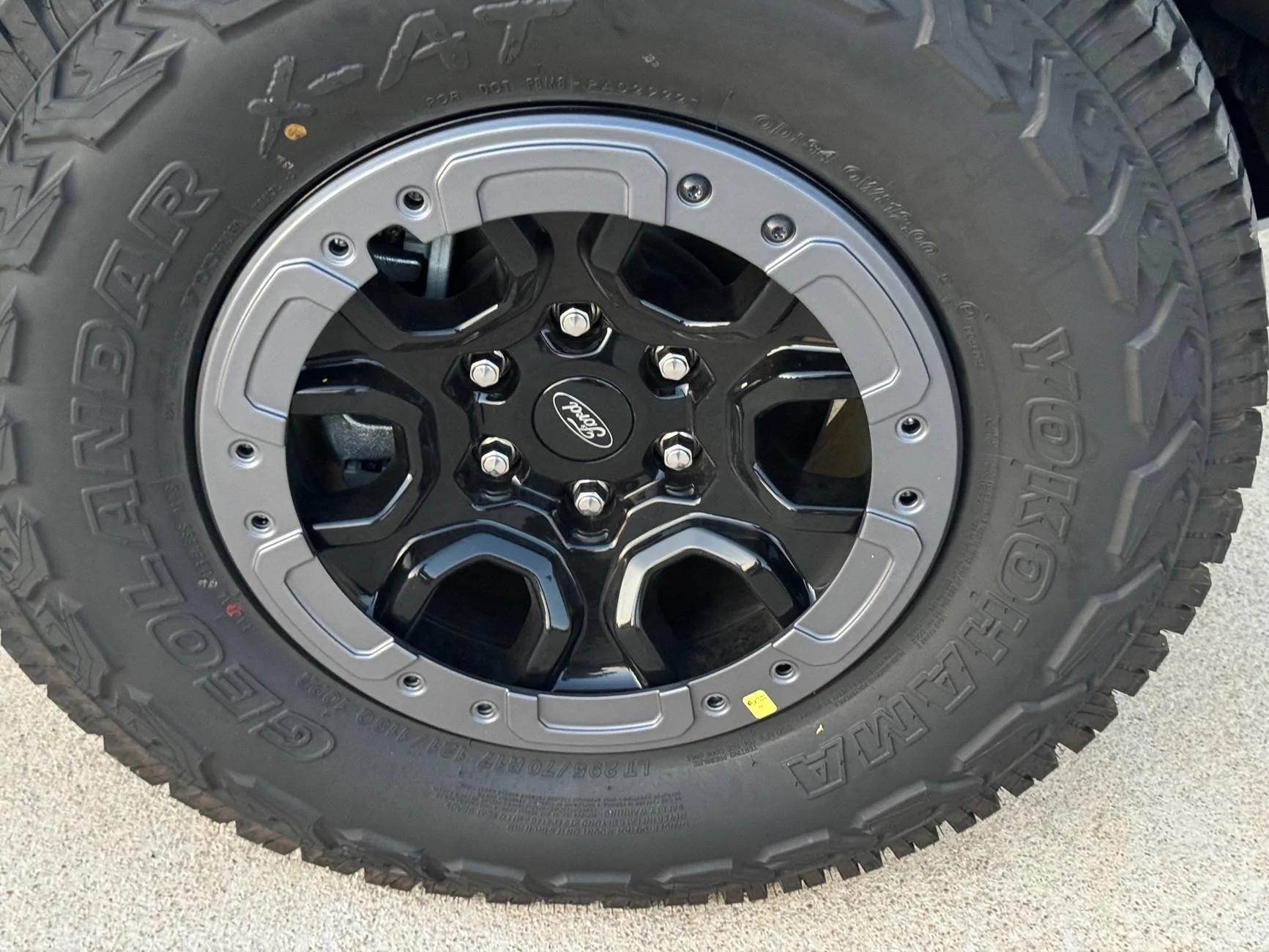

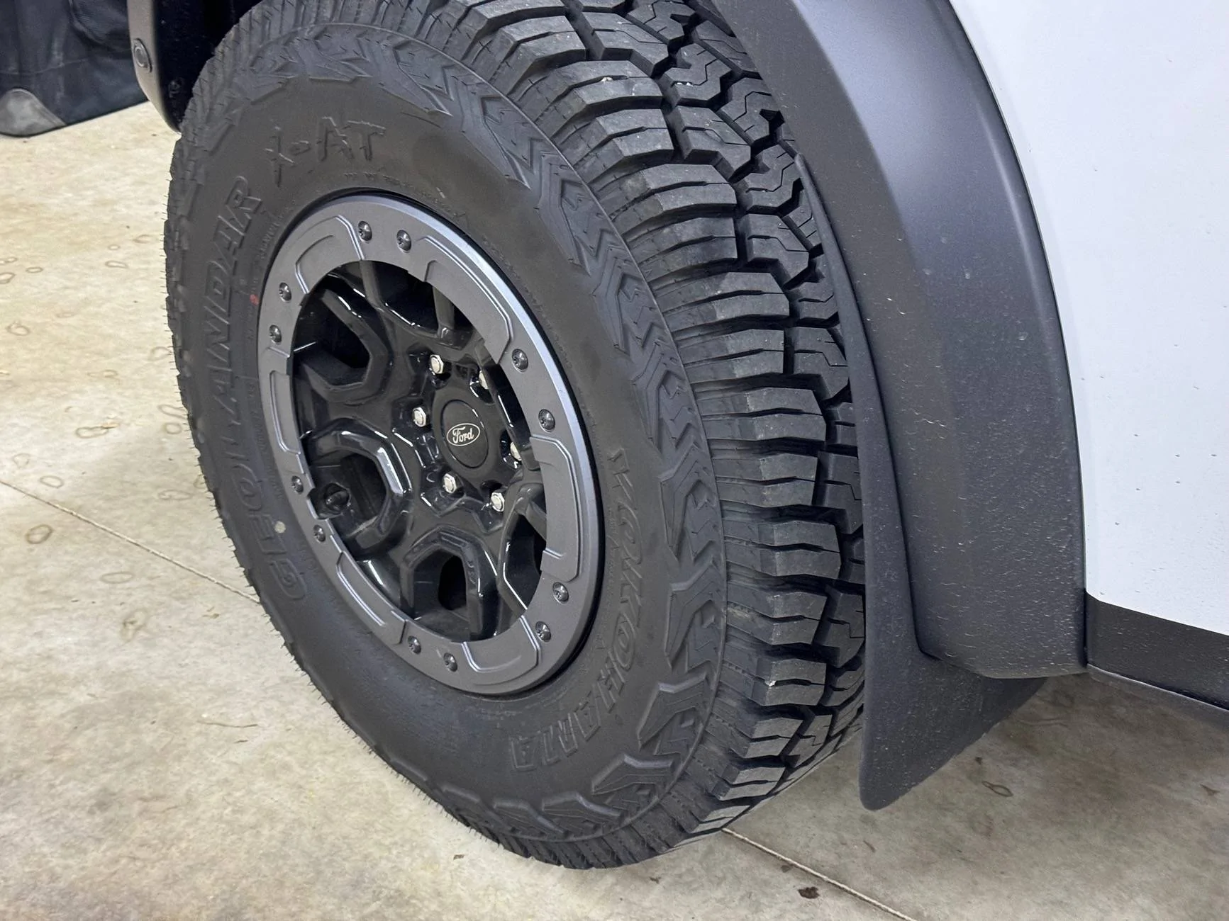

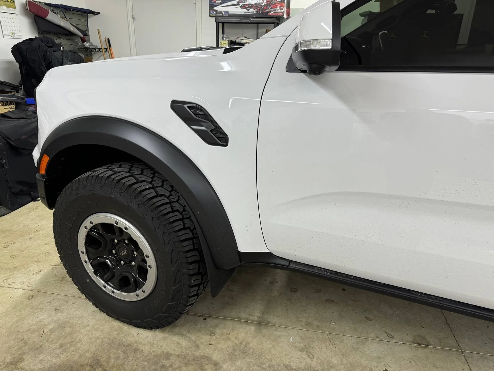

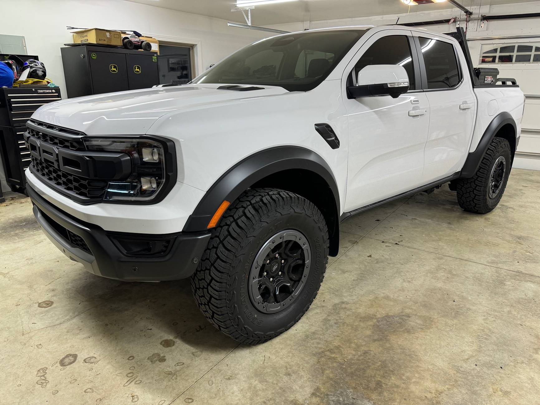

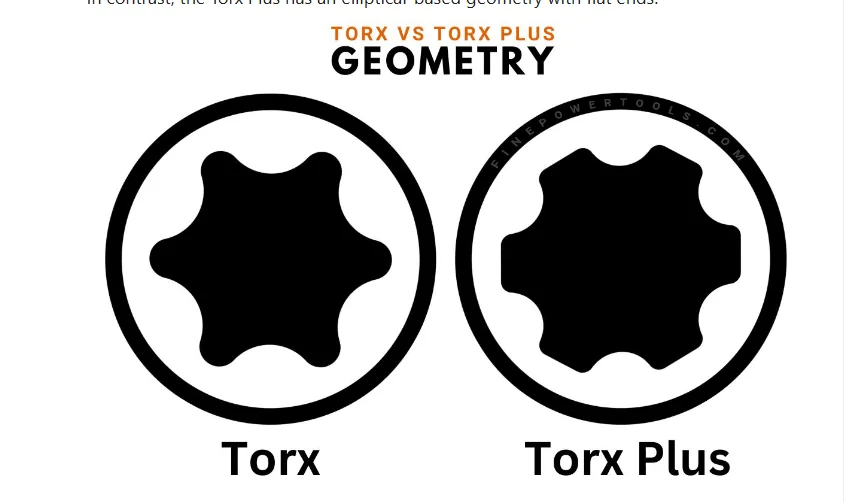

Finally got my rings swapped out with Ranger grey rings.
‘Turns out to get these rings off a T40 torx 40 seems to fit, but just a little sloppy and is a real good way to strip them out. You need a TP40 Torx plus 40. They are slightly different.
Tried to start this project last weekend and stripped a few out trying to use a regular T40.
So got help from members on here via this thread I started the other day.
https://www.ranger6g.com/forum/thre...-simulated-bead-lock-rings.11214/#post-177158
Ford Ranger Have my upgraded Wheels & Tires sorted: 295/70R17 34” tall 12” wide +30 offset 1720757275801-s4
Here it is now with Bronco rims and Ranger Raptor simulated bead lock rings.
Ford Ranger Have my upgraded Wheels & Tires sorted: 295/70R17 34” tall 12” wide +30 offset IMG_8915
Ranger grey ring on Bronco rim.
Ford Ranger Have my upgraded Wheels & Tires sorted: 295/70R17 34” tall 12” wide +30 offset IMG_8916
Bronco bright silver/ machined rings.

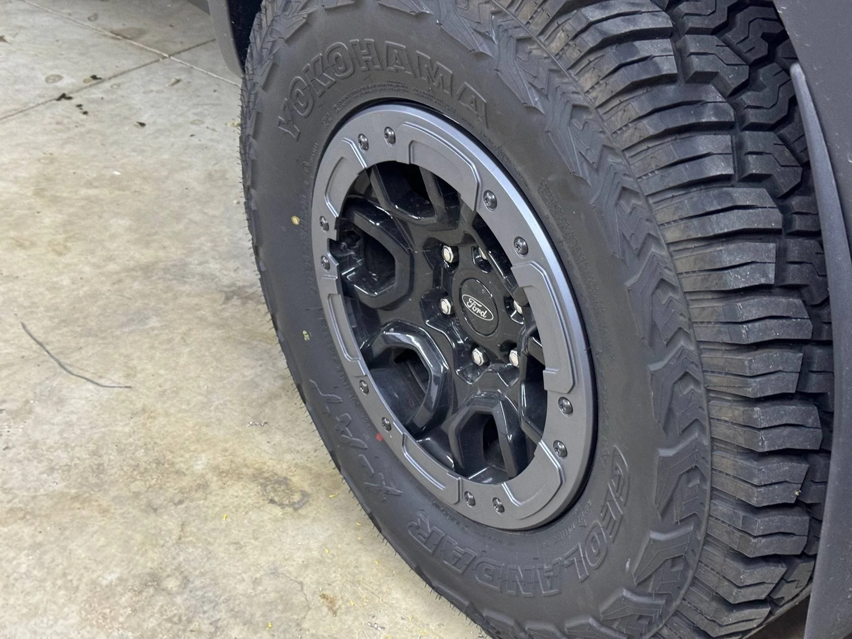

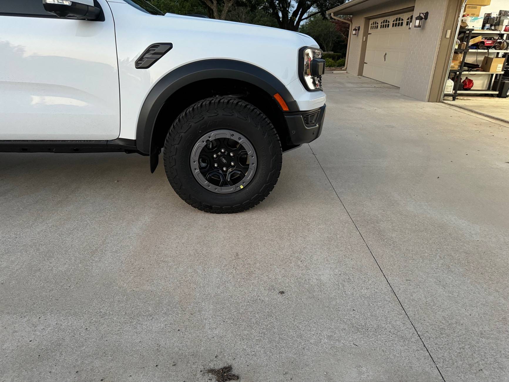

You can see at certain angles the stamped raised portions of the Grey Ranger rings don’t quite line up with the spokes on the Bronco rim, at certain angles they look fine at other angles you can see they don’t quite line up with the Bronco spokes.
Ford Ranger Have my upgraded Wheels & Tires sorted: 295/70R17 34” tall 12” wide +30 offset IMG_8914
Ford Ranger Have my upgraded Wheels & Tires sorted: 295/70R17 34” tall 12” wide +30 offset IMG_8921
I really do like grey better than bright machined rings.
‘I think I am going to take the Bronco rings into my local powder coating shop and have themcolor changed to grey color as close as I can get to the Ranger rings.

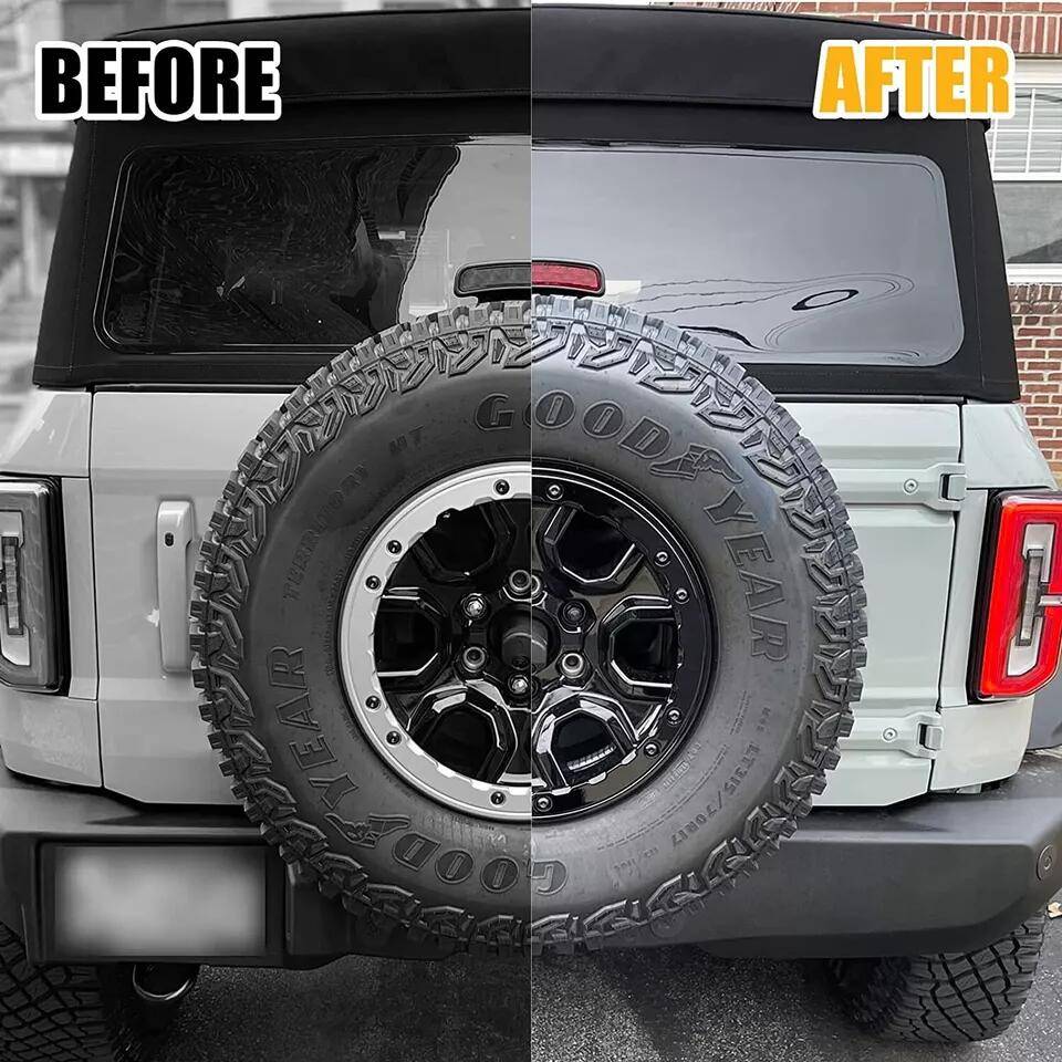

I did buy a set of black rings from this Ebay vender. I am planning to put those black rings on my Bronco.
5P for Ford Bronco 2021-2024 Bead Lock Wheel Trim Rings Kit Sasquatch Package | eBay
So, if you decide to go for Black rings. These are $380 plus tax and free shipping.
This solution might be cheaper than the having your silver rings powder coated if you like the black rings. Which I think the Black color would work with the Bronz. Black goes with about anything.

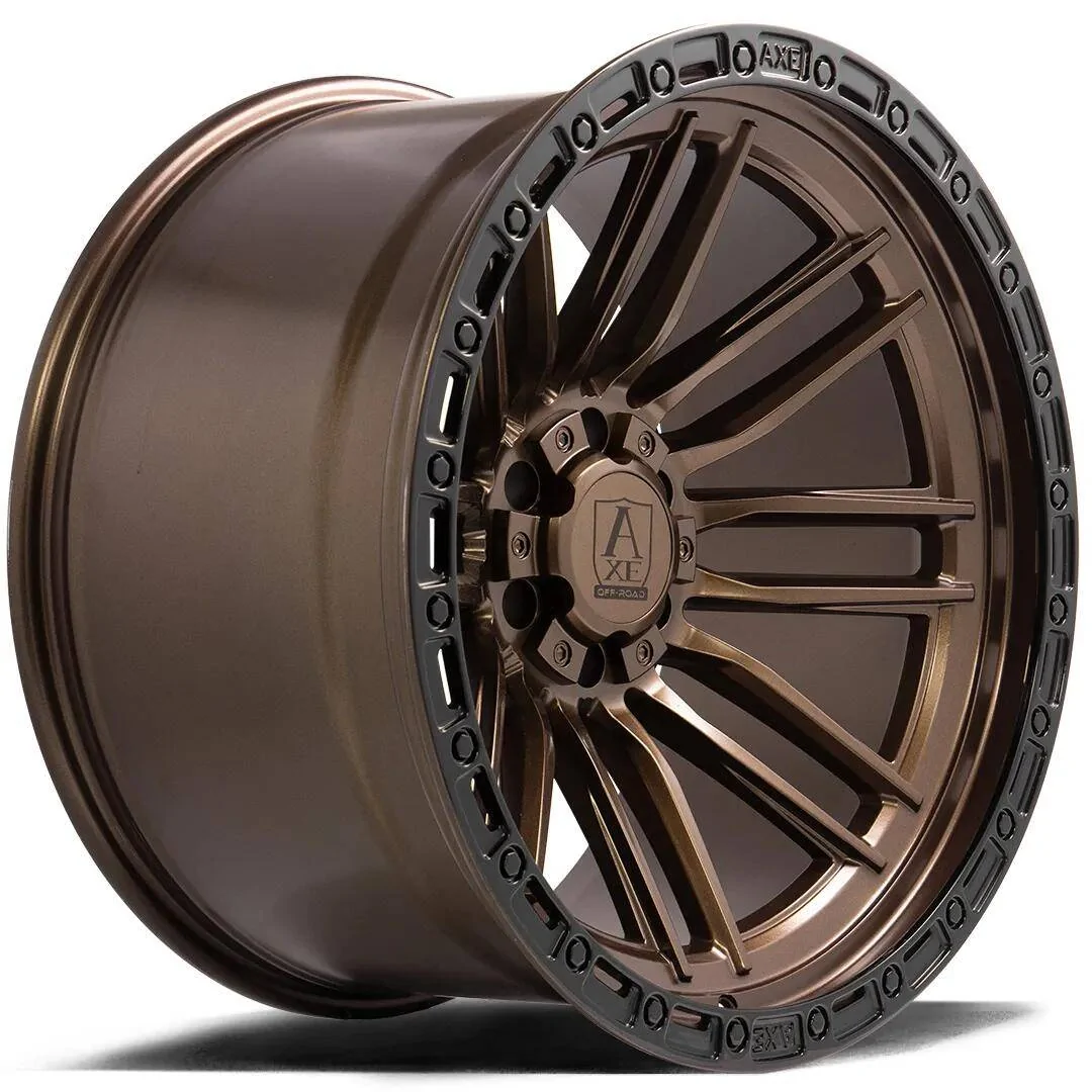

Sounds good.
Not sure why but that color sample looks black on my screen.
It's a dark bronze.
I assume it going to be something like one of these.

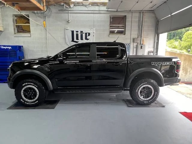

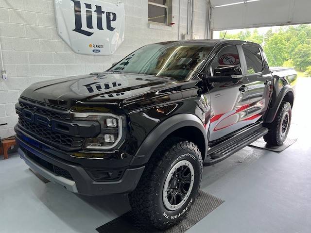

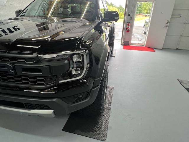

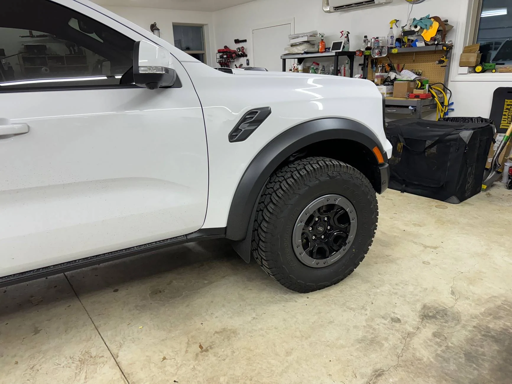

I switched my over to SAS wheels with 295/70 17 as well but I used BFG's KO2 tires... I wasn't for sure about the white letters but now I love it..
