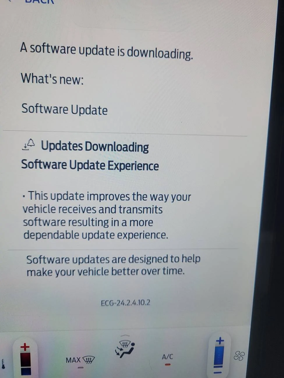

Got my first OTA sync update

Try this:
Sync 4 Sync 4a Updates
  1. Ignition on
  2. Reboot Sync 4(a) (hold on wheel volume down and next song + button till it reboots)
  3. After reboot, wait 1min. When Sync 4 is up: do it again! Same procedure
  4. After reboot, wait 2min.
  5. Go to Setting - General, search for „Feedback“ and send a „Update - Wifi Update“ feedback.
  6. Do this twice! Same procedure again
  7. Go to update page, set the update time actual time plus 3hrs
  8. Go to connectivity tab, disconnect (!) Wifi and let it off (Update will load via cellphone, be sure u have great cell service)
  9. Set the parking brake (important)
  10. Shut the car off
  11. Close the door
  12. Lock the car
  13. Wait till 3hrs + 2 are gone (over night)
If not successful try it again.
