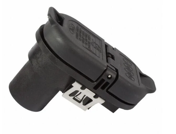

If I understand correctly, the "package" is the receiver hitch and the 7/4 pin connector and nothing else.
I have the tow package so I have those. I also have the backup assist, tow/haul software, and perhaps other things that I can't think of.

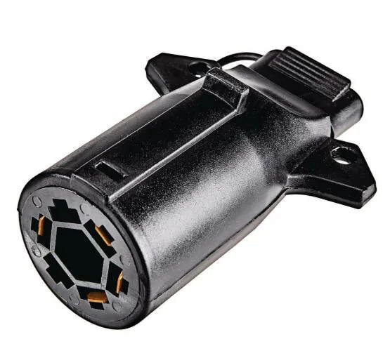

Do you have a 4 pin connector? If so, you can get a 7 pin "converter" that operates everything except the power to charge a trailer battery.
Go to a trailer company. Get them to get your wiring harness (ideal) or adapter (workable but not ideal.) Present the bill to your dealer.
If they don't pay, tell them you're going to sue in small claims court. Follow up in writing, and then follow through. Google that process for your state and county. It's ALWAYS easy. You'll have to pay a filing fee and service fee. The dealer will probably pay you after they get served. Tell them you'll accept the amount of the bill plus your court fees. Then live your life.

I don't understand this at all. Your dealer could easily sublet this to any hitch installation company, they could install a custom wire-in 7pin connector and any number of aftermarket trailer brake controllers in a couple of hours and it would only cost them in the 3-digits of dollars at wholesale. The only things that could prevent this from happening is either you insisting on OEM only parts, or the dealership employees are mouth breathers with absolutely no concept of thinking outside the box which also wouldn't surprise me. I've worked in dealer fixed operations most of my life, and the solution here is absolutely not difficult.

Why not just go to uhaul and have them wire up the plug and a brake controller, if you wish to have the brake controller? They even wireless brake controllers now, whatever that means.

Adding an aftermarket 7 pin can be done, but it will require cutting and splicing wiring, something Ford won't do.
You can get a Class 4 Draw Tite hitch on Amazon for $150.
As for brake controller, there are a few aftermarket options that will work. None of those will work with Auto Emergency Braking.
Eventually, Ford will come up with an 'approved' kit for adding a TBC, just as they did for 5G Ranger, but it might take a year or two.
