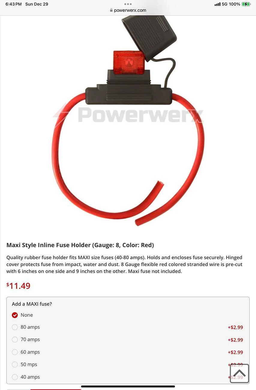

Be aware that your electric motor will have a MUCH higher initial surge current than its rated 17 amps. I personally would want to protect my factory wiring from that excess current, I would install a separate 50 amp relay, and just use one of the other Aux switches to control it. Use heavy short wires from battery to relay to horn, for example 8AWG, with an inline fuse in the positive cable. What does the horn instruction manual say about this? That should be your main guidelines… did it come with a wiring kit?
