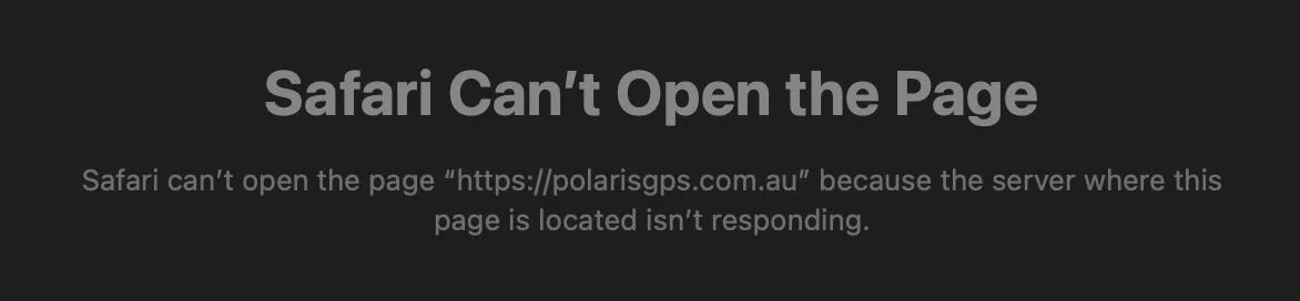

Yeah works ok for me
It's a location block. I turned on my VPN to a AUS server and the website opens just fine.
It doesn't seem to be a plug and play solution. I don't know. Those connectors looks like nothing the ones I've seen on original car wires.

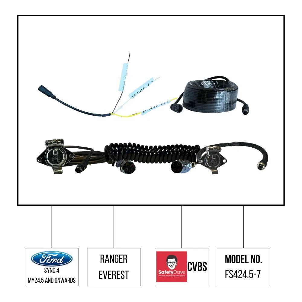

I’ve sent them a query with exactly what I want to do, will report back with response.

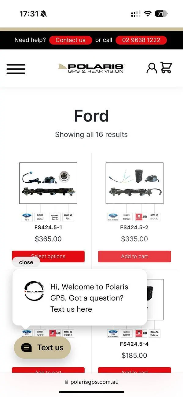

I just noticed that this option is to add a camera to an Everest that already has touring pack, hence why there doesn’t appear to be additional modules etc. I’ll wait and see what their reply is.

Confirmed, the Polaris setup won’t work unless the wiring is already there for an extra camera (via the touring pack installed from factory).
Back to the drawing board… need to find an Australian supplier of the Brazilian product posted by our good friend Renato.
