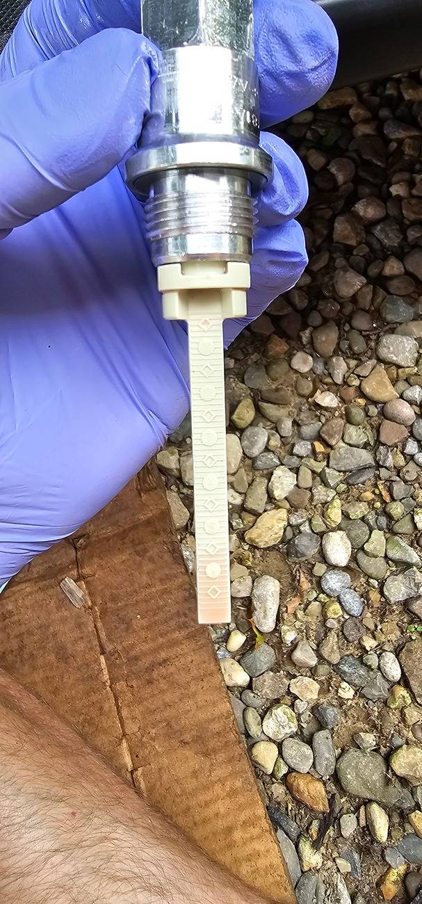

So i just checked the transmission fluid with everything at operating temp and the engine running. Looks to me like it's low on transmission fluid?

Attached is level check procedures. Level between 3 and 4 at temp is good. Yours looks low.
Jeez, and there's no leaks to be seen so this had to leave the factory this way. I'll be sure to get a couple quarts and top it off.
