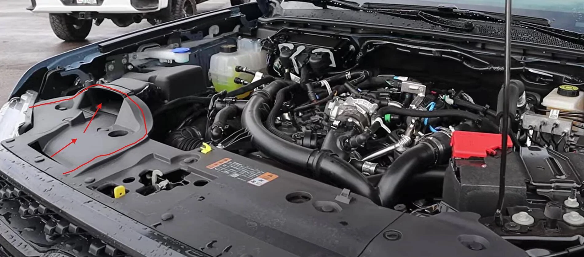

Does anyone have intake air temperature readings to compare a CAI to stock?
The stock air inlets have weather trim(hood side) around the inlet, thus providing some separation of the inlet air from the engine compartment. Seems like the stock intake is close to a CAI without being a ram air intake to me.
I think I recall that the air box uses screws to secure the top and lower half, is that right? Certainly, a slower process to change the filter, if so.
Spend your $$$ on whatever floats your boat. 👍
Ford Ranger 2024 and up Ranger Cold Air Intake. 1739655359349-7w

I agree this system is good, it may not be the best flowing but reasonably cold air extraction. part of the CAI is better flow and better filter with possibly a better box. but that's what we are waiting on is someones final product. PS the CAI do look good to. Like the Ranger setup hopefully ours will be similar.
